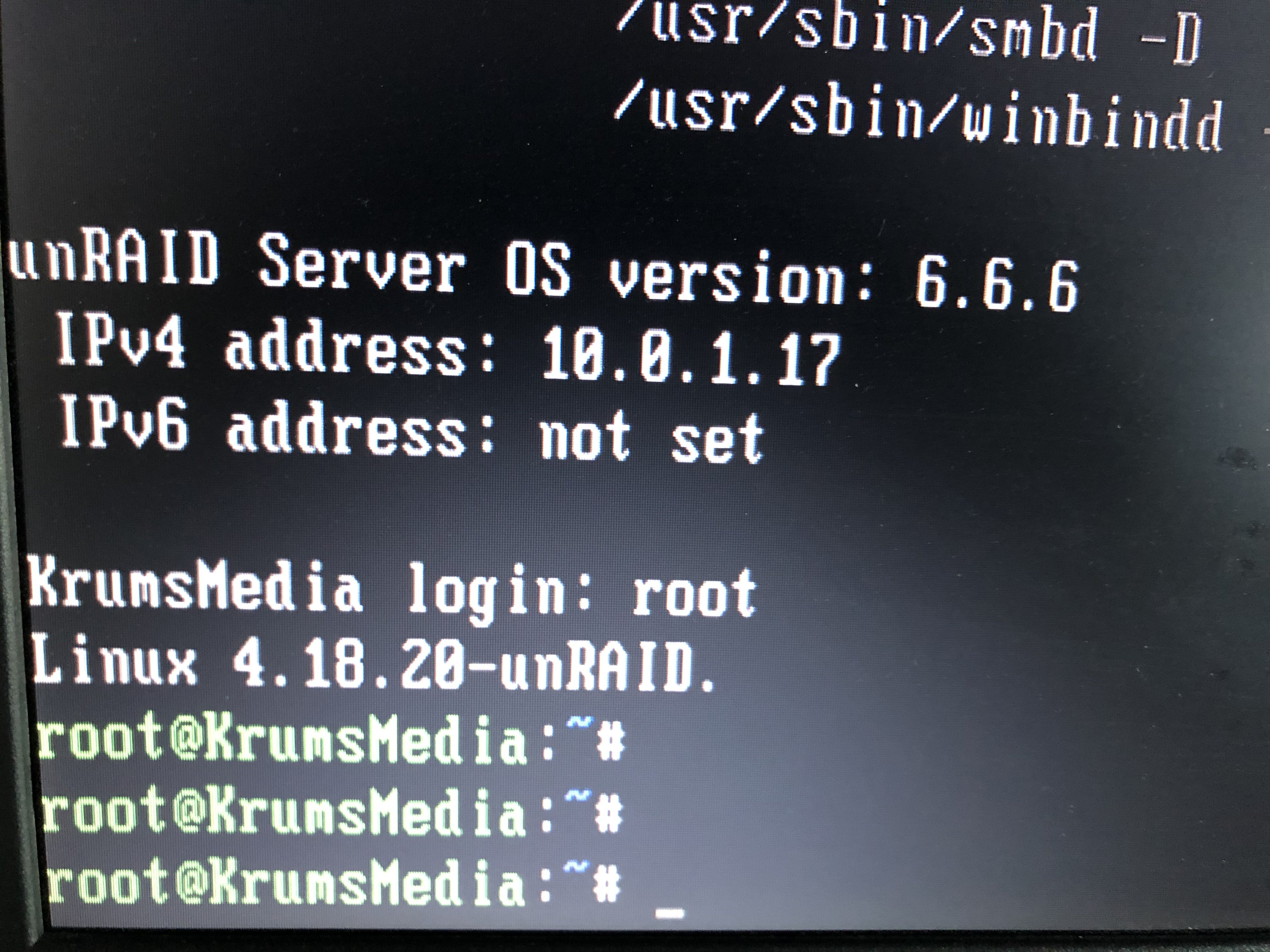

ok, tried to put in "root" as user name.  Then just hit enter when it asked for password.  That didn't work.
Then I followed the direction you provided and deleted "passwd" "shadow" and "smbpasswrd"
Plugged the flash back into the server and booted up.  It again asked me for user name, I typed in "root", then left PW black and clicked enter.  This is what it looks like:
  • Replies 53
  • Views 5.5k
That looks completely normal. But I assume you haven't been managing your server from the command line (nobody does or should). You bring up the Unraid webUI on another browser on your network. As I said

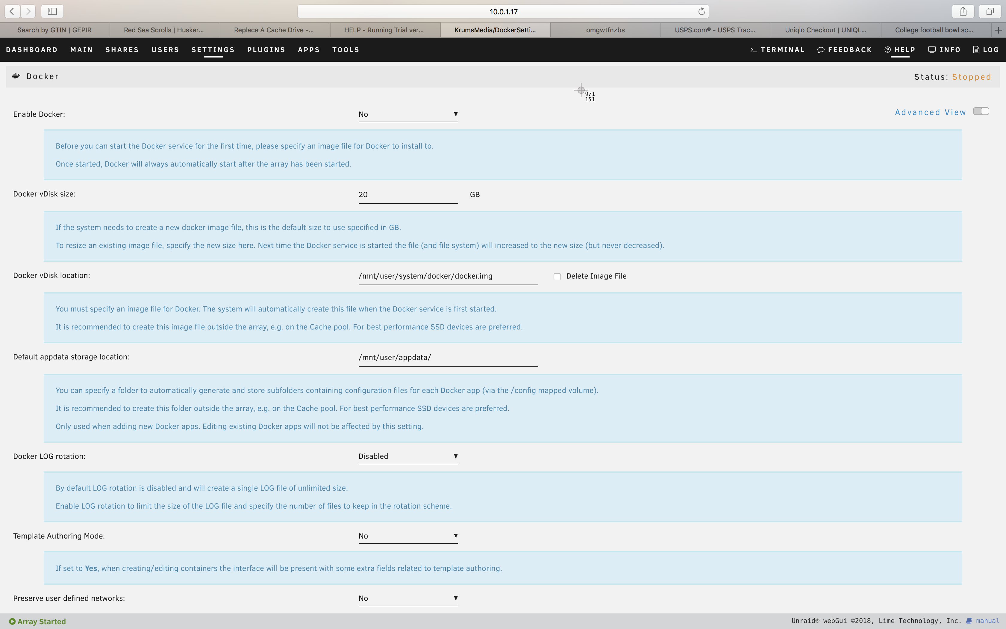

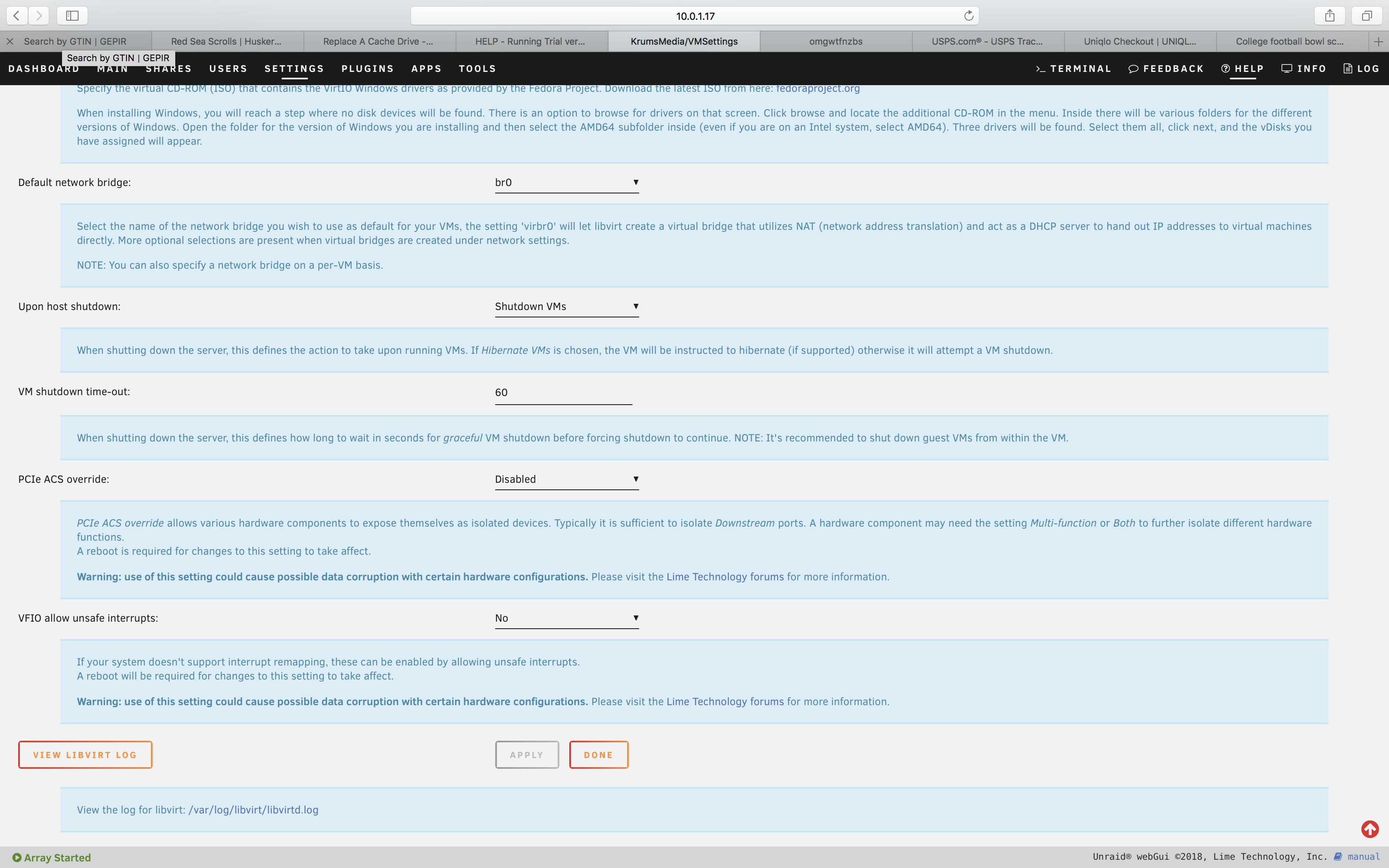

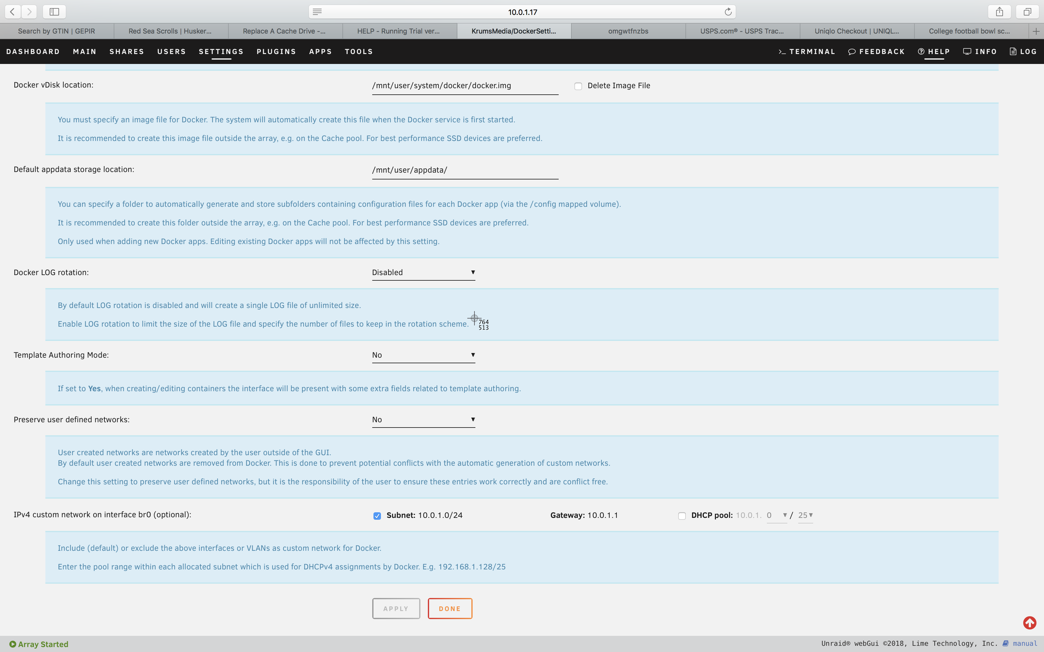

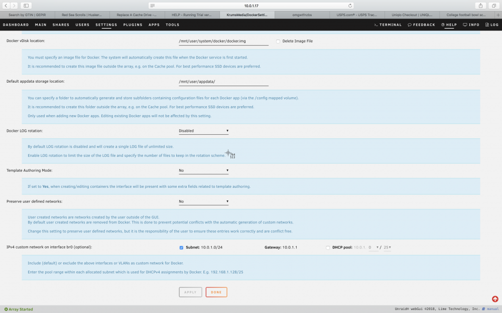

Go to Settings - Docker, move the slider at upper right to Advanced View and post a screenshot.

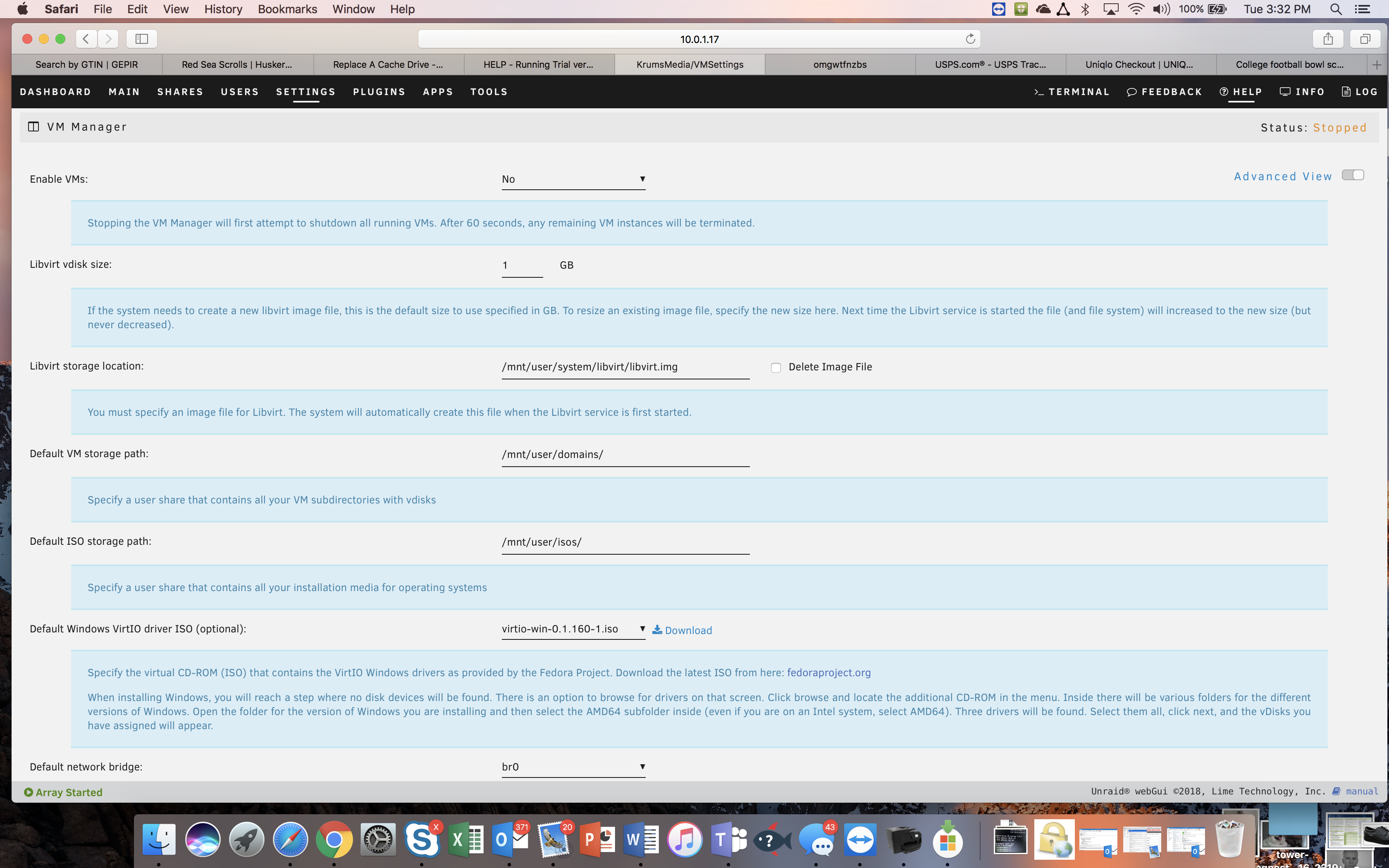

Same for Settings - VM Manager.
Thanks, here you go:
OK well that doesn't really tell us anything since all of the disks are in /mnt/user.

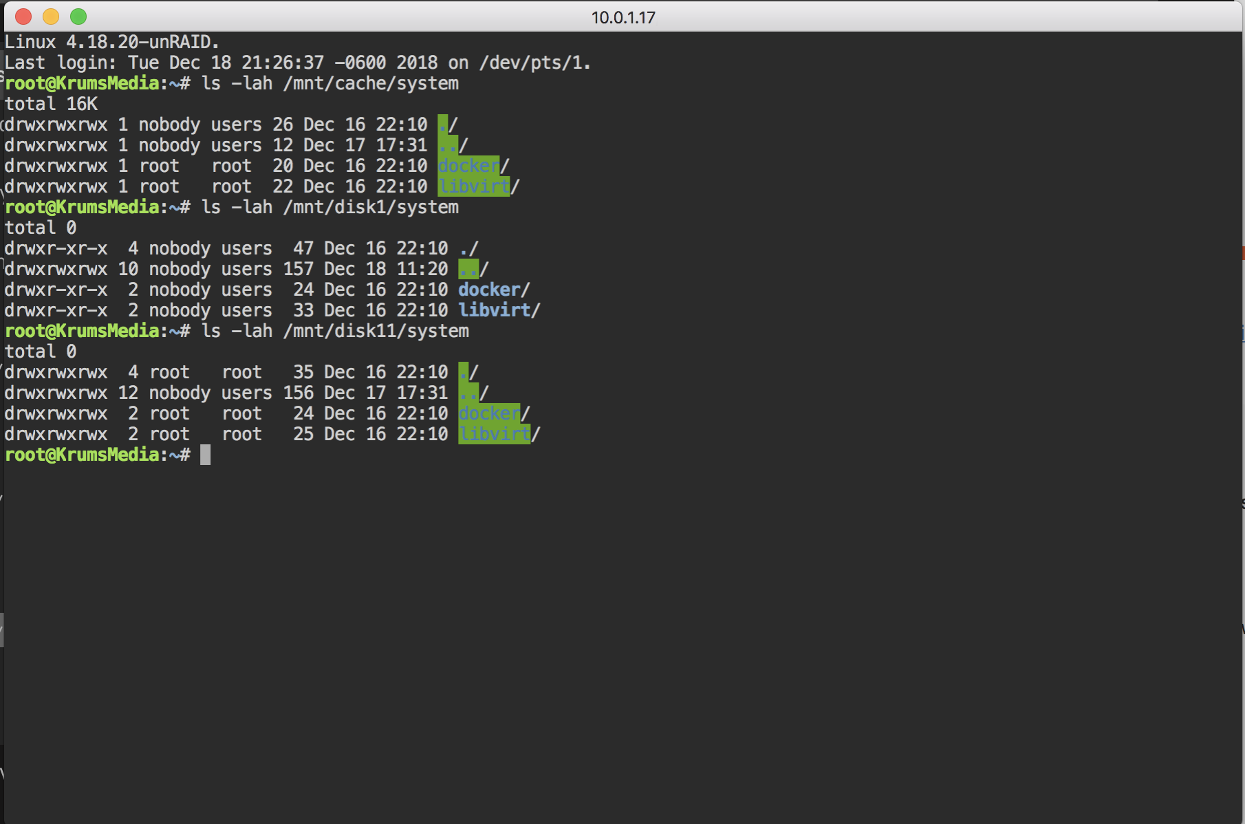

From the command line, what do you get with these?
ls -lah /mnt/cache/system
ls -lah /mnt/disk1/system
ls -lah /mnt/disk11/system
Do you actually run any VMs?
I do not run any VMS.
Do I type each one of those in on the command line directly on the server or where do I do this?  Are you looking for the reaction to me typing these into the command line?
Click on >_TERMINAL at upper right in the webUI to get a window at the command line. That will make it easier to get screenshots of the results. Unless you already know how to copy/paste from a ssh session.
Here you go:
1 hour ago, jonathanm said:
Since the files exist on the cache, and that is what is parsed first for /mnt/user, the other 2 system folders on disk1 and disk11 should be safe to delete.
