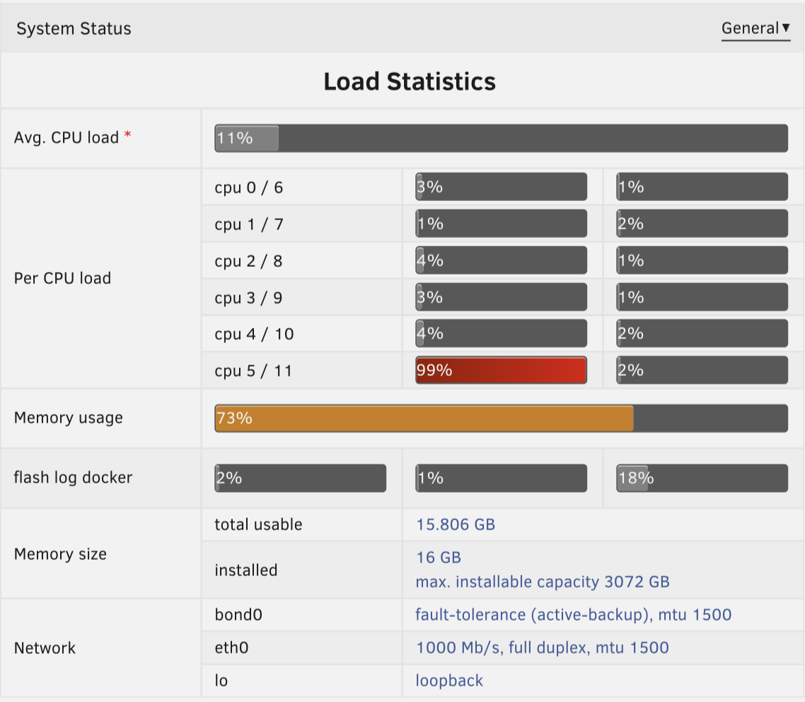

When using the system I notice it will freeze, so I opened my UnRaid console on my phone and I see a single thread with very high useage. I believe this is causing the VM to freeze, and the only thing I can think to do is to just force stop the VM and start it up again.
You can see below the issue, I've noticed this on CPU thread 2 and just a few minutes ago on 5

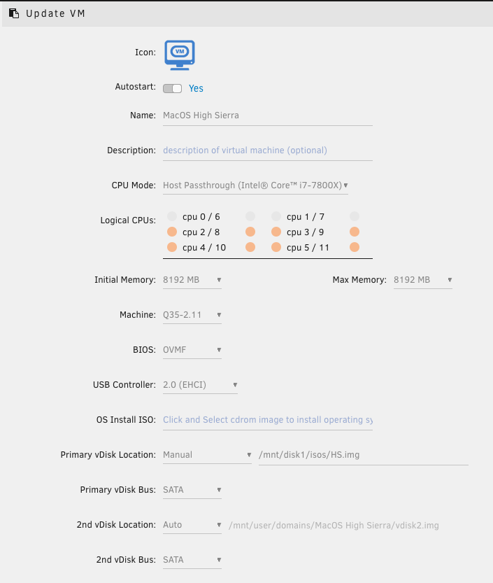

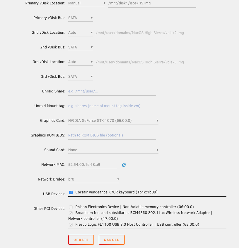

Heres the VM template
1522663770_ScreenShot2018-12-16at10_34_20PM.thumb.png.cb503cc1785627eb41fcd77bded65f0c.png2118534073_ScreenShot2018-12-16at10_34_37PM.thumb.png.3beef416141e8fd15ac41dbd0cce2efb.png
Currently I have CPU threads 0/6, and 1/7 for UnRaid and my Docker containers etc.
