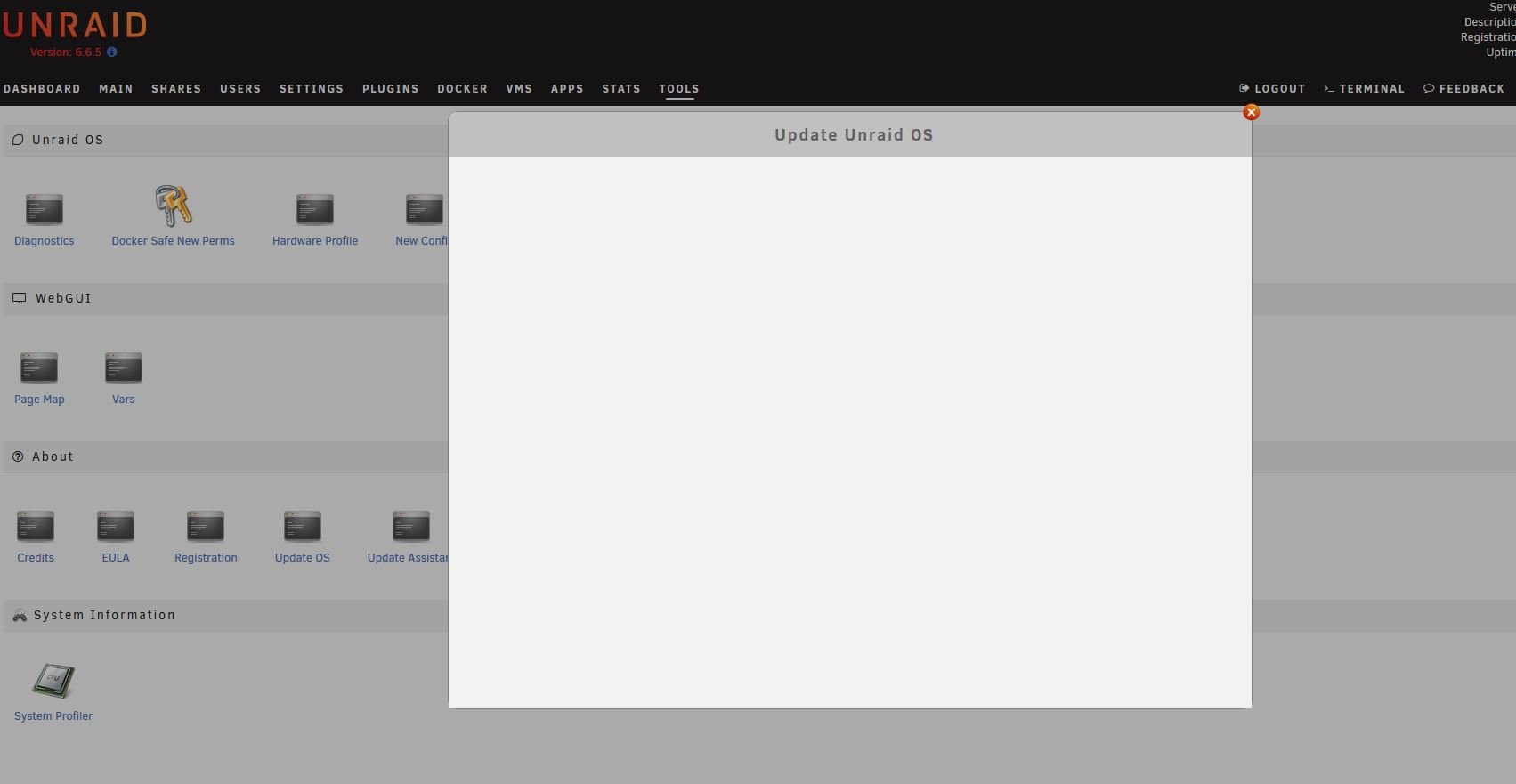

i have the problem that i can't ugrade to Unraid v6.6.6. If i click on Update now the "Donwload" windows opens put keeps blank without changes. (see the attached picture)
Open up the Terminal (In the GUI) and type  ping 8.8.8.8   You should get back ping times from that server.  If not, you most likely have a DNS issue.   You can assign the DNS server addresses on the    Settings  >>>  Network Settings   You can use the 'Help' button to display information on the various settings.

MIght just be a browser problem. If you have any adblockers in your browser whitelist your server.
The system has no problems with ping 8.8.8.8 (the apps download works just fine). I have tried 3 different browsers (two of them stock without any plugins)...

You can do a manual upgrade by simply downloading the latest release and replacing all the bz* files in the top level of flash with those from the download.
The Flashdrive has 32gb so the hardware should not be the problem. I will test the manual upgrade.
