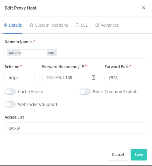

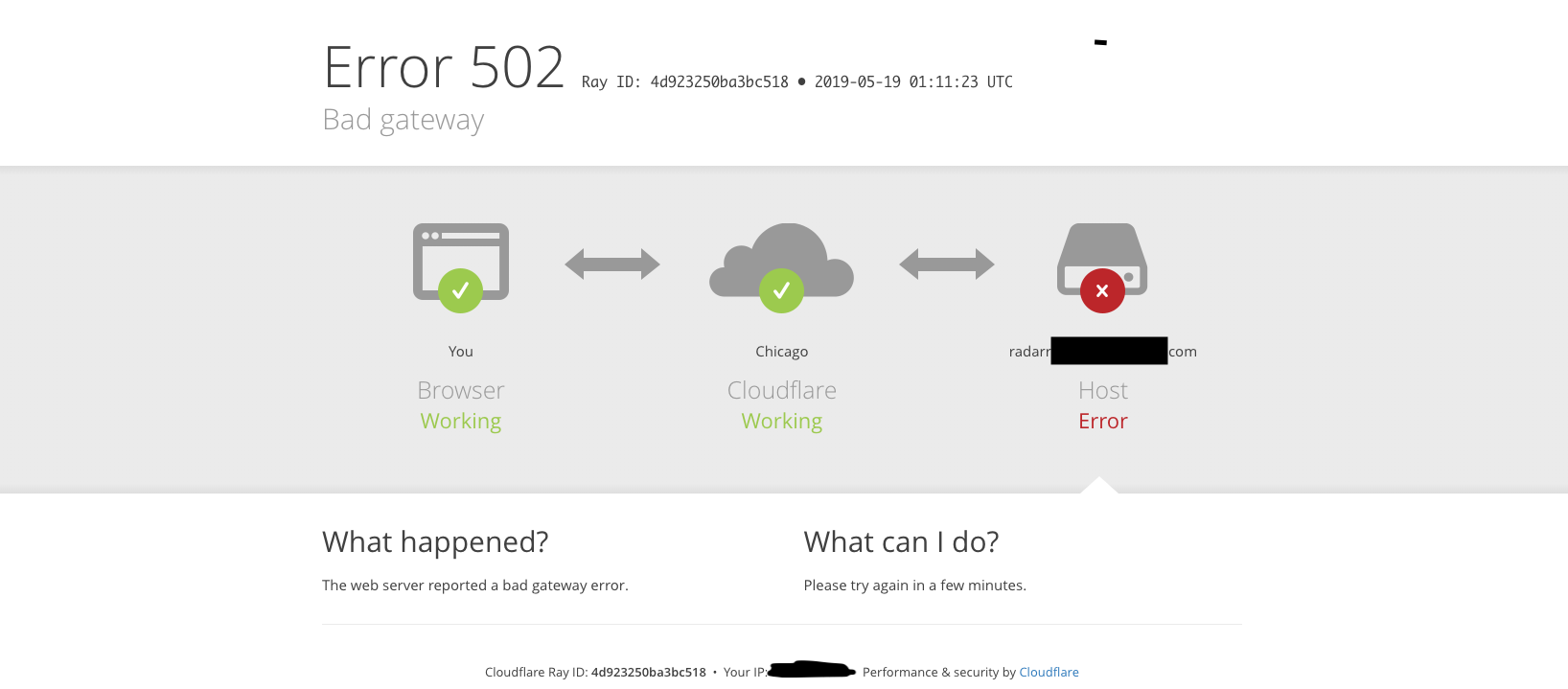

On 3/25/2019 at 5:08 AM, Djoss said:
The scheme you are configuring is for the forwarded host (i.e. how you access your internal service) and is not related to how it is accessed externally.
To better help you, please provide a screenshot of your proxy host configuration and a screenshot of the browser's error.
First off sorry for the really late reply, hope someone can still help.
This setup will not work. I get The following error
1595639049_ScreenShot2019-05-18at8_11_36PM.thumb.png.873589efb09ab53933332401a9495c63.png
But if I change the Scheme to HTTP: I can externally access it, but if I go to the nav bar and directly add the `s` to the URL, it still works.
