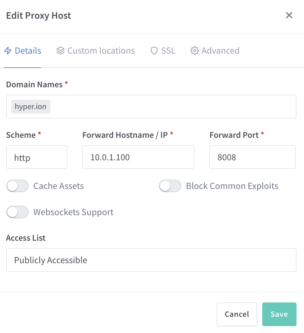

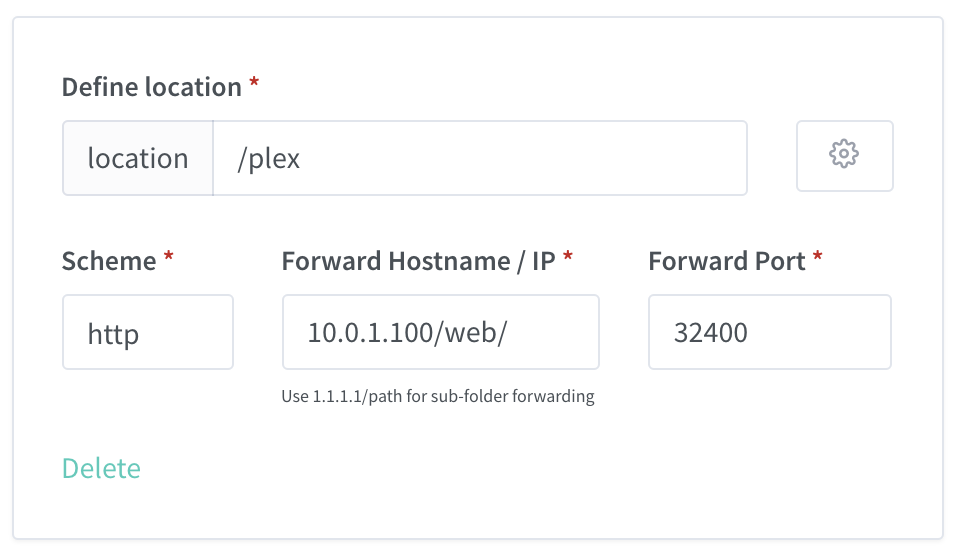

Has anyone been able to get this to work with Plex?  I've gotten Grafana and a bunch of others working, but Plex just redirects back to my main Unraid page.  I just use an invalid TLD locally without SSL.  With a local DNS server as well, this traffic never goes outside my network.
Unraid is on 8008, and Plex is on its usual 32400.
You don't need to use a custom location.  Just set the forwarding IP to 10.0.1.100, the port to 32400 and make sure web socket support is enabled.
Hmm.  That does work, but only if I don't need access to Unraid itself.  That makes Plex work, but it then breaks Unraid's Main even if I then set up a custom location for that.  There's many inter-dependancies.  This is tricky.
Edited by Gizmotoy
Ah I didn't realized that you had this type of setup.  The easiest way is to use a DNS name for each service.  But, if you want to put Plex under a subfolder, try (with the initial config you shared) ) to set the forward ip to "10.0.1.100/" (ending slash is important).
