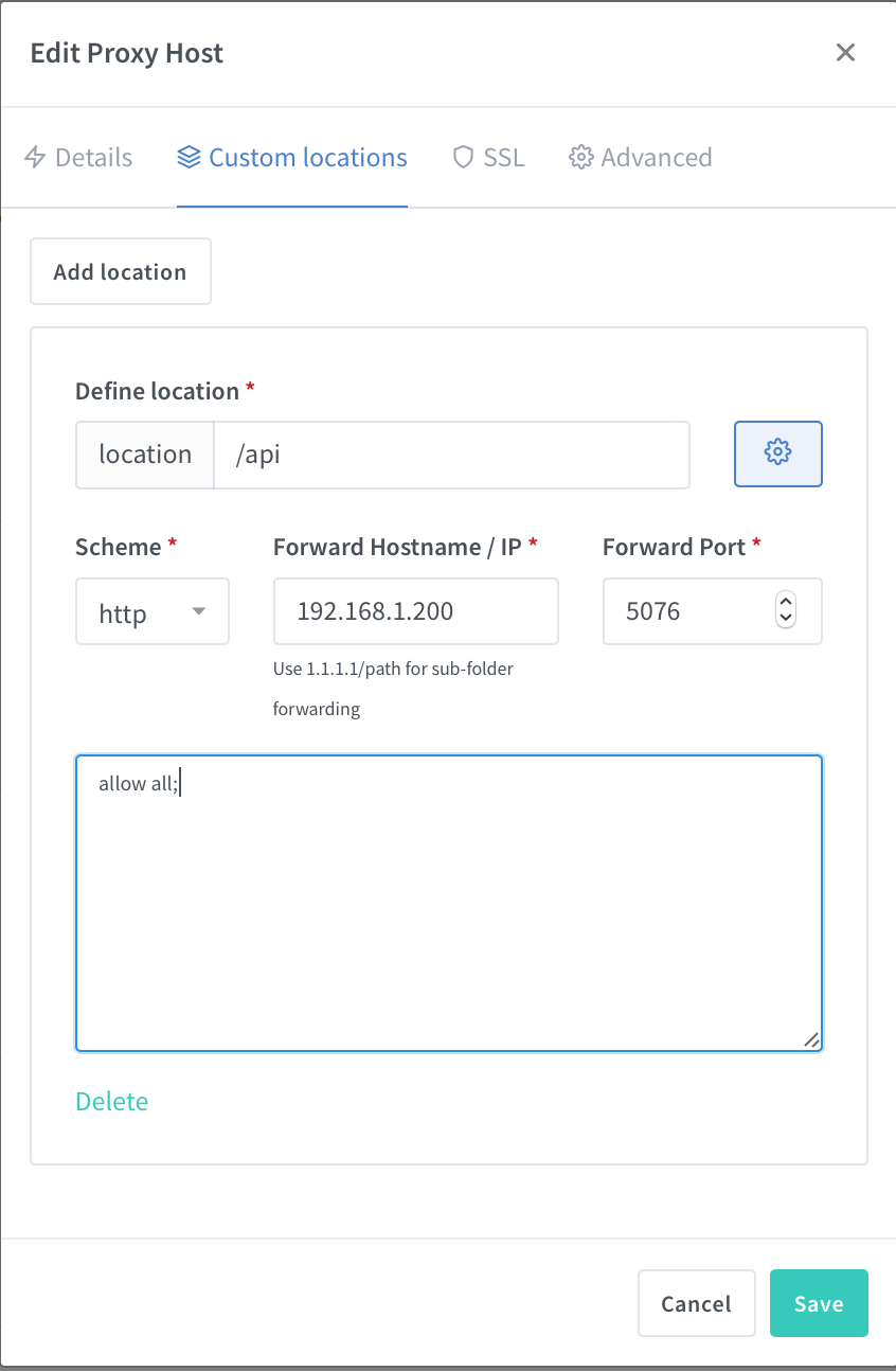

Djoss Posted February 16, 2020 Author Share Posted February 16, 2020 On 2/8/2020 at 2:12 PM, Nuke said: How to exclude some folders for authorization? I think you should be able to use "auth_basic off;" for the location you want to exclude. 1 Quote Link to comment

MowMdown Posted February 23, 2020 Share Posted February 23, 2020 On 2/8/2020 at 2:12 PM, Nuke said: How to exclude some folders for authorization? See screenshot. Quote Link to comment
