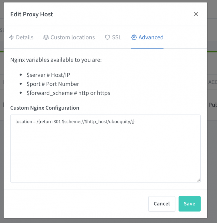

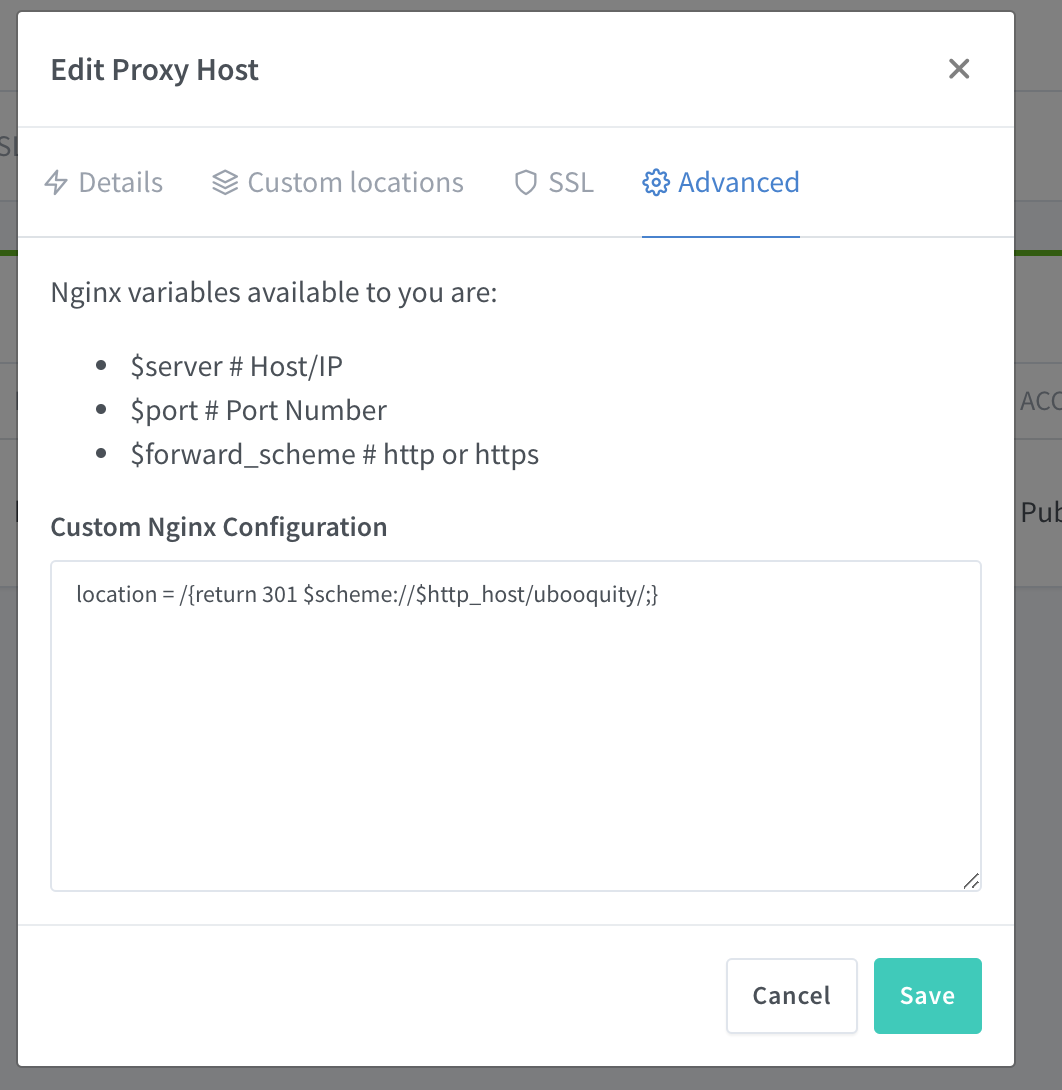

thanks for you help really apreciated, i add location = /{return 301 $scheme://$http_host/ubooquity/;} to advanced but dont work, i still get same red reports
just to make sure here is where i add it
Adding location = /{return 301 $scheme://$http_host/ubooquity/;} is only if you reverse proxy ubooquity.  This has nothing to do with security report results.
