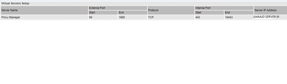

So ive had this working for some time now, but the other day i noticed that me port forward setting dissapeared from my router.
I have set them up again, but cant get any of my subdomains to forward to where they should go.
If i use https://domain name i get site cant be reached error,
and if i use http://subdomain i reach my router webui (which i have not entered its IP anywhere
NPM is set to bridge, with all setting leftas default
This is my router port forward settings:
And this is the proxy settings:
Is there someting else im forgetting?
Cheers
That looks completely wrong to me.

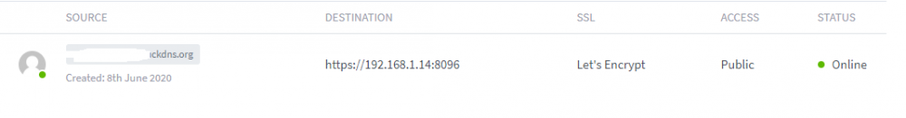

Cheers
Your should setup only 2 ports in your router, instead the 80-1800 range.
So you should have 2 entries:
  1. External start/end set to 80, internal start/end to 1880.
  2. External start/end set to 443, internal start/end to 18443

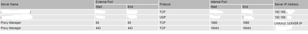

Like so?
If yes, i get a 502 - Bad gateway error, when accessing domain name
EDIT - In NPM, i had my Proxy Host set as HTTPS, changed to HTTP and all works now..
Thanks

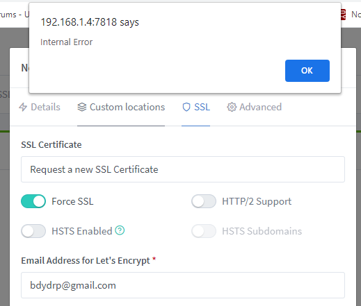

what would cause this error when setting up a new proxy host and getting an SSL certificate?
Think i worked it out.
Logged into duckdns account and noticed it had not updated my IP. Once i manually updated mg IP, everything worked again
That's make sense: the Internal Error is usually due to the Letsencrypt service not being table to reach your container.
