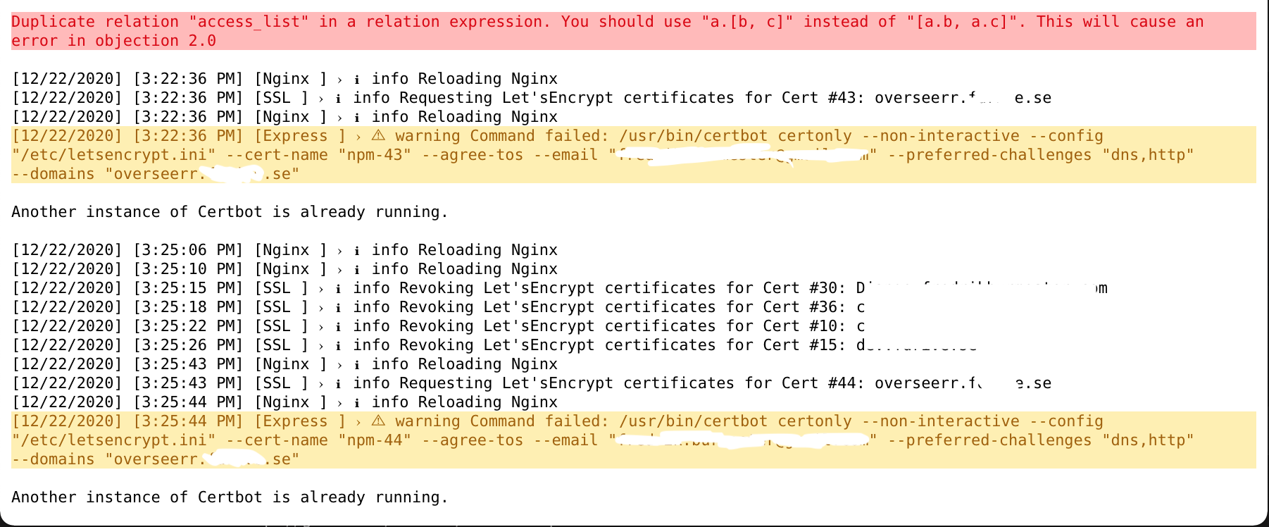

When i try to add an SSL cert i get this error:
984729208_Screenshot2020-12-22at15_26_04.thumb.png.21e4a01f82c0ad9c5d7bb6fc5a4b85dc.png
Can you help me?
Can you help me?
I am getting the same error as of today when trying to add certs. Anyone else also getting this issue?
EDIT: I let the container sit for 15 minutes or so and tried again and it worked... lol
