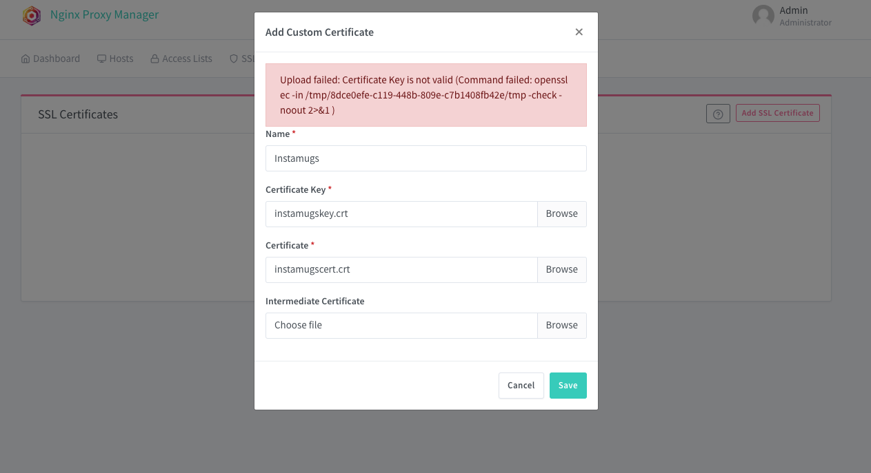

On 11/8/2020 at 10:42 PM, [email protected] said:
Hi all, I have two issues.
1. Unable to get the Letsencrypt SSL cert. it says "Internal Error" always
2. I got a certificate and private key from my cloudflare tool and saved them as .pem files and now while uploading them i am getting this error. (also attaching a screenshot)
Upload failed: Certificate Key is not valid (Command failed: openssl ec -in /tmp/8dce0efe-c119-448b-809e-c7b1408fb42e/tmp -check -noout 2>&1 )
1120496865_ScreenShot2020-11-09at10_38_39AM.thumb.png.67149915802b07cd8b08974bc31f5b22.png
Kindly help. thanks.
You need to change "-----BEGIN PRIVATE KEY-----" to "-----BEGIN RSA PRIVATE KEY-----" in your key crt file to get this to work.  No idea when the requirement changed, but this fixed the issue for me last night.

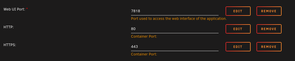

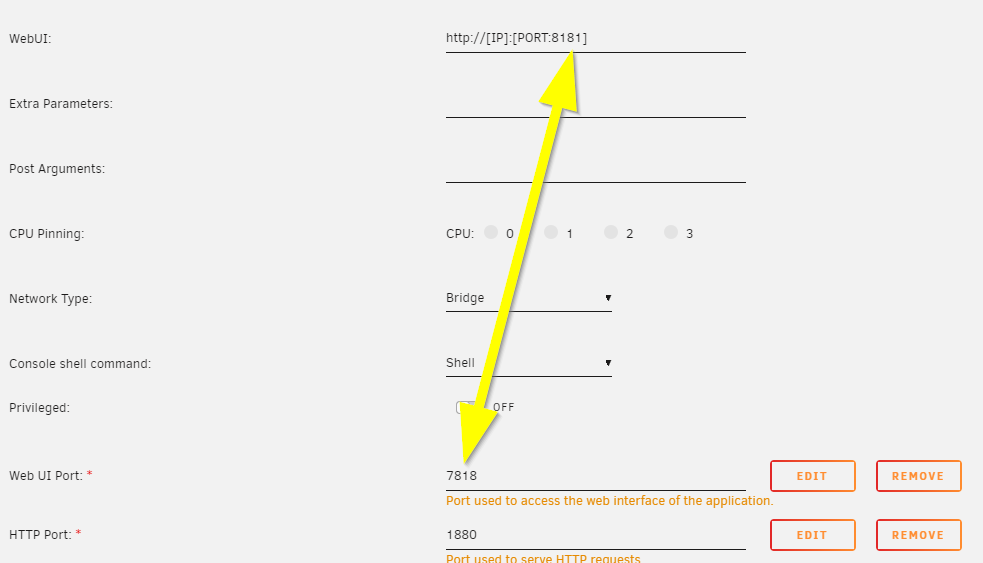

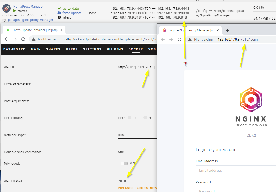

@Djoss
Small bug:
And the container does not map the port which is set through Web UI Port:

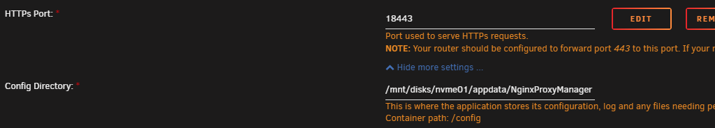

On 1/17/2021 at 4:49 PM, mgutt said:
@Djoss
Small bug:
Must admit i thought this was just me - I can't change the HTTP and HTTPS ports on mine, they are different inside the edit view than they are reflecting on the docker view.
Will keep an eye out to see if a fix appears as i am trying to only serve internally and need the ports to be standard 80/443 since i am updating the DNS records on PI hole to point at the Docker Fixed IP as an experiment.
