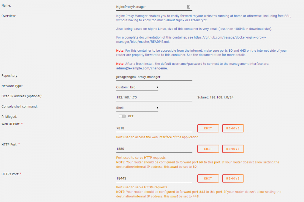

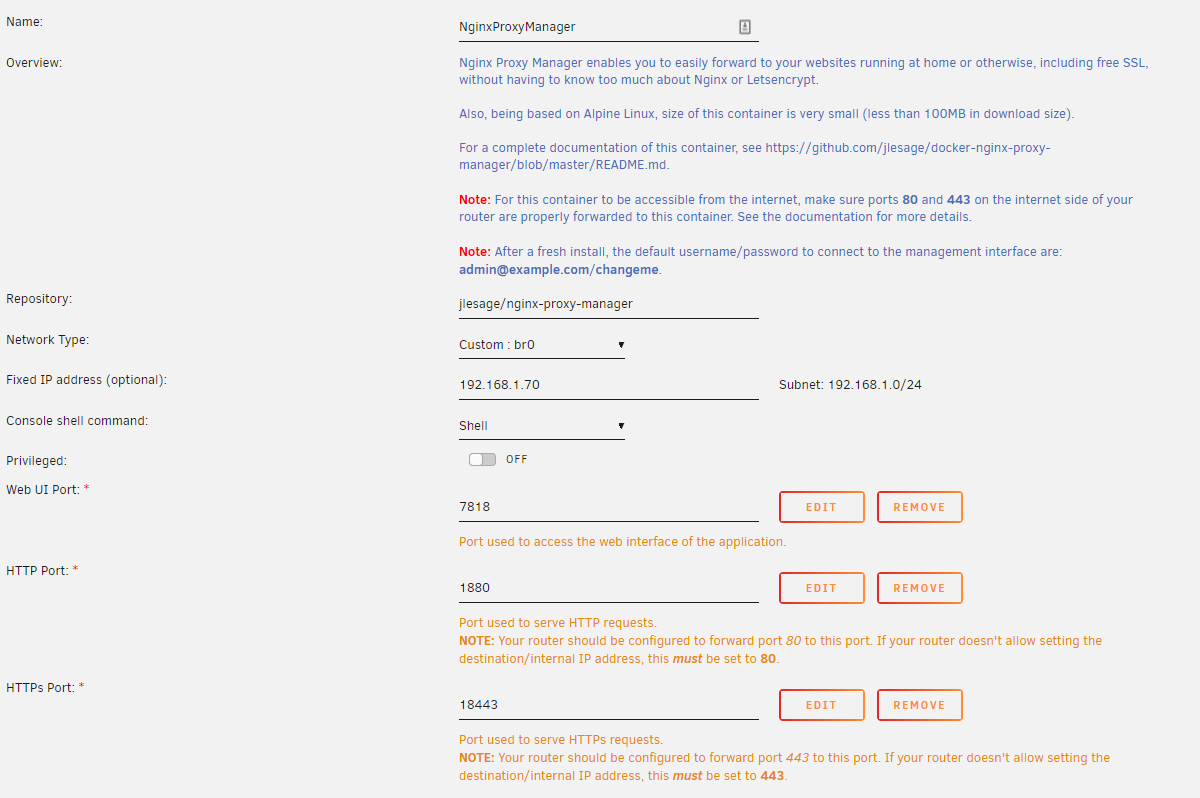

I set this docker up today and was pulling my hair out about why I couldn't get my apps set up correctly...the docker was complaining that the challenges were failing.  I tried all kinds of things but noticed that while the docker settings showed ports 1880 and 18443 for the internal ports, the docker allocations section showed 8080 and 4443 instead.  I changed my port forwards to those ports and BOOM, worked first try.
Is this expected?  Here are my docker settings, but 1880 and 18443 don't work for me:

This is not a bug. br0 simply does not use port mapping. Port mapping is for the bridge network.
I ran into the ports issue as well yesterday, I only noticed that 8080 and 4443 were the ports being used when I looked at the port mappings in the docker containers list.
I looked at the dockerfile with this app, and the ports are hard coded to 8080 and 4443.  I wish the developer had left them at 80 and 443 so I could use this for both external mapping via my firewall/router and internally on my LAN.
Would it not make more sense to leave the ports as the default ones inside the docker and use -p to map them when you want to use a host instead of a bridge network?
I don't want to discount the amount of effort that Djoss has out into this and I may just be running on at the mouth/keyboard. So I'll teach myself how to setup an Unraid docker app today and see if I can figure it out why.

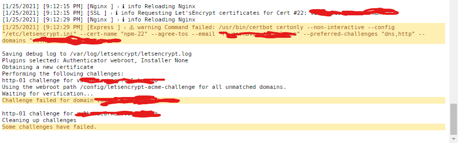

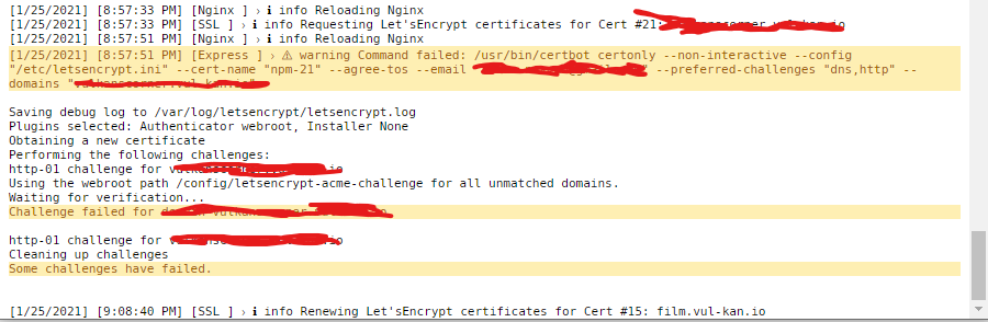

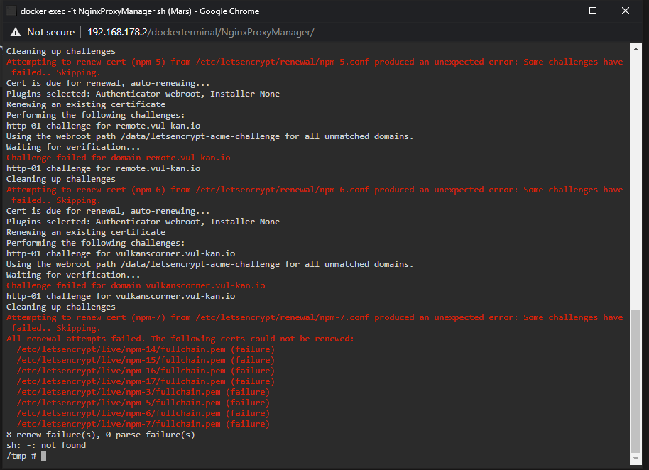

I can confirm I'm having the same issue as above. I tried the dry-run command, which produced the following logs:
I then tried test cert as well, which gave me this:
in the same log you can see I'm able to ping google, so it can get to the internet.
as an addendum to this, this is what I get when trying to renew:
and this is what I get when trying to create:

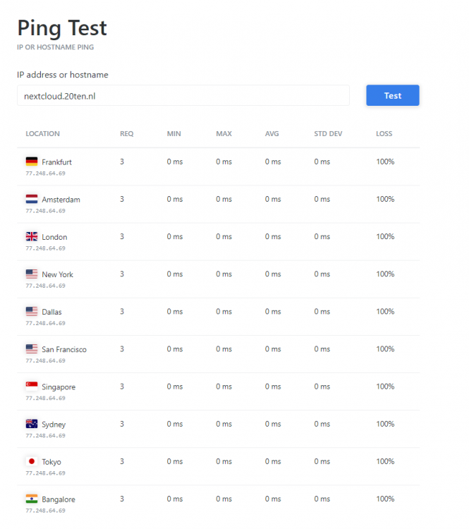

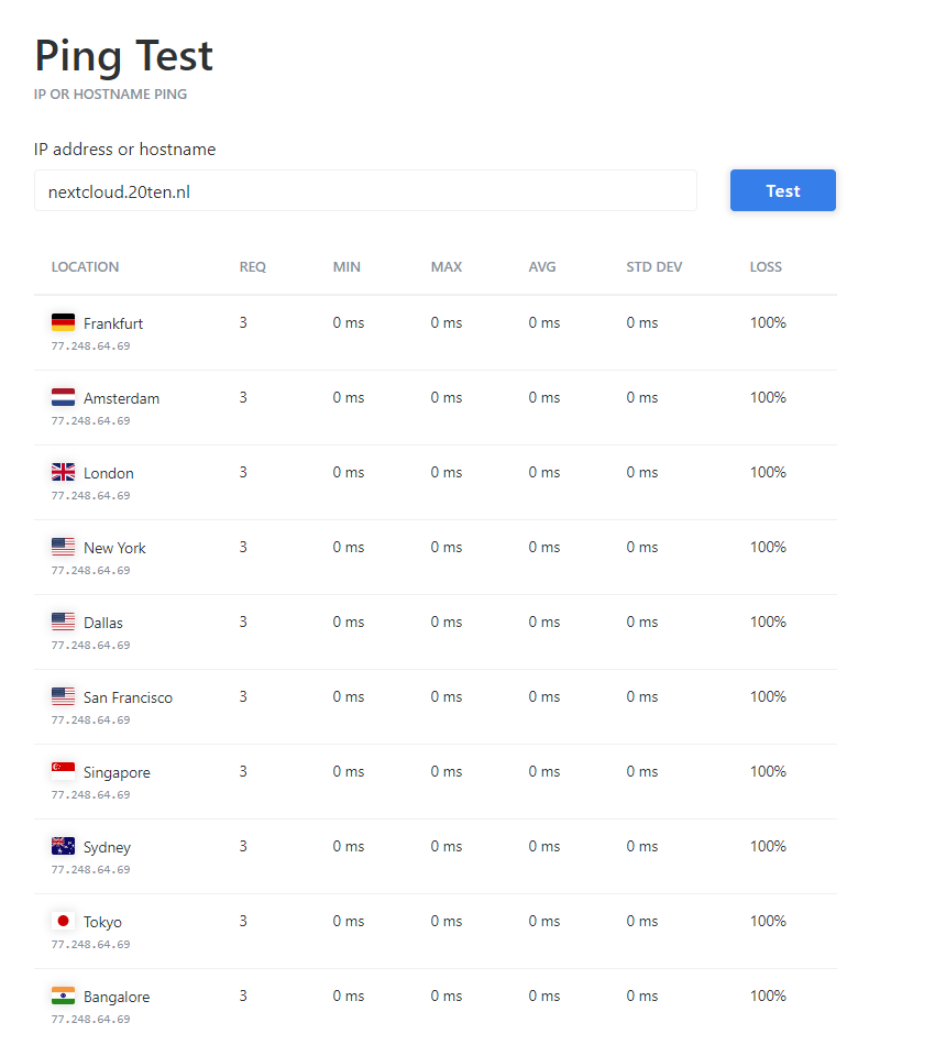

Dou you have an ACL configured? I cannot access nextcloud[dot]20ten[dot]nl from here. Or perhaps your external IP changed? Can you access your sites/services through 4G for example?
(Here it resolves to 77.248.64.xx and I cannot ping that IP (timeout)) so it seems that indeed letsencrypt cannot access your NPM to verify it is correct.
External ip is correct (77.248.64.xx) but i can't also ping to it... DNS A records are also correct and pointing to this ip. Nothing has changed as far as i can see. I will contact my hosting provider to see if there is something wrong there. Wouldnt be the first time.

But they can't ping the external ip as well. Ip is a cable modem from a local ISP.
For the rest everything is working fine here on my side of the modem... bit lost here on what is going on?
In case you have not done it before: perhaps reboot your modem? And if you have your own router also reboot that one. Or log in into your router to confirm the portforwarding / firewall settings are still correct. Perhaps Ziggo pushed an update and some settings got reset.
edit:
And just to confirm, I cannot ping your IP from home (t-mobiel) or from my VPSses (in NL, DE and USA)
Edited by mattie112
The ziggo modem is in bridge mode; so shouldn't have any port forwarding / firewall etc.
I'm using pfsense as router, there is port fwding configured (1443/180 to https/http 443/80 internally on unraid for nginx proxymngr)
Will reboot the modem anyway.
Edited by jowi
You can confirm if it is indeed still in bridge mode. And just to confirm if I ping my parents (also Ziggo) I go get a ping reply (non-bridged modem).
If you continue to have issues I think you should start a new topic as this issue is not related to NPM (feel free to tag me there).
But to be clear, if you ping nextcloud.20ten.nl , you get a timeout as well?
Confirmed, from within NL, Germany and the USA all timeout
Weird, everything pings fine from here, also, all domains are working fine over 4G on my phone... nextcloud works, i’ve got a wordpress site that runs etc. all is good as far as i cab tell? I dont get it.
Edited by jowi
There really is a connectivity issue on your (providers) end. From my 4G (tele2) I cannot ping. So either something is wrong with your router/firewall or your provider has some issues. Also see tools like the one below but this is simply not a NPM issue letsencrypt can simply not reach your server.
https://tools.keycdn.com/ping
Oh and perhaps your mobile provider is in the same network (or is the same provider) as your internet connection perhaps they "simply" have some routing issues.
edit:
@jowi it seems to be working now! I do get your nextcloud login page (but I still cannot ping so guessing that is blocked?)
Edited by mattie112
yeah i tried some more renewing and recreating certificates, and all of a sudden it worked. Well, for me it always worked, but i now have new certificates... still don’t understand why the ping doesnt work, but for me everything is fine... 👍
Edited by jowi
