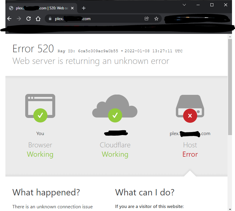

TWO INTANCES OF NGINXPROXYMANAGER RUNNING AT THE SAME TIME?
I've been using Nginx Proxy Manager for a while, and it's worked great!
Yesterday, however, I was trying to access Plex and I was presented the Cloudflare 520 Error: "unknown connection issue between Cloudflare and the origin web server."
Checking Cloudflare DNS-settings everything looks right.
When I enter my public IP in the browser, I am presented with the Nginx Proxy Manager default page: "
Congratulations! You've successfully started the Nginx Proxy Manager."
If I open the WebUI for Nginx Proxy Manager from my Unraid dashboard everything seems fine.
If I stop the Nginx Proxy Manager docker and enter my public IP in the browser, however, I am still presented with the Nginx Default Page - as if there are multiple instances of the docker running, and one is not configured..?
I've restarted the docker with no change in results, and I've restarted the Unraid server with no change in results.
Any ideas as to what to do before I go ahead and delete the docker and try re-intalling it?
Cheers

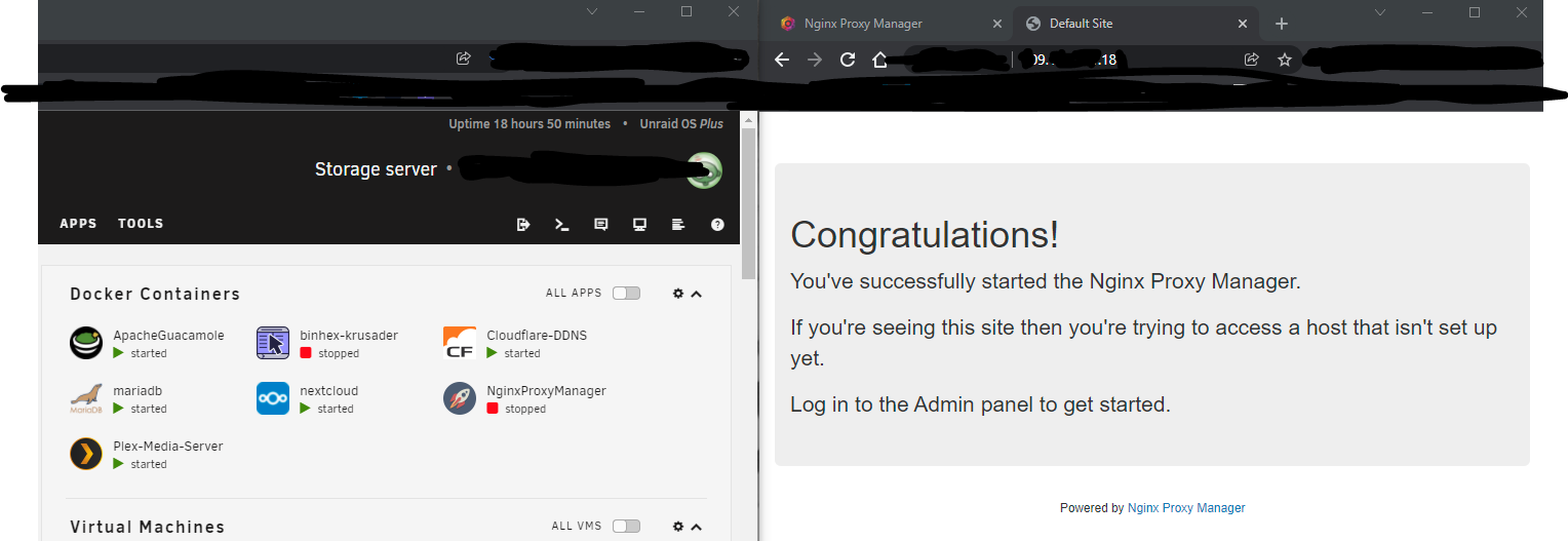

Perhaps your "congratulations" page is cached by Cloudflare? I believe it can do that for static websites. You could for example check the port forwarding on your router, disable that and if the page still loads then you are 100% not serving that page.
Also in the commandline you can do "docker ps" to see all containers running, this includes all the ports they listen on so perhaps that might give some insight.
Thanks!
I closed the port, and the "Congratulations" page still showed, so it could seem Cloudflare is indeed caching.
I also ran "docker ps" and there is indeed only one instance of Nginx running.
I still don't understand why it's suddenly stopped working, though =/ Everything seems fine, it just does not work anymore..
I would suggest to get cloudflare out of the equation just to see where the problem might be. I personally don't use cloudflare but I would do something in my pc's host file to force it to your external instead of cloudflare.
Assuming windows: C:\Windows\System32\drivers\etc\hosts (or /etc/hosts on linx)
Add
your.domain.name.tlc 1.2.3.4
where 1.2.3.4 is either your external ip or your internal npm ip (try both)
If that works, then cloudflare (connection) is to blame (somehow) if that doesntwork first debug your own setup.
Thanks for your reply, @mattie112
I've tried a few things now, including what you suggested.
I also made sure to purge the Cloudflare cache and turn on devoloper mode in Cloudflare, which let's one "see changes to your origin server in realtime.", just to be sure 😛
In a incognito window, to also bypass my browser's cache, I first disabled my router's port forwarding to Nginx and then tried to load the IP. I got a connection timed out error - with the error still up I enabled the port forwarding, and the error page changed over to the Nginx default page ("Congratulations..")
In my mind this proves an issue with the Nginx setup. Would you agree?

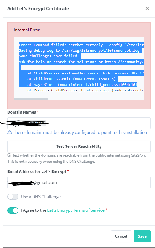

New setup - new \unRAID user...
Running unRAID 6.9.2 Trying to install Nginx docker in unRAID. Installed without issue using default settings.
Network is a Ubiquiti UDM Pro SE on current version with these port forwarding rules.
When I try and add a SSL cert in Nginx I get this error..
Error: Command failed: certbot certonly --config "/etc/letsencrypt.ini" --cert-name "npm-16" --agree-tos --authenticator webroot --email "[email protected]" --preferred-challenges "dns,http" --domains "XXXXXX.com" Saving debug log to /var/log/letsencrypt/letsencrypt.log Some challenges have failed. Ask for help or search for solutions at https://community.letsencrypt.org. See the logfile /var/log/letsencrypt/letsencrypt.log or re-run Certbot with -v for more details. at ChildProcess.exithandler (node:child_process:397:12) at ChildProcess.emit (node:events:390:28) at maybeClose (node:internal/child_process:1064:16)
Not sure what is going on here. It is stopping me from finishing the setup on vaultwarden (as I need a cert for that docker) and nextcloud.
I am using Cloudflare as my DNS and my domain is registered with them. I also have CNAMES for bitwarden and nextcloud that do resolved to my home IP.
Thoughts???
Thoughts???
If you are using NginxProxyManager, you don't port forward 444 on the UDM Pro. You port forward the port for NginxProxyManager. That is the reason why you are not getting a certificate. Forward the port for NginxProxyManager and try again.
