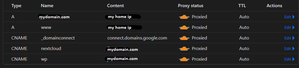

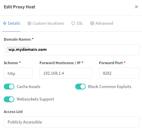

I'm trying to expose a Wordpress docker to the internet via Nginx Reverse Proxy (NPM).
I currently own a domain, use cloudflare, and have a NPM docker handling the proxying. For example, currently have mydomain.com going to overseerr (serverip:5055), and nextcloud.mydomain.com going to nextcloud (serverip:444). Router fwds port 443 to npm. I have 'force SSL' on cloudflare enabled, so haven't even opened port 80. Working fine, no problem. Have used the ibracorp tutorial for this process here.
Decided to try and host a site using Wordpress (complete noob with wordpress btw), set it up the same as I had with nextcloud using these steps:
  1. Cloudflare: add CNAME 'wp'
  2. NPM: add wp.mydomain.com to docker container webui (i'm using cloudflare SSL certs)
Not working! I'm just getting a timeout when attempting to access wp.mydomain.com. Via LAN accessing 192.168.1.4:8282 shows the WP test page perfectly, but no idea why this isn't working via proxy.
I've tried recreating my SSL certificates, forwarding to a different docker (heimdall for example), with same result.
I'm not sure what i'm doing wrong, particularly because I already have 2 working proxies, but if anyone could point me in the right direction i'd be forever grateful. TIA
Edited by Boo-urns

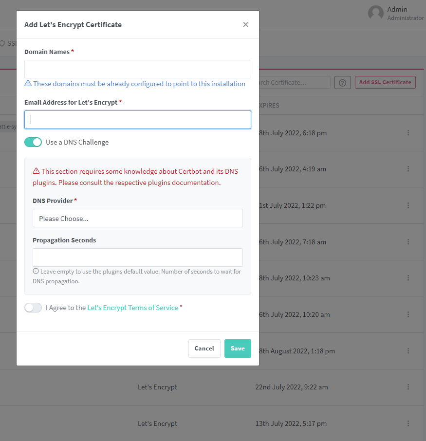

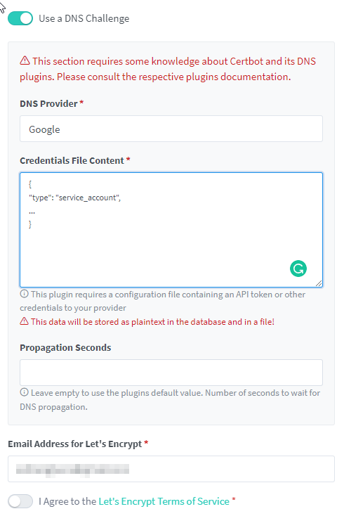

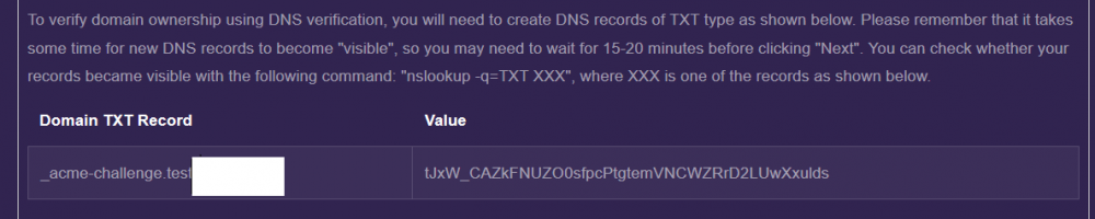

50 minutes ago, mattie112 said:
You should be able to do that through the UI:
Yes, you should but reading the NPM forum post, I should be putting a TXT value as such;
But the UI, when I choose my DNS provider, Google. I am presented with this and I have no idea what to do with it.
There is no simple TXT value choice in the dropdown.
No you should not do this manually (as it changes every time you'll need certificates).
So: you should input your google credentials and then NPM (or really certbot in this case) will do an API call to update the TXT record and then letsencrypt can verify that.
(also see: https://certbot-dns-google.readthedocs.io/en/stable/)
