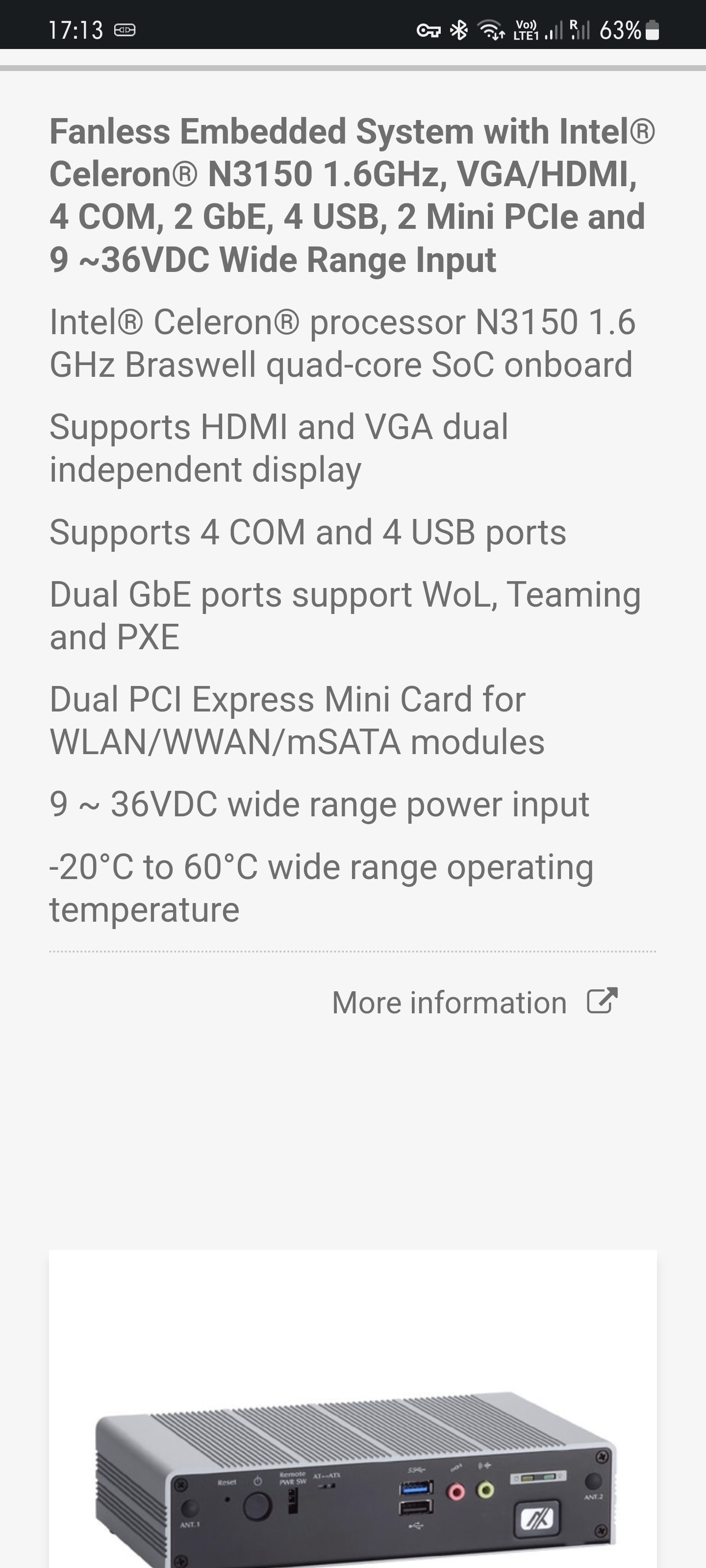

I have box 1  i7 4770 ,32gb ram
          box 2 Celeron N3150 4gb ram
I try to use Celeron box only for Photoprism because is fanless and very low power use.The other box i turn off somethimes.I have 3 of this boxes on one is Opnsense firewall and  1 wanted to use just for Google photos replacement.Then i need to transfer all Npm to be on Celeron box and run it 24/7 and everything is gonna be ok.I think this is the most easy solution how you said also.
Thank you very much for your help.

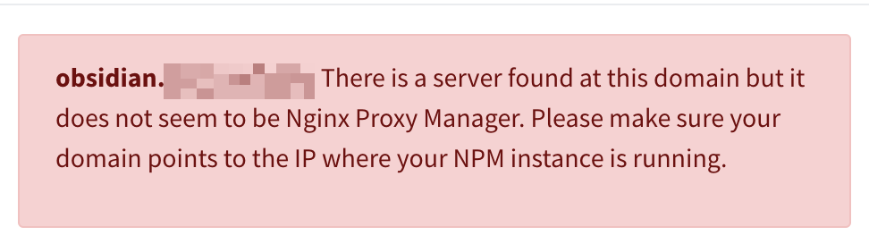

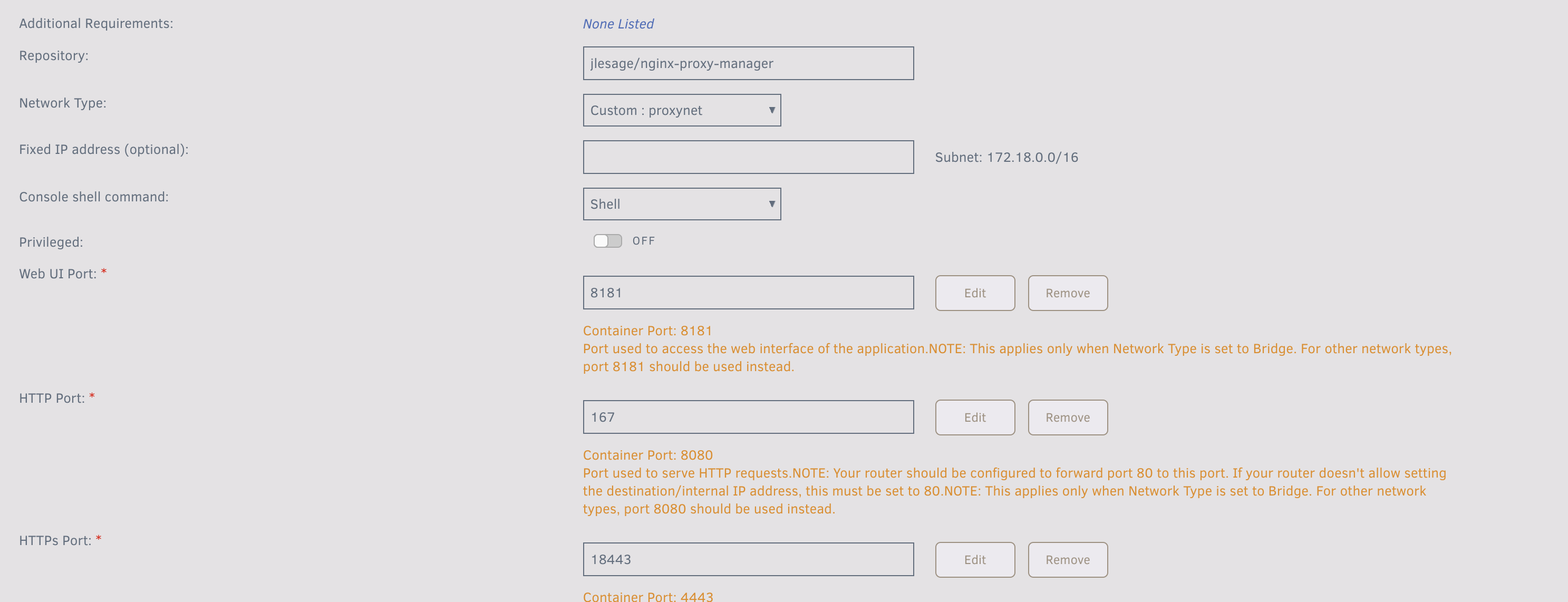

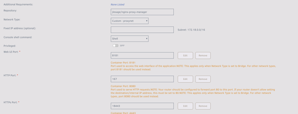

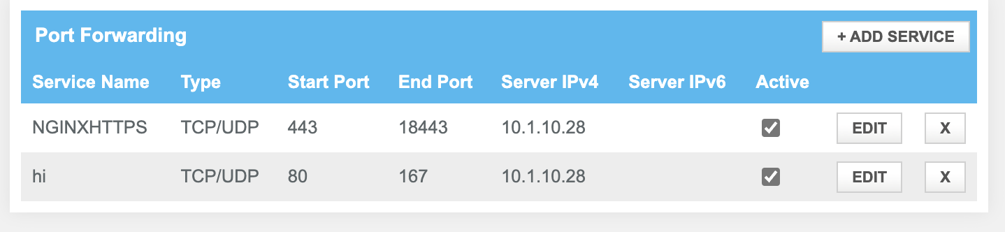

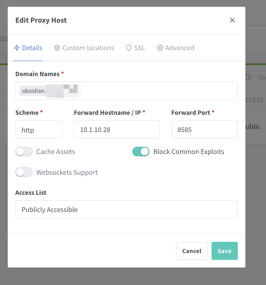

Just went through the setup process for nginex, but when I go to my domain, it redirects to my Unraid server login rather than the container/port that I have it configured to. My domain is managed with cloudflare and I have CNAME subdomain pointing to duckdns.
Any help would be greatly appreciated!
Are you sure the port forwarding is correct? A 'start' and 'ends would indicate you are forwarding (allowing) that range to go to your server (or container). I do not see a 443 to 18443 forward for example.
You could try NPM on 80/443 (if it has its own IP) to verify this. Or try to access port 18443 remotely then you can be sure.
You were right! I just assumed 'start' meant incoming and 'end' meant out going. Just keeping it simple by forwarding 80 and 443 worked.
Thank you for your help!

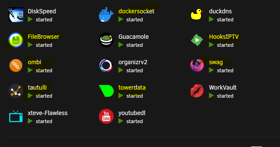

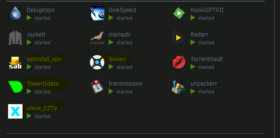

Hello guys.  Thanks for the responses.    So this is server 'A' (ports 443/80 redirected/forwarded to 192.168.1.25) my main server.  These containers in the screenshot here have all been configure for reverseproxy and communicate on the custom network interface I created called 'reverseproxy' (172.19.0.0/16).
These here containers below are on server 'B' (192.168.1.11) and I would like to reversproxy these also using the SWAG proxy manager from server 'A' and possibly the same custom docker interface from server 'A'.  Is this possible?
Again...  thanks for the help and hope I'm making sense to you all :) considering I'm a basic user.  FYI...  I tried to create a seperate SWAG proxy manager on server 'B' until I realized I cannot redirect/ forward ports 443/80 to server 'B' as I only have one public address to work with.
