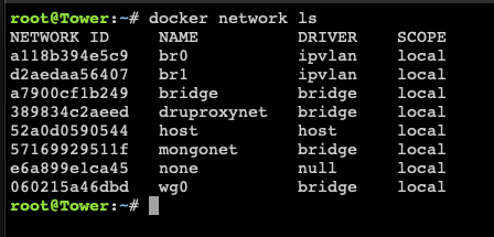

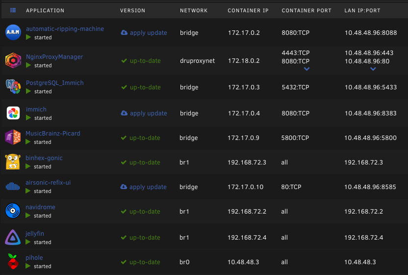

Hey @Djoss
I'm having issues communicating from NPM to certain containers on different networks within unraid. Can you let me know what's the best network setup for NPM to communicate with any/all containers across different networks?
I can successfully communicate from the following:
NPM 10.48.48.96 (druproxynet) --> any container on (bridge)
NPM 10.48.48.96 (druproxynet) --> 192.168.107 (on proxmox server)
I can't ping from the following:
NPM 10.48.48.96 (druproxynet) --> 192.168.72.3 (br1)
NPM 10.48.48.96 (druproxynet) --> 10.48.48.3 (br0)
Please see screenshots for the docker setting, network listings, container list.
Thanks
Edited by TekDRu
add interface settings

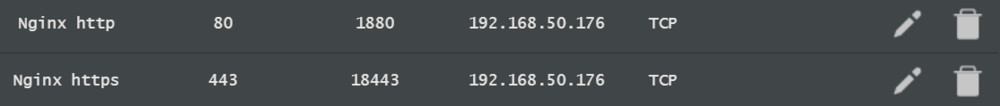

My settings router:
