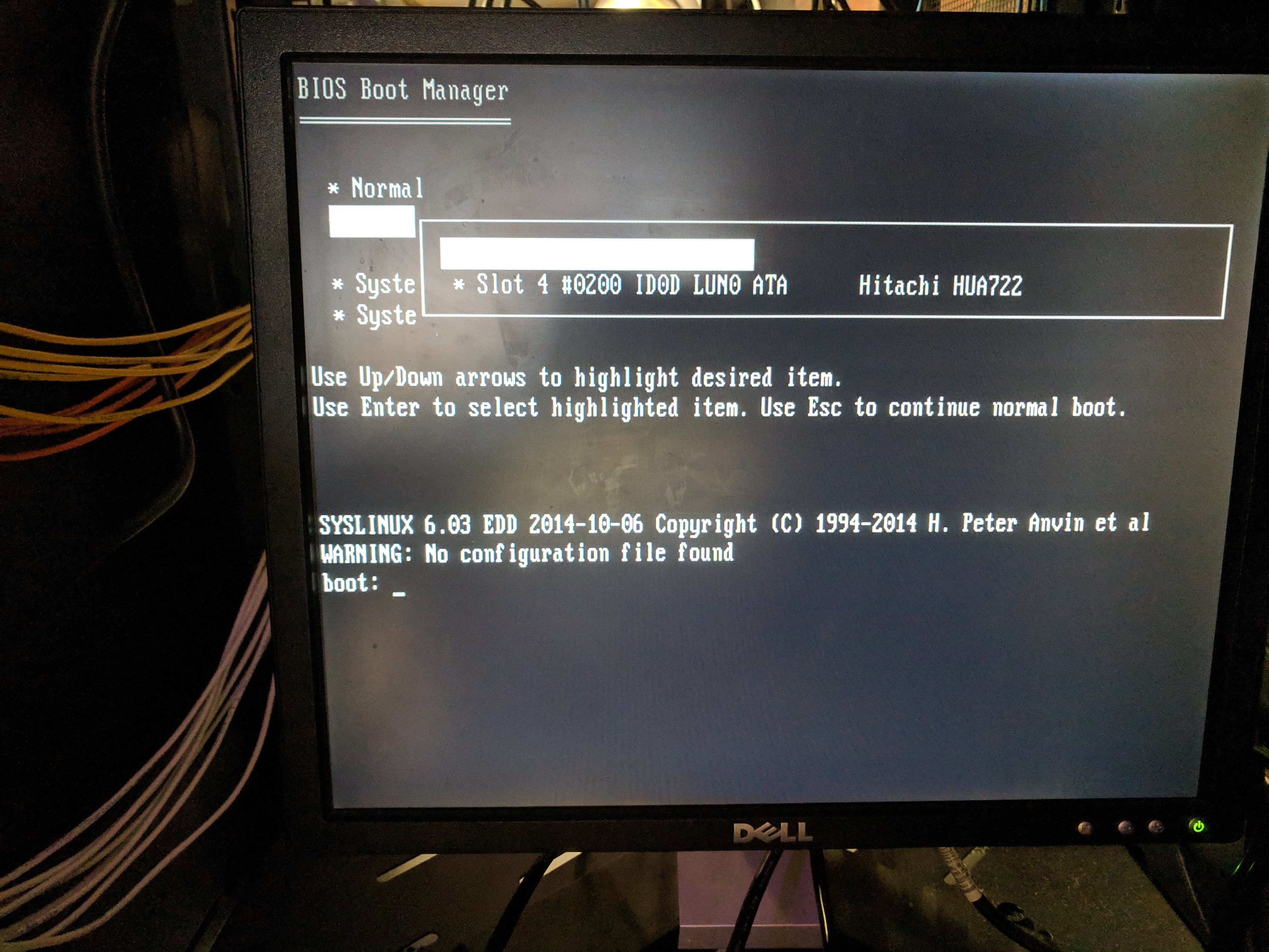

Can you get a screenshot or photo of what you are seeing?
As you'll see in the pic below, the bottom portion of the screen is the error message. I have pulled the Flash Drive and opened it on one of our desktops and it seems to be just fine. No apparent damage to the device. I have copied the contents of it to a folder on the hard drive and can see the contents of the config folder and all the files appear to be there.
I suspect that the config file is the syslinux one (syslinux.cfg) that should be in the syslinux folder.     That is the one used to define the Unraid boot menu.

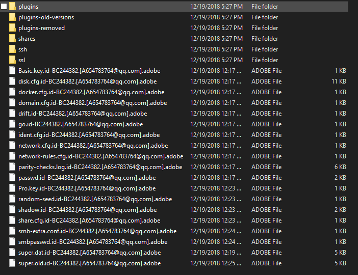

I have to update this post today because something else has happened that now makes me think there is a more to this story. We have 5 UNRAID servers. The primary server was affected and we have now found that a second UNRAID server is having the same issue. I took the Flash Drive to another PC not connected to the network and the exact same thing has happened. The files are now showing the .adobe file extension.
This got me worried so I checked our XCPng server and several virtual machines are also affected...or should I say infected. This could be a crypto virus of some type but I can't find any answers on the web and there isn't a "RANSOMWARE" demand in any of the directories we've checked.
So if any of you have heard of this...please post back here so we can try and figure this out. If it his us that means it could infect/affect many UNRAID users!!!
One of the first things I do to a new Windows install is make it display extensions. I can't understand why anyone wouldn't want to see them.
I have not heard of this problem, and I was a bit dubious when you first mentioned Adobe Creative Suite since we have that on our desktop and I'm sure many others here do as well and nothing like this has ever happened to us. But it's probably been years since I needed to put my Unraid flash in my PC. Which file extensions are being changed, just .key?
I certainly understand that and I jumped to conclusions when I had done an update to my Creative Cloud, Windows 10 update and UNRAID update all within 2 days of each other.

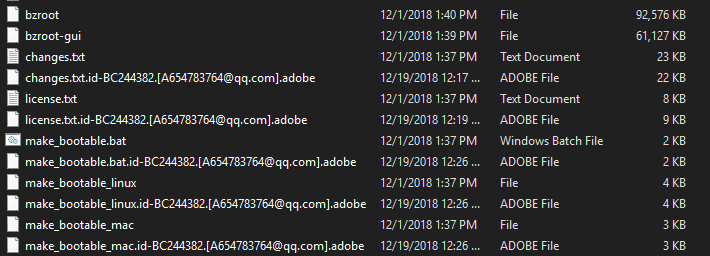

Every single file on the Flash DrUNRAID_File_Names.PNG.6d1eb9d3459bd28a0aee39a39ee9302c.PNGive has the issue. Here is the screenshot of the so you can get an idea.
My bad...I uploaded the incomplete screenshot. Here is the correct full-screen shot.
Ouch...thanks for that information. I see it doesn't have a decryption method either. Strange that there is no decrypt ransom text file anywhere.
