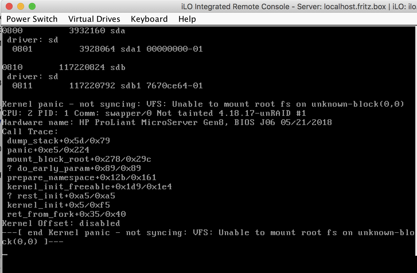

After 1 month testing and configuration now the unhappy end and frustration. Purchased key and did the registration in Gui. Told to make a reboot and now get kernel panic. No idea what's the problem now...
My server is a ProLiant MicroServer Gen8 with 16GB ECC RAM and 4 SATA HD's.
Can anyone help me please?

If it booted correctly before it's likely a flash drive problem, backup current flash, format then redo it and restore the config folder.
Hi Johnnie
.... never had a problem with this USB stick. Restarted many times before. The key update has damaged the stick now!
Are you really serious you want me to format the stick? How do I get the config folder on the stick? it's on an unassinged hd. Server is not here...
Are there any other solutions?
i'm just wondering if it's a good idea to run a server operating system on a USB stick....
it runs again. drove to the server place and did it with my laptop.

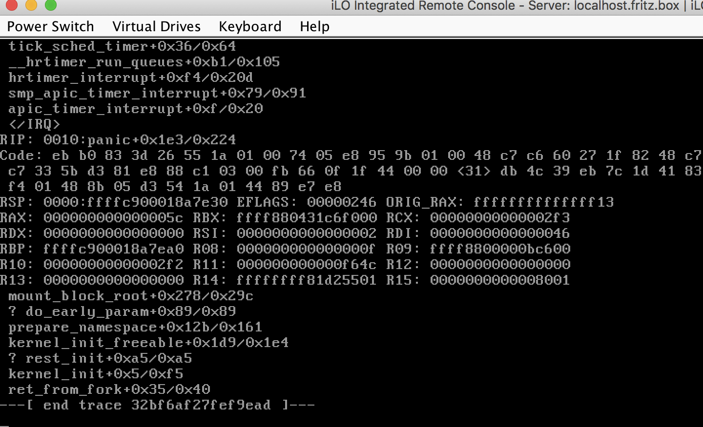

this is the screenshot I get this time:screenshot_97.thumb.png.4fd8f9d4d5cd1b9e7141890f19b4e216.png
Have you tried other USB ports?
No. I have just one internal USB port. Not shure I can boot from extern USB.

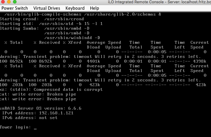

Changed USB Stick (not a new one) and installed it. Copied the config folder over and started again. Not shure if this message has something to do:
Server is running again. Array doesn´t start because of the wrong key. I´ll wait for the new stick for updating the right one.
