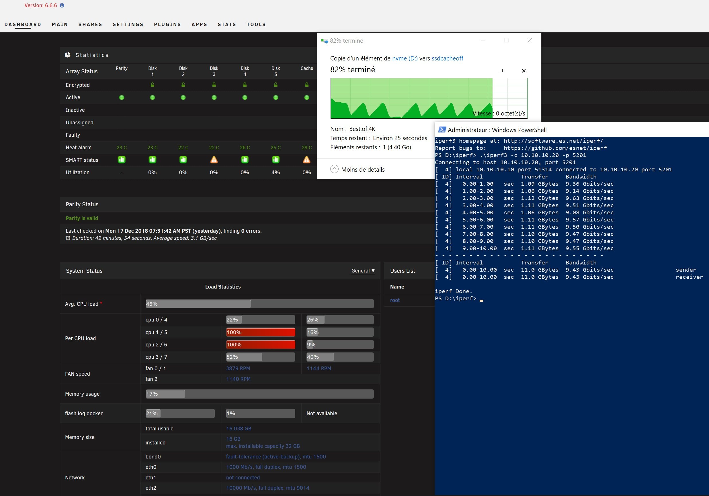

The problem i encounter each time i try to transfer anything is that i have very poor I/O during copying through 10Gbits/s fiber cards the speed move up to 500MB/s few seconds then fall back slowly to 0 and restart to spike about 400-450MB/s before falling slowly to 0 etc etc (as shown on screenshot)...
In final the average transfer time is worst than with the gigabit ethernet line wich make me think that something's wrong with 10Gbits settings (smb windows 10 tweak, network or cache tweak ?) but unfortunatly i'm too dumb to discover it by myself.

PS: Screenshot of windows10 and diagnostic tool zip during transfer of a 4K sample disk in attachments.

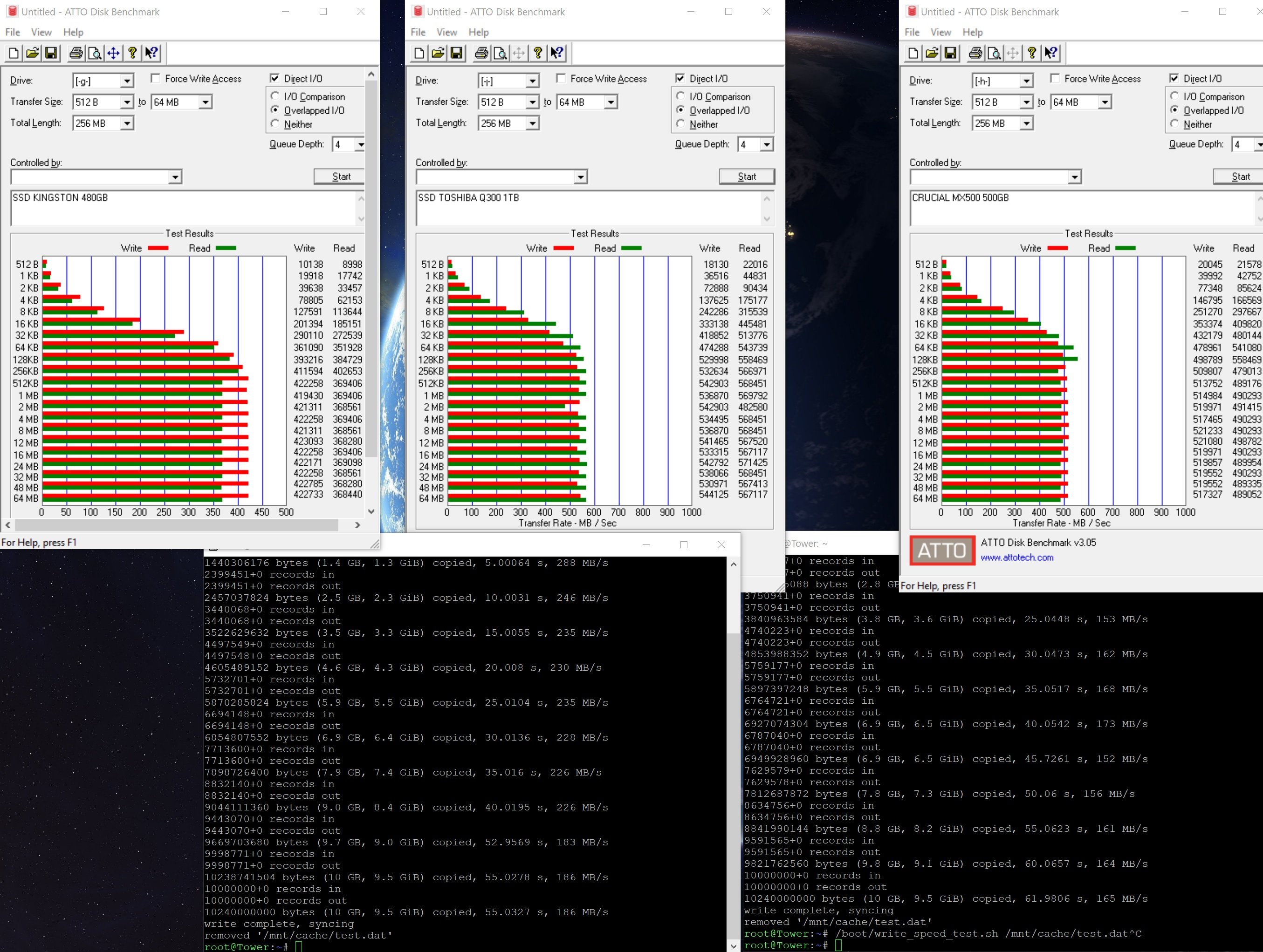

Thanks johnnie.black i tried your script with differents ssd cache possible and results were let's say disappointing as visible in the screenshot below;
When i try the same file transfer on windows 10 (ssds exfat format aes crypt) from the same nvme i get pretty decent write speed (the test file is 25GB size) :
Kingston 480GB : 350MB/s average
Crucial MX500 500GB : 400MB/s average
Toshiba q300 1TB : 430MB/s average
same with atto / crystal disk mark / hd tune pro but those only bench the slc cache i presume since they use low file size ?
Question is why such huge difference between windows test and unraid through 10Gbits nic ? i get that btrfs crypt isn't same as exfat aes but at least i would wonder a stable transfer speed even if it's only 200-250MB/s and it's not the case it's dropping to 0 all the time...

The write speed tests show the problem are the SSDs, speed will be limited by the slower one, so around 150/160MB/s is currently the max speed even without using the network, so no SMB or LAN tweak ca help with that.

There's not much point, and while the MX500 should easily do around 250/300MB/s the Kingston 480GB might not, if it's a non 3D TLC SSD 150MB/s if about as fast as it will go.
