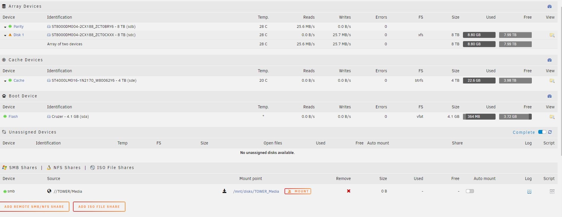

I recently created new array and performed preclear. after adding the disks I am getting orange triangle on data drive and not sure what's wrong there ?
Can someone please help  and explain ?
Its rebuilding disk1.
