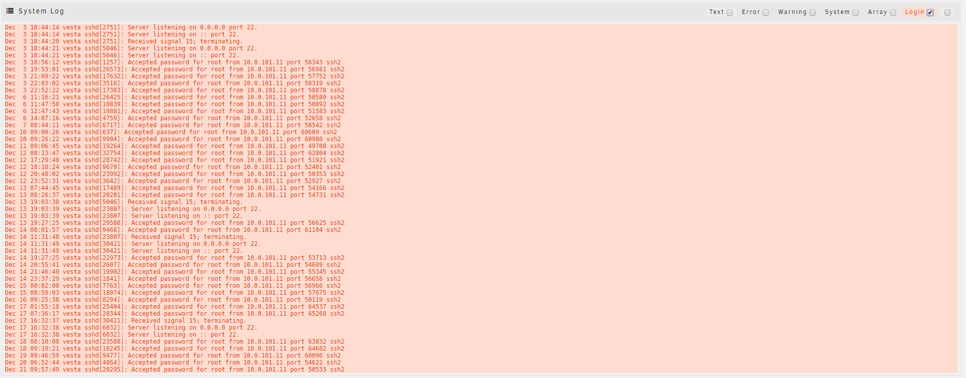

The syslog page in the GUI gives instant view to the login attempts.
Uncheck all categories except 'Login'.

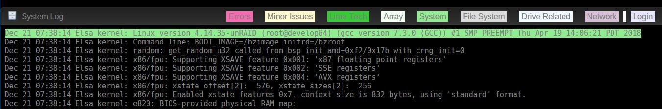

Silly question:  How do I "uncheck" categories.  I don't seem to have checkboxes.  (See screenshot)

That doesn't match my system log display or the one bonienl posted. Do you have the Enhanced Log plugin installed maybe? I'm not sure that is being maintained anymore.
Is that screenshot from going to Tools - System Log or did you just click the Log at the top of the UI?

That was from the tools menu.  No log related plug-ins are installed.  (Just checked)  I'm on unraid 6.5.1

Your screenshot is not the standard Log function under Tools. Uninstall the enhanced logging plugin.

That is a pretty old version. I don't know if it was different then or not. I still think there is some chance that all those additional buttons in your screenshot is from the plugin. If you want to post your diagnostics we could probably check to see if that plugin is installed.

I hadn't realized I was out of date.  (It never showed up as an available update like it has in the past.)  I just updated to 6.6.  Quite different!!  (and the log viewer problem went away, so I'm good there)
