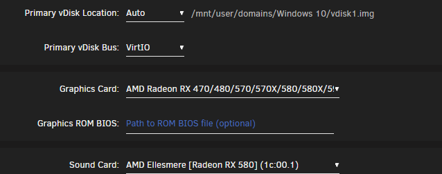

Since I am passing through the GPU,  shouldn't I update the "graphics ROM" in the VM setup?
If I am correct, can someone give me an idea of where I can download the ROM BIOS file?  I am not sure if the manufacture website offers that somewhere.  the current driver that I am using here is dated for 2017, so I think I do need a new one...
