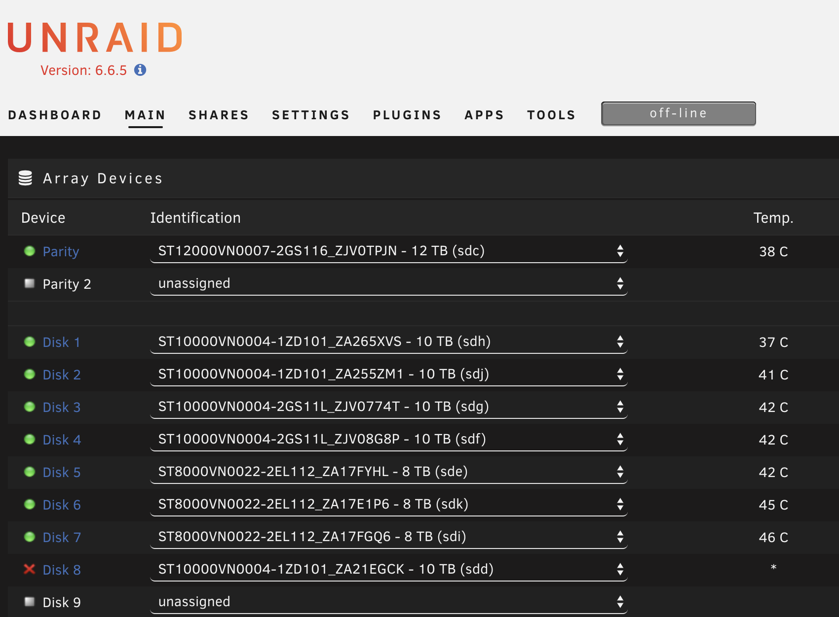

I replaced my old E3 with an E-2176G today on a new SM board, and ran into some issues with an LSI card.  The ROM would load and I could see the drives in linux...but unraid would get stuck mounting the only array drive on the LSI board.  After some effort I got it to shut down, and moved the LSI card to another slot.  Now everything /seems/ to boot properly, but the disk is in "Error Disabled" state.  Before I "Start" the array, I wanted to run the diags by the group here.

A screenshot of the main GUI page might clear up some things.
Here you go!  I'm not sure what will happen when I start, it doesn't give the normal "Start Array and rebuild disk" message...just the normal "Start".
791170215_ScreenShot2018-12-21at5_54_48PM.thumb.png.30783122d184cf0516e29d8743e2ef55.png
Hmm. The message to format an unmountable drive wouldn't show up until you start the array, so you don't yet know if there will be any issues.
Maybe someone else will have a different opinion, but I think if it were me I'd start in maintenance mode and do a file system check on all the drive slots before either rebuilding the drive in place or discarding parity and using the kicked drive as is.
If the file system check comes up clean on all 8 data slots, then rebuilding slot 8 onto the same drive is probably the correct option.

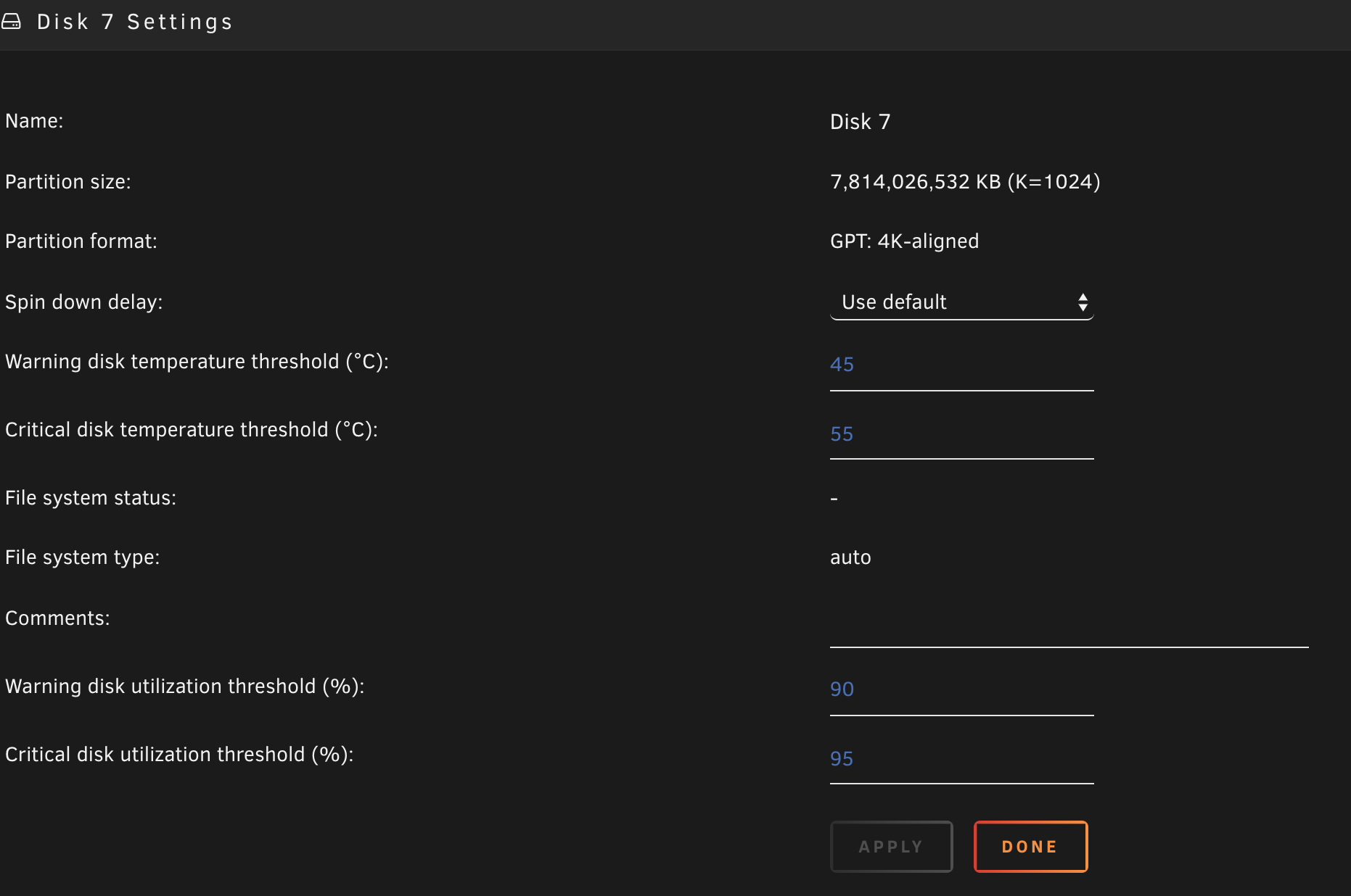

I'm not seeing that option, it doesn't even know the FS on the drive for some reason.
1561026205_ScreenShot2018-12-21at6_07_25PM.thumb.png.ac4dd8a8172499523a14b35751bb2c05.png
In reading the docs, I'm starting to worry.  It should know what file system the disks are, and have a file system check section...but it doesn't.  Tell me I didn' tlose 50+TB of data please? :)

Unassign disk8 and start the array, if the emulated disk mounts and data looks correct rebuild on top.

Ok, loaded up fine and is showing the files on the bad disk.  Going to re-add it now and start the rebuild
