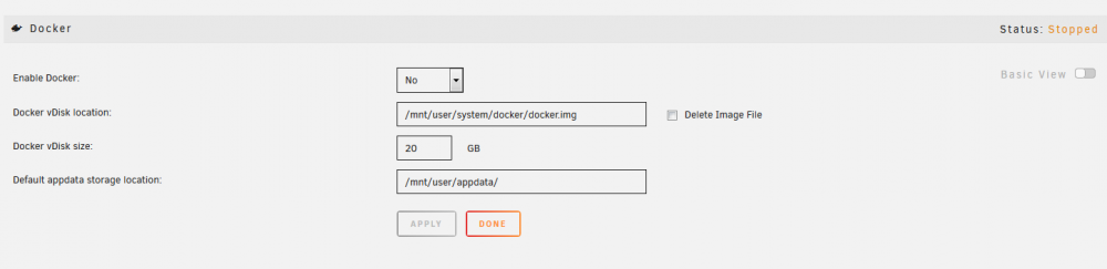

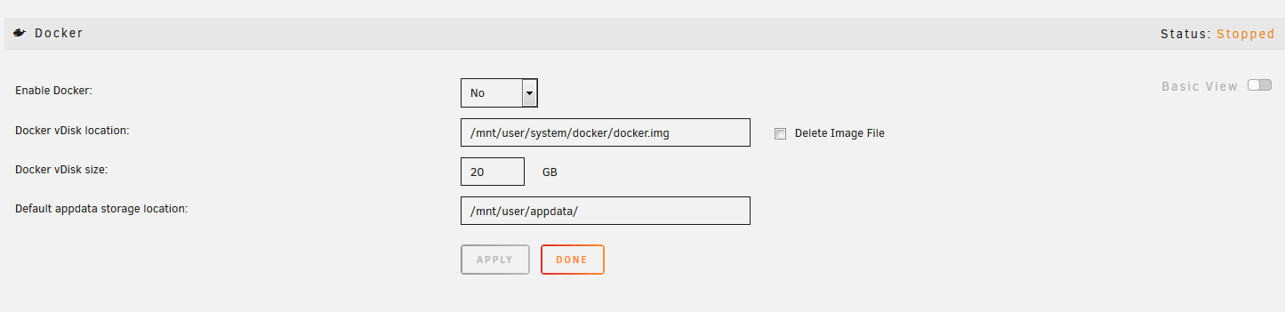

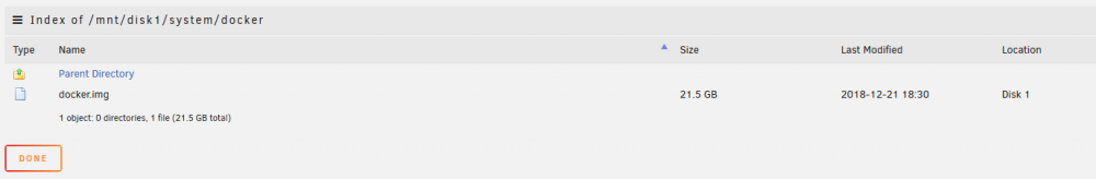

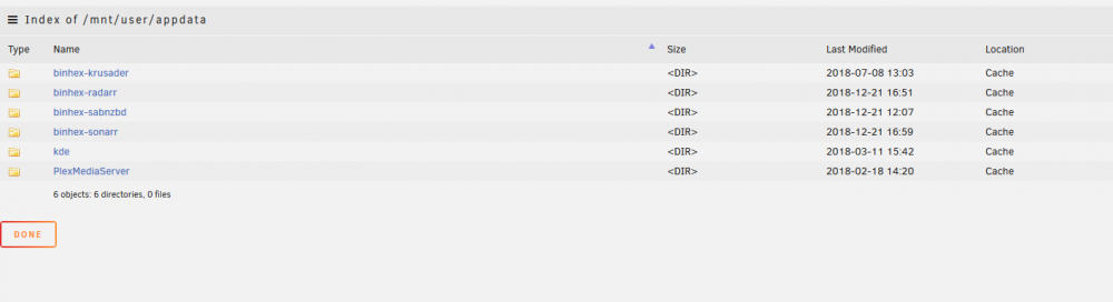

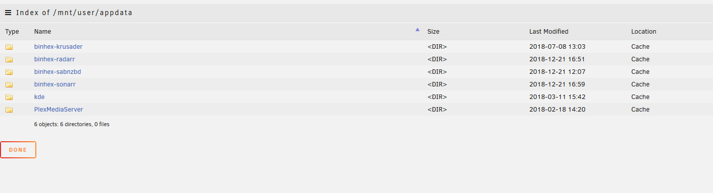

So i'm having issues with my docker service not working.  I think it's because it may be full.  I logged in to the webGui and had several notifications about the docker image filling up.  I've looked in /mnt/user/appdata/ and don't see anything about docker there.  When I look /mnt/disk1/system/docker there is a 21.5gb file.  Seems it's larger than what was supposed to be set.  This confirms to me that the file is too large.   I'm thinking that I might have things mapped incorrectly and likely I need to either delete and or move the docker.img somewhere else.  I'm not exactly sure which way to go about this.
 Under settings/ docker I've tried to enable docker but it still doesn't run.

Check the box to delete your docker image. You will have to recreate it and reinstall your dockers. See here:
https://forums.unraid.net/topic/57181-real-docker-faq/#comment-564363
Also, see the Docker Image Filling Up section of the Docker FAQ:
The usual cause of filling docker image is applications writing to paths that are not mapped to Unraid storage.
Well, that did the trick. Deleted the docker image, then enabled docker.  Everything is back to normal, now I just need to figure out why.  Is the docker img file always supposed to be max size?  With docker running, it's now located in the cache drive and still 21.5gb.   Does it look like I have things mapped correctly.
I usually recommend setting it to 20G, even though I have never seen anyone need nearly that much if they have things configured correctly.

I have no idea what your mappings are. Do you understand docker volume mappings? Even if your mappings make sense you can have the actual application configured to write to a path that isn't mapped to a container volume. As I said
You need to look at each of your applications and see where they are configured to write data, such as downloads. They must write to a path that is in a container volume.
Just noticed the broken links in that section of the Docker FAQ. I have fixed them. Maybe you can get some idea from looking at those. Or we can just try to work through what you have.
Do you have any dockers that download?

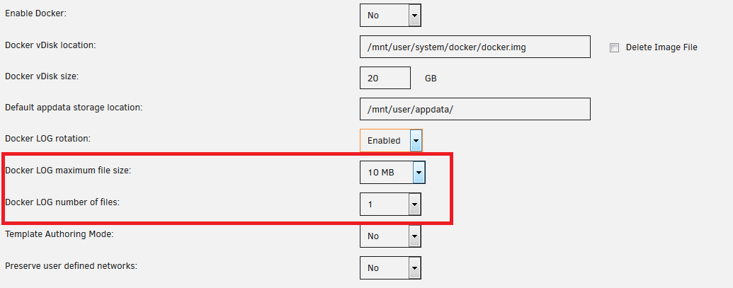

Another thing. On the Settings - Docker page, move the slider at top right to Advanced View, then make sure you have Docker LOG rotation enabled.
The dashboard currently shows 26% usage on docker image.  I checked container size and krusader is using the most with just a little more than 2gb.
LOG rotation was disabled.  Do I enable and leave default settings?
11 minutes ago, Mikecdm said:
Do I enable
yes
don't know what you mean
The two LOG fields appear once enabled, they have values that I'm not sure if I leave default or not.   Thanks for the help BTW.
yes defaults should be fine
