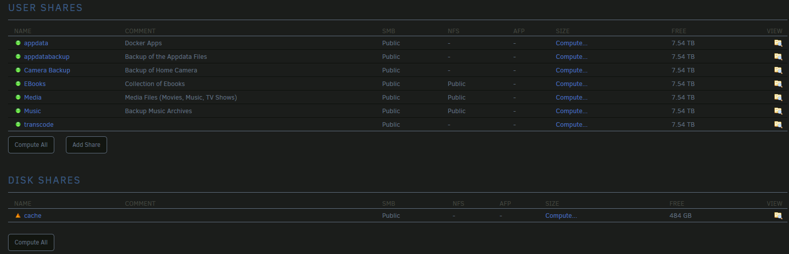

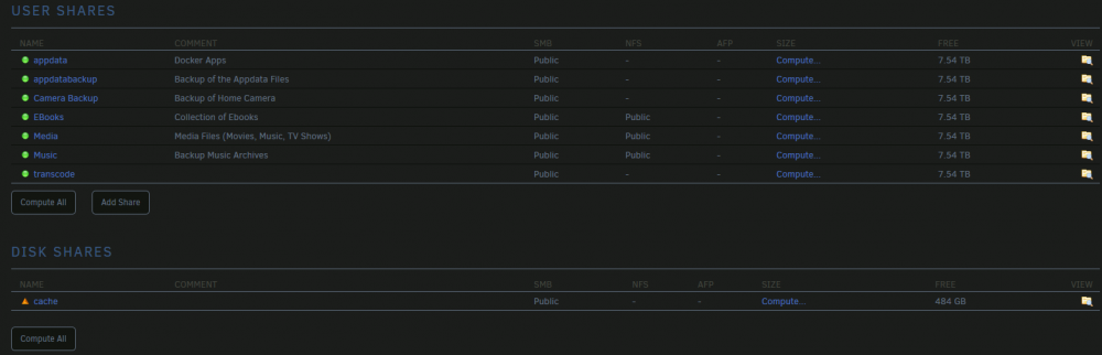

You have an unusually large number of .cfg files in config/shares. Possibly many of these are no longer used. How many user shares do you actually have?

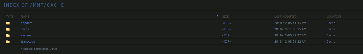

At the time only a two Media share for Plex and the other is a Music Share. I have an Ebook share but it has nothing in it at this time. The Camera Backup share was an experiment but its empty and not used. I attached my Share directories to this post. I checked them all but did not find those .cfg files. Am I setting the Shares up wrong? I was not sure about the public / secure / private setting enough to really change them. I would like to keep it all private but did not want to dork up the process since everything is working so good.  I also added a pic of the inside of the cache folder.
