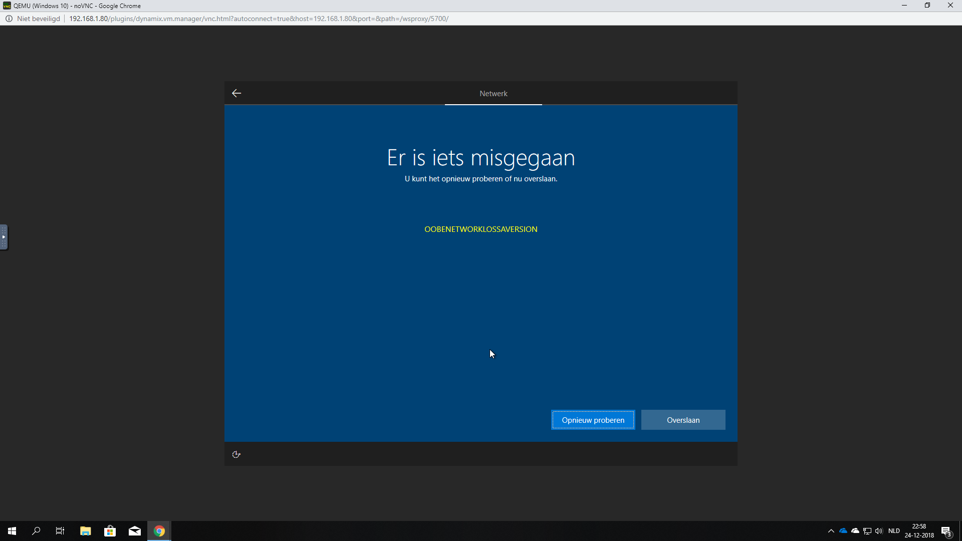

When i install a windows 10 vm is keep going in a loop on the network instalation.2018-12-24.thumb.png.086a21bad0585d2b856a41acc6609fb7.png

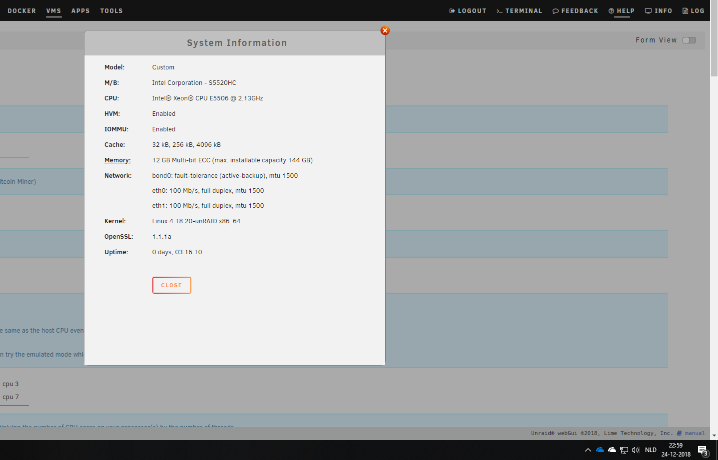

i am installing it wrong or is there a drive that i need to instal?1030203104_2018-12-24(1).thumb.png.14a2d68c28063d37cad4ae05706c9602.png

On the virtiso disk that you tend to mount in the VM template, you'll find the drivers
Edited by Squid
Skip the network part during initial Windows install and install the driver later from the mounted virtio iso. If you are done the Windows install go to your device manager and install the missing drivers. @boumanp
thank i got it working.
it looped back 3 times and than it booted.
