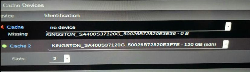

This is where i started running into issues again. On several occasions the instant i took the array offline the drive would just vanish
ac4ae
I found that there are a number of ways i can get it to come back. Sometimes it would just come on its own without me doing anything. I would just refresh the page and it would be there (I suspect thats what happened when it "unassigned" itself a couple months ago)
Other times i would need to reboot at least once but sometimes several times before it would show up again. And i also found that simply plugging the drive and plugging it back in again would also almost always fix it. I tried using different connector on the SAS breakout cable but that made no difference.

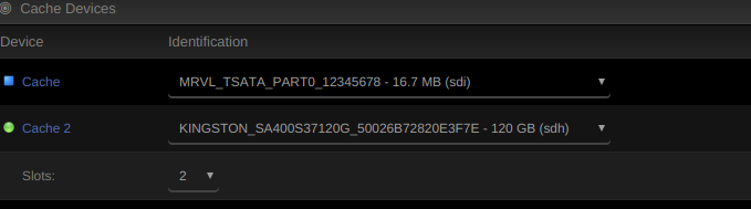

Also sometimes the drive would show up like this.
9530b
(It did not assign itself like that i did so i could take the screen shot)

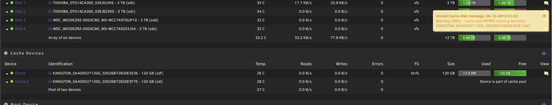

Oh... Ok... so it does give "an error" but its just a notification... I dont pay much attention to those because i get a lot of them for system status and what not. (i may want to adjust my notification settings)
8bd75
I kinda expected the drive to go red and display some "device missing" message or something. Instead other than that notification it just pretends nothing is wrong...
