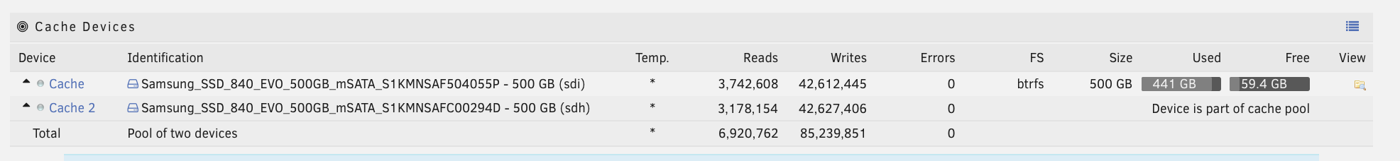

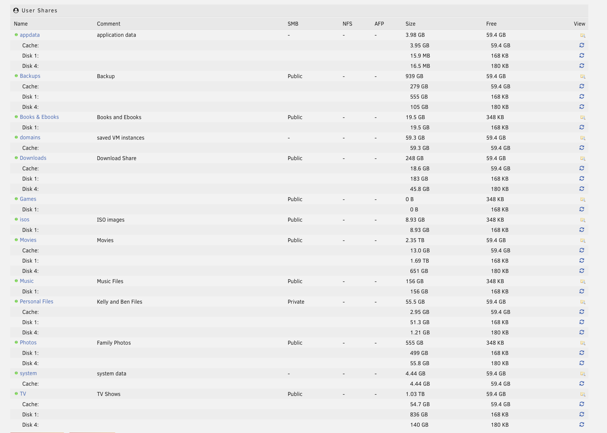

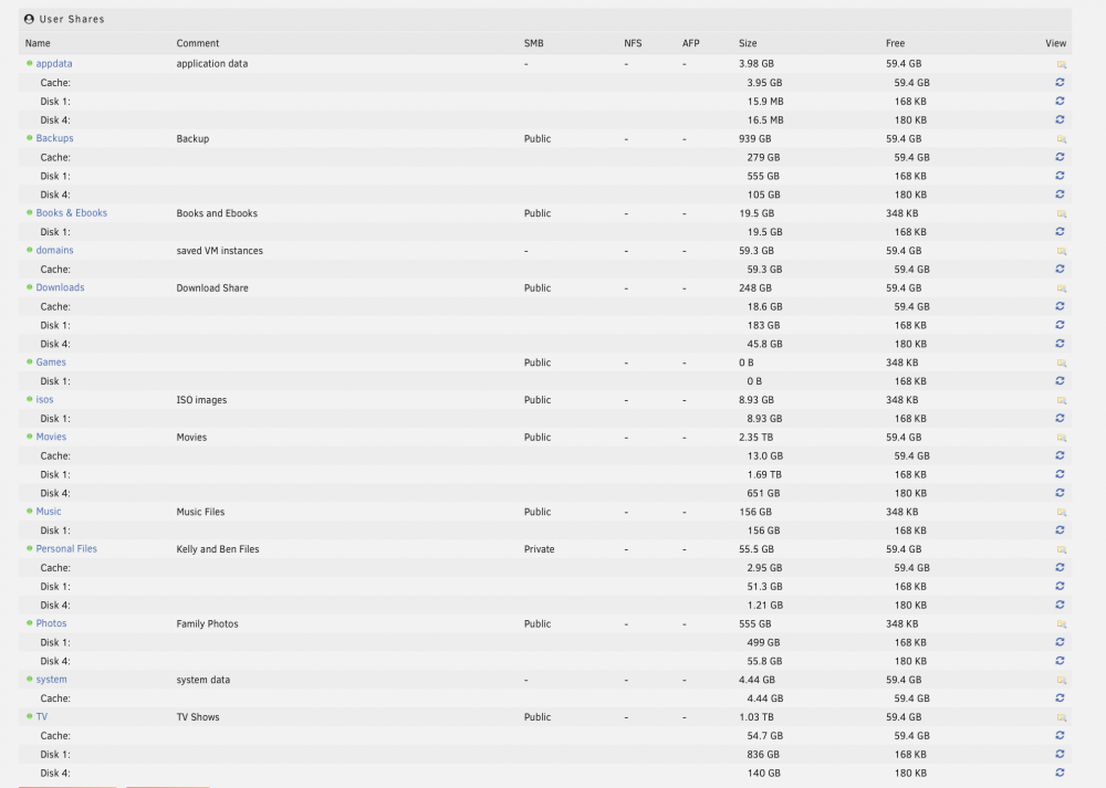

Hello,
I have noticed that my cache drive is almost full.  It is a 500GB dual drive setup.   Gone through the steps listed here https://wiki.unraid.net/Replace_A_Cache_Drive to move all files from shares to the array.  This involved changing all shares to yes.  Stoping and turning off all dockers and also the same for VMs. Then enabling the mover. Unfortunately, they don't seem to move when I run the mover. Do I need to restart? What else can I provide you to help me identify the problem?  Should I reboot my server and try again?

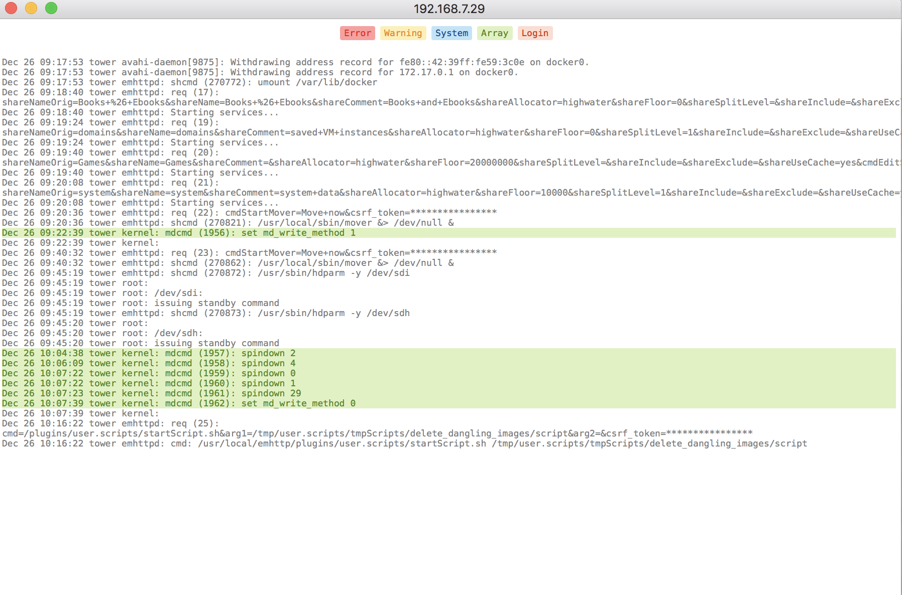

In Settings - Schedules - Mover, turn on mover logging (and apply) then repeat your attempt to move, followed by posting your diagnostics.
Edited by Squid
Great will do
Updated original topic with diagnostics data taken with mover logging turned on.
shareUserInclude="disk1,disk4"
/dev/md1        3.7T  3.7T  164K 100% /mnt/disk1
/dev/md2        1.9T  1.9G  1.9T   1% /mnt/disk2
/dev/md4        932G  932G  176K 100% /mnt/disk4
Change to Global Share Settings (Settings) to also include disk2 (Probably have to stop array to do this).  Then re-run mover
