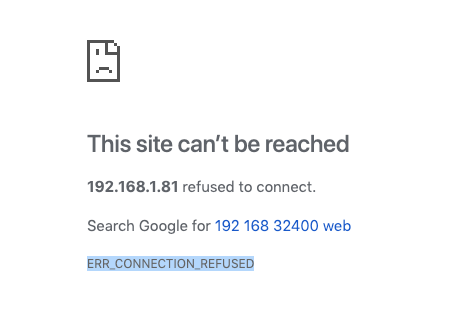

I just built a new unraid server and am having some issues. I installed Unraid and then installed a couple dockers. Everything worked great (Plex, openvpn). I rebooted the server and now I am getting an "ERR_CONNECTION_REFUSED" when trying to access Plex WebUI. I did not make any changes other than rebooting the server.
I am able to access the server directly via my Macbook on the same network. However, I am unable to directly access any dockers... Any suggestions.

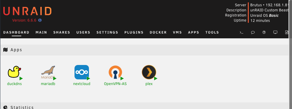

Sorry, I am unable to access Plex. I can still connect to OpenVPN and Nextcloud.

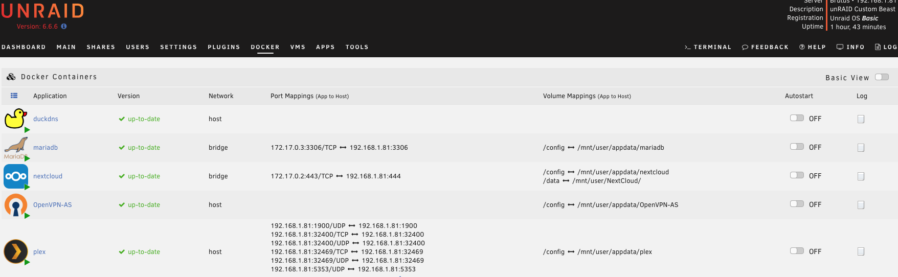

826513842_ScreenShot2018-12-27at9_58_58AM.thumb.png.1203445e124bc0b2b7d0b26e38193b52.png
Not that it should affect your ability to connect to Plex's UI, but even if you could, you wouldn't be able to access any media, as there is no mappings directing it to your media files on the server.  Post the logs for the Plex container (as per my previous link above)

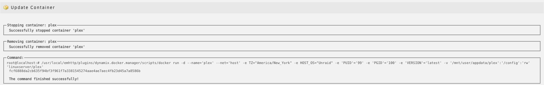

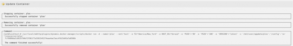

His screenshot for the docker page shows a mapping but his docker run command doesn't.

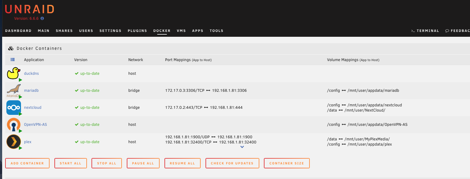

Did you make any changes between taking those screenshots?
Post another screenshot of your docker page.
Also, please don't post html files, rtf files, etc when a simple plaintext file will do. Logs are much easier to read and work with as .txt files.
WIll do. I'll post only text files. I just started paused and restarted the plex docker to generate the log file. I didn't make any changes to any file or setting.
1999507533_ScreenShot2018-12-27at10_37_26AM.thumb.png.cf1c5003be3e4ca4015dde9cda71003b.png
It really looks like you did change / remove a mapping for /data
