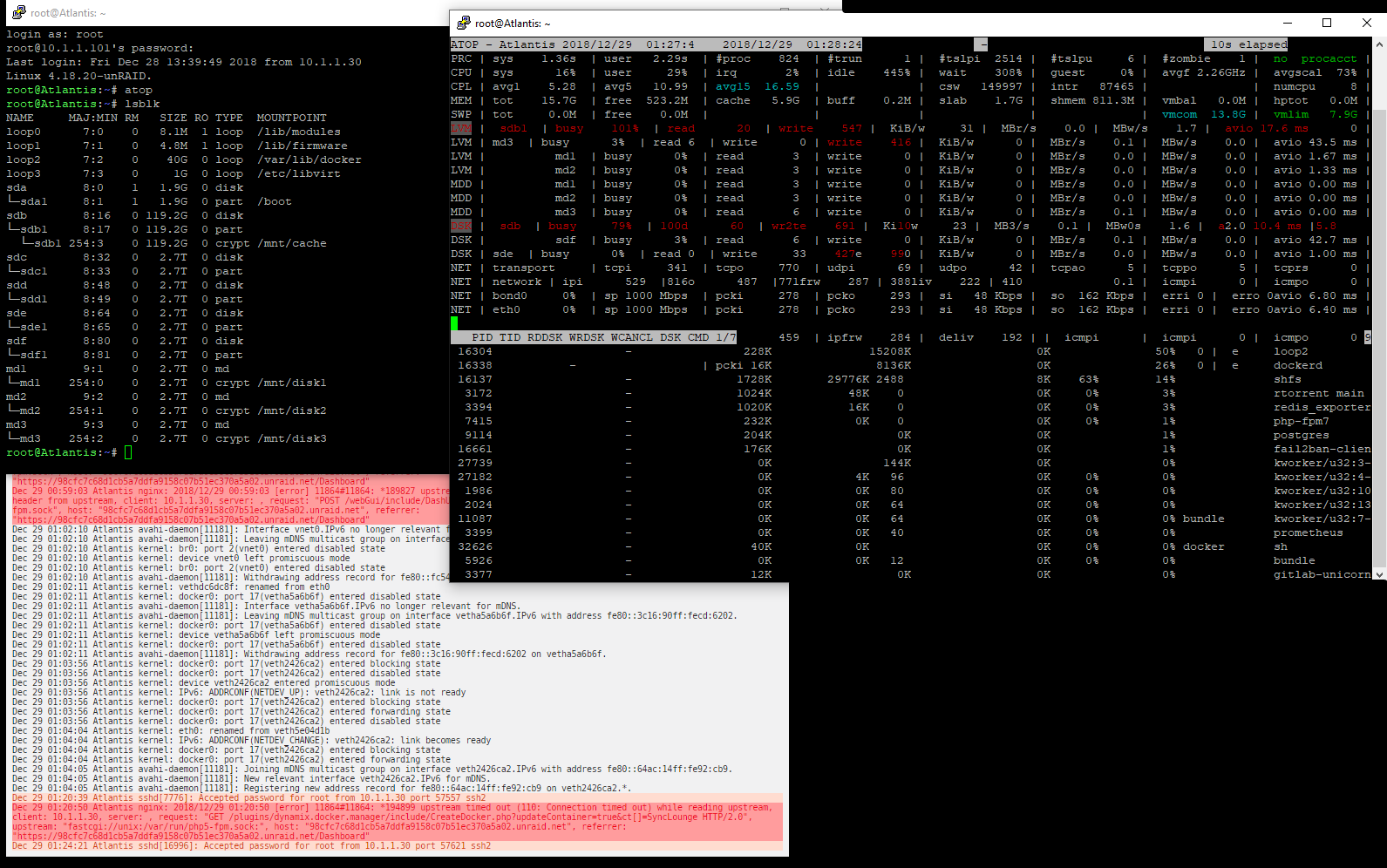

So for a while I've notice the servers UI has become unresponsive quite often, especially with updating dockers. Even the stats for the CPU on the dashboard vary wildly from what htop would report. I noticed this around the time I updated to 6.6.6.
Today, it got much worse. I went to update all the dockers at once under the docker page annnnnd, I came back to find the cache disappeared. I managed to umount the array, and shutdown the machine. After checking the cables, I booted up, cache was there, so I tried the updates again. It didn't take long before the cache chose to go walkies again. This time I could shut the array down and had to pull the power.
Once I had the server running again I checked the SMART information for the drive. It looked fine, just it was acting off.
I ended up trying to update the dockers one by one, often with the gui timing out. Eventually I got them updated and figured I'd look into it more tomorrow.
After getting alerts for more updates and with me still awake, I thought I'd update them. Annnnd it timed out again. So I thought I'd grab the diagnostic infomation and seek help here.
This shows me trying to update a docker. The upper left shows the connected drives in the system. The right shows atop with disk information, which shows the cache drive struggling. The bottom is the log info for the system, and the gui timing out during the docker update.

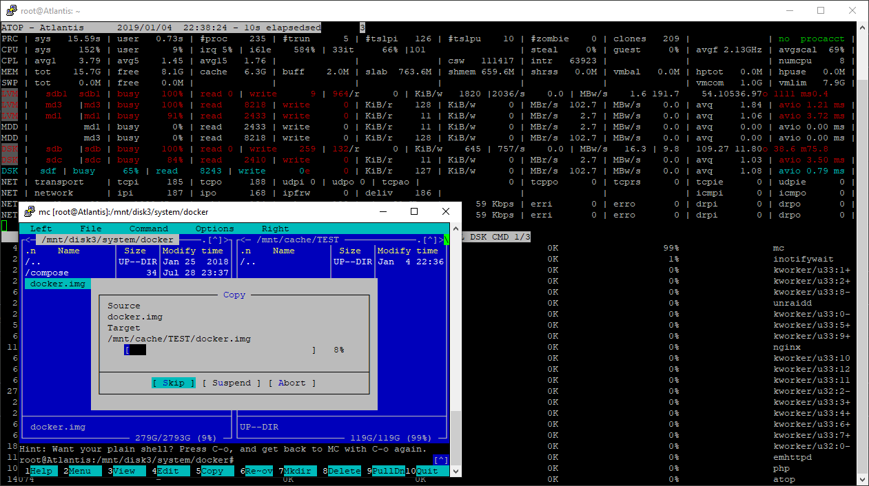

Alright, Testing with copying just the 40GB docker image to the cache, this should be the only activity on the server, and I'm seeing this:
Even 5 minutes in this is taking... Ahah, I've actually managed to trigger a failure durning testing, let me throw the diagnostics to this.
Is this an issue with the controller, drive, the kernel?
atlantis-diagnostics-20190104-2243.zip

Errors in the end show what appears to be a connection problem with the cache device, replace cables.
Alright, I had a look.
I actually got myself a new sdd for my desktop for Christmas, and the old ssd was a sister to the one I had in the server. Popping it in, and checking the cables, so far it's not a cable failure, but a sdd one. Even though the one from the desktop has 2 relocated sectors, it works and giving the one in the server is failing to report an issue, I have to replace it now.
I'm shifting files back onto the cache now, will report back here the results later.
And done.
So in the end, it was a faulty ssd. Even though SMART was reporting nothing wrong, it'd fail under heavy write conditions.
