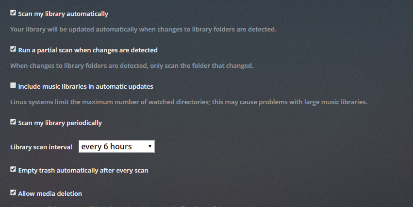

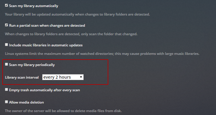

I have taken a screen shot of my settings
yeah remove check next to scan my library periodically thats likely keeping your disk 1 from sleeping....keep in mind if the disk with the media you try to access is sleeping when you try to access it plex may spit out an error if it takes too long to spin up, also make sure if you stop playing on plex you completely exit the stream or it will hold onto the file again keeping the disk from sleeping

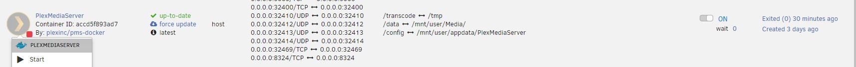

I just looked at my plex advance and i see the following
/mnt/user/appdata/PlexMediaServer
How can i change this to the cache ? And not disk1

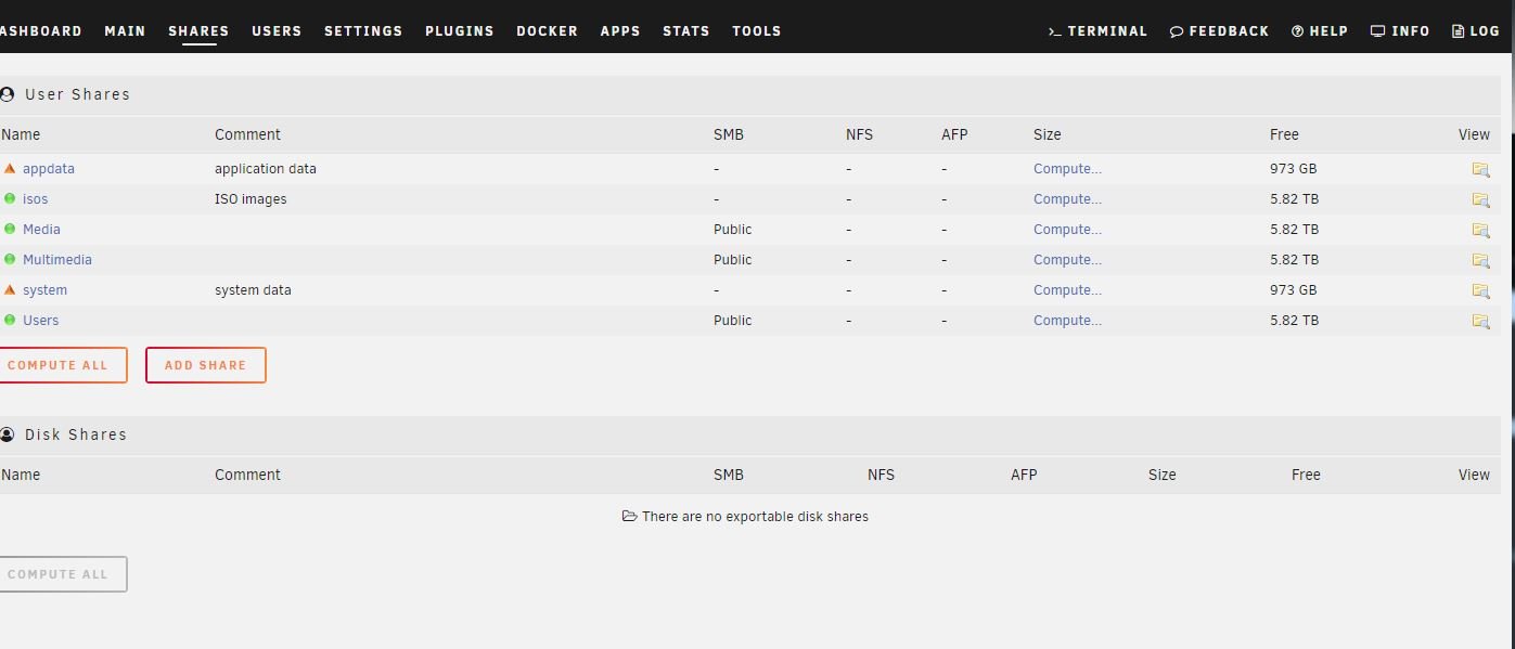

Before giving you the correct procedure, lets figure out what your situation really is in more detail.

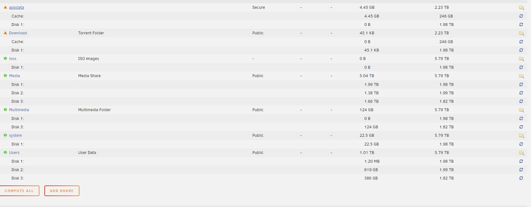

Go to Shares - User Shares and click Compute All. When it is done, post a screenshot.

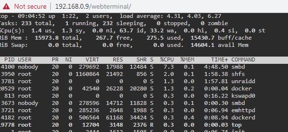

19 hours ago, Can0nfan said:
To check what’s eating your cpu
go to the built in terminal and type top and hit enter
paste the top 5 things to a reply
as requested
That's the right page but not the screenshot I wanted.
Did you click the Compute All button at the bottom of the User Shares section? After clicking Compute All it determines how much of each disk each user share is using and displays it. It will take some time to get the result.

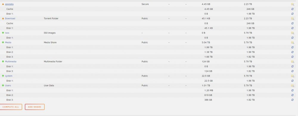

ok, I have just returned to have a look at this and I see that my Disk1 is still active, after I 15 mins.
I have check the Appdata share and the Disk1 location, and I am happy to say that the Share is set to Cache only, and the Folder on disk1 is emtpy.
the only Docker that is running at the moment is Plex.
the folders that are on the Disk1, which are not mine are appdata , isos, and system.
I also have attached a copy of my computed shares
any ideals on why my disk1 is still spinning ?
Edited by chris_netsmart
If you aren't using VMs then isos share doesn't matter and it is empty anyway. You should delete the empty appdata folder on disk1.
system share exists only on disk1, it isn't empty and that is probably where you have it set to put your docker image, which is where the actual code for each of your containers resides.
So what you are saying is that it is normal for disk1 to be spinning ? And it will only sping down when, none of the dockers are updating.
