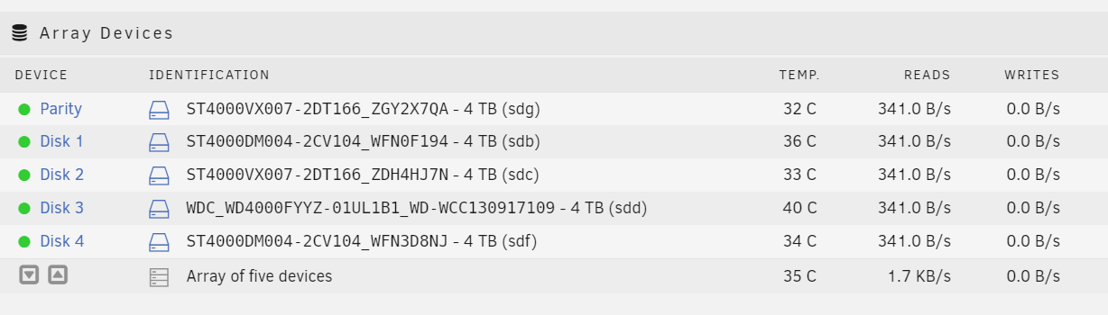

Hi there @trurl, apologies i know this is an old thread, i just have the same problem and its driving me insane. my disks are not spinning down, because some routine Read is occurring on the array and i cant find out what it is. Its on all Array disks simulatanesouly, typically around betwee 341 and 682.0 B/s. I have:
- shutdown all docker instances
- shutdown all plugins
- changed plex settings
- removed file integrity, unassigned devices, directory cache, turbo write, Dynamix SSD TRIM
- using Open Files, i cant see anything open on the array
But nothing stops the Read from occurring. Where could I go to find out what is causing this?
I am running 6.9.0-rc2
Really appreciate anyone's assistance on this. Sort of looking for a tool to assist me to find the cause.
Edited by isaacery
Diagnostics?
25 minutes ago, isaacery said:
running 6.9.0-rc2
Have you read the release thread?
Thanks @trurl. youre right, seems to be something about the SMART readings.
