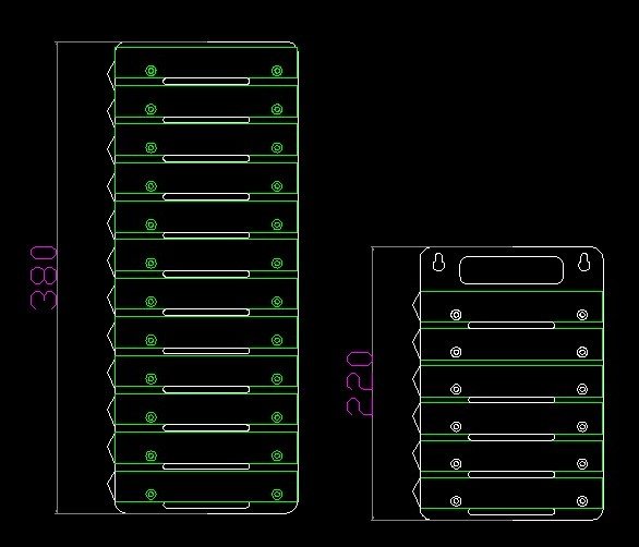

How about DIY option, my previous case was Fractal Design Define S, I put 12 drive in water-cooling area by 2 plastic, so plus 3 in back, total have 15 3.5" drive. And I build all SATA powercable too.
I don't like cages and never use.
Edited by Benson

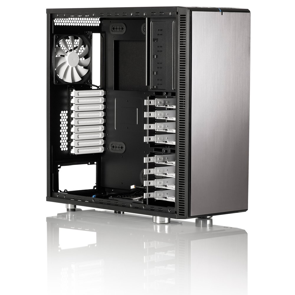

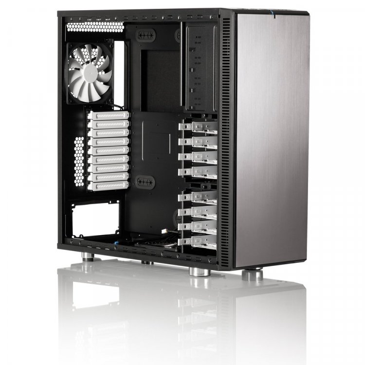

I went back and forth on a ton of options and originally settled on the Node 804 but that ended up not working out as I couldn't get proper cooling with my particular setup. After agonizing a lot more because I needed a case I could fit between rack rails and < 8u height lay on its side but didn't have the rack depth for a proper rackmount case. I ended up with the Define R6, I was originally going to go with the R5 with a 2x5.25 to 3x3.5 cage since I wanted to be able to hold 10 3.5" drives but the R6 nets the same number of hard drives (technically 2 more 2.5 SSDs) and still gives you a single 5.25 bay to do something (or nothing) with. The extra drive trays are available on Amazon for $15 for a two pack. If the hot swap capabilities aren't a big deal and it's within your budget I would recommend the R6 over the R5 because of the greater flexibility.
I'm actually in a similar situation in terms of drive numbers and trying to find a replacement case. I currently have 11 data, dual parity and want to add a cache disk for a total of 14 X 3.5" disks. I'm currently using a custom modified case (old server case very heavily modified) which supports up to about 17 disks but several of them are incredibly difficult to swap out.
I was looking at potentially the Fractal Design Define XL, though the current revision (the XL R2) supports one less disk than the original.
Edit: I just jumped to another post after writing this and found someone who built one of these with 17 disks. You can buy an extra 4-bay drive cage from FD as an optional extra. This means 12x3.5" and 4x5.25" even without getting creative for those last couple disks.
