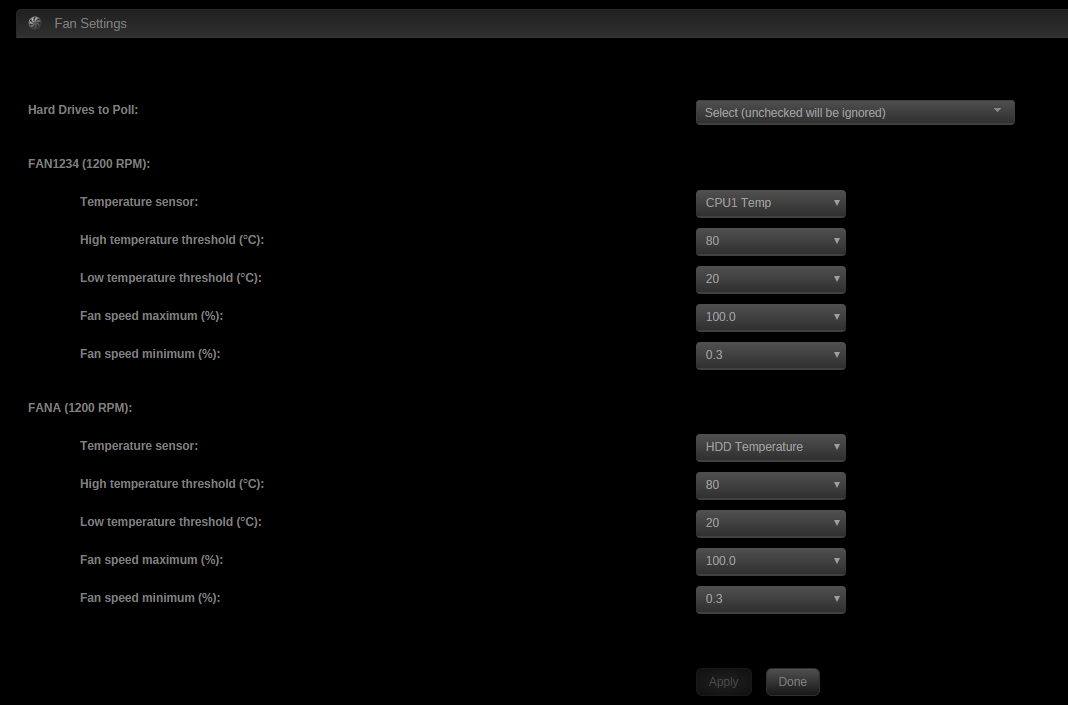

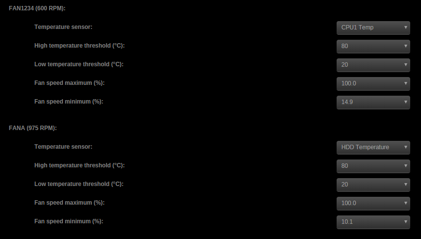

By lower threshold do you mean the fan speed minimum? If so, my minimum is set to the lowest possible (0.3) and the low temperature threshold is also set to 20C which is still lower than the system temps.

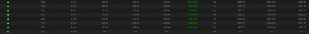

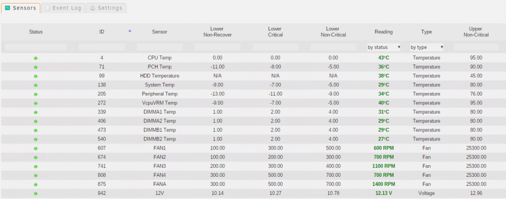

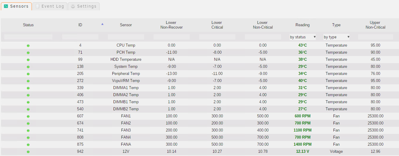

No, the BMC setting, accessible on the sensors page, lower non-recover, lower critical must be a little lower than the fans minimum speed:
Edited by johnnie.black
31 minutes ago, johnnie.black said:
No, the BMC setting, accessible on the sensors page, lower non-recover must be a little lower than the fans minimum speed:

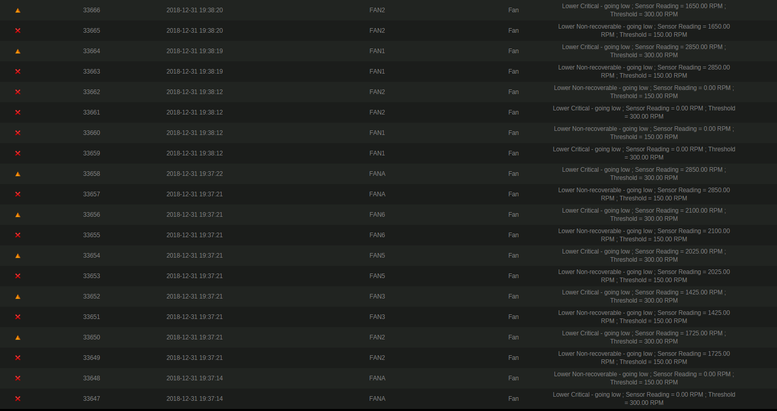

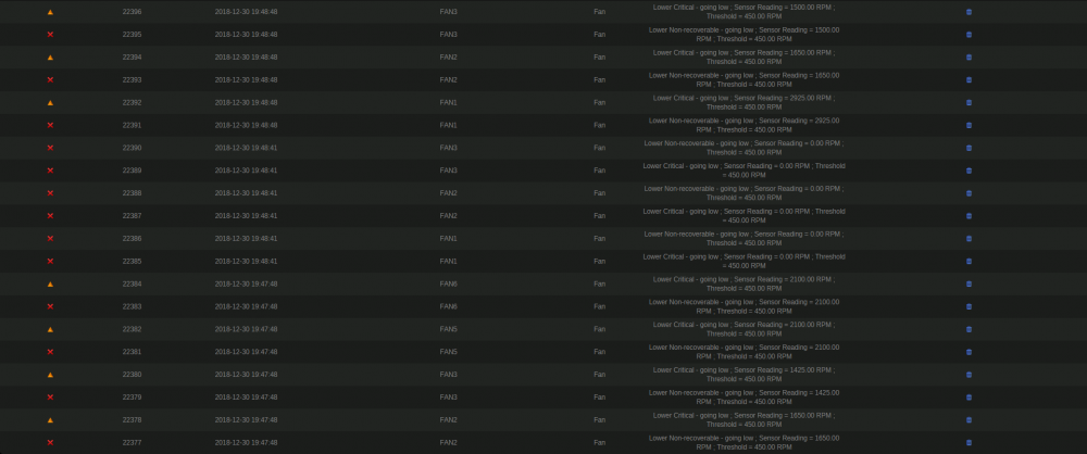

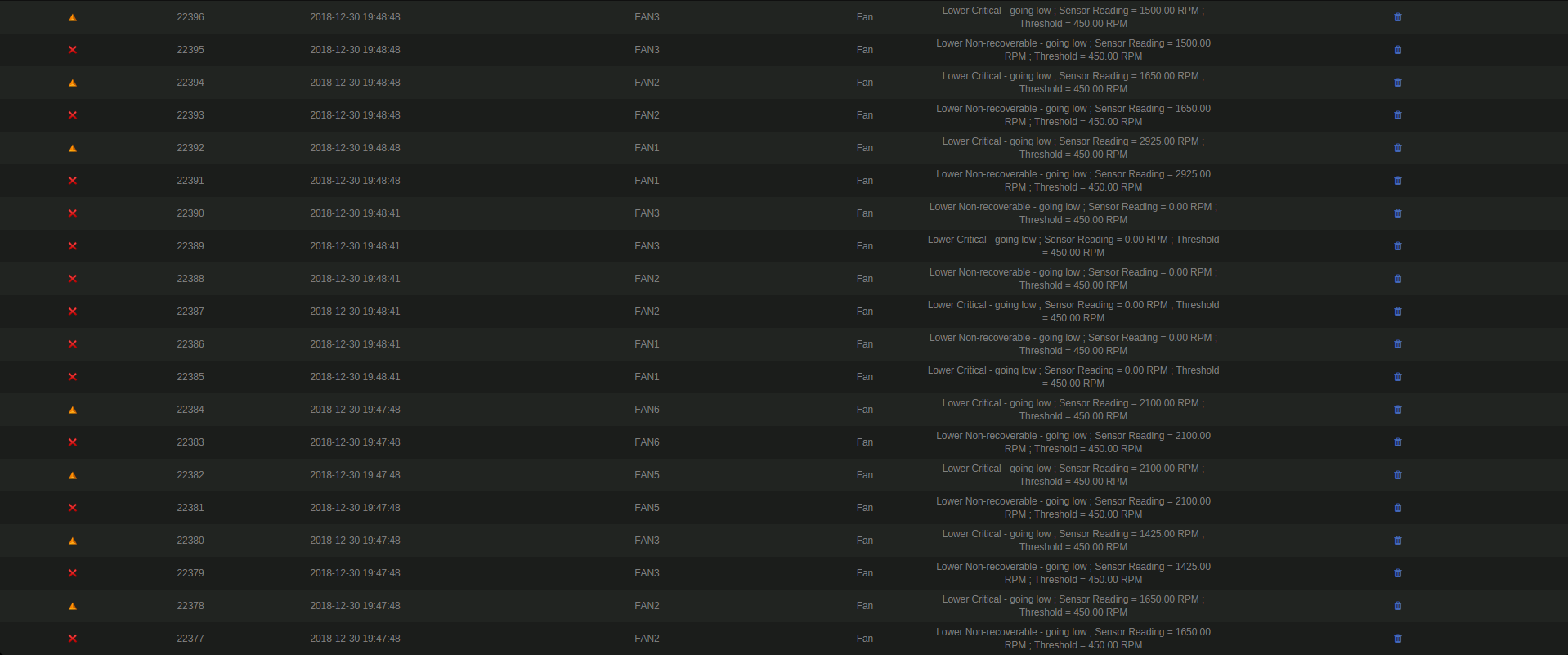

Ah I see now in the event log all my fans hitting lower non-recoverable and lower critical errors. I changed the lower non-recover to be 440 as my fans have a minimum of 450. What I don't understand is that I changed the value to be 440 and saved the value at 440 but they seem to be stuck at 450 for the lower non-recoverable.
Before I went to change any of it they were originally set to 300. And now what seems weird to me is that the event log is saying the sensor reading = (High RPM)RPM and that the threshold is 450RPM yet it is triggering the lower critical and lower non-recoverable alarms.
I also get errors saying a value cannot be encoded properly when attempting to save certain values to the thresholds such as setting 500 as the lower critical. I've tried playing around with the thresholds in an attempt to get them to change off of 450 but nothing seems to be working. Looking at the plugin thread I do see you have posted something about how they can only change in 150 increments and that seems to be my issue here. With my threshold being set at 450 or 300 should they still just be able to run at their minimum of 450? Or would they be able to not run at all since my temps are in the 20's C which is fine for me and the fans do not need to be at full speed.

Depending on the board you can only use some values, some use 150, 300, 450, etc, others use 100, 200, 300, 400, etc.
Well mine appears to not be able to use 400. Just 300/450. Does this mean I cannot get my fans to properly adjust their speed for the system temps?
You can, just set the lower thresholds to 150 and 300.

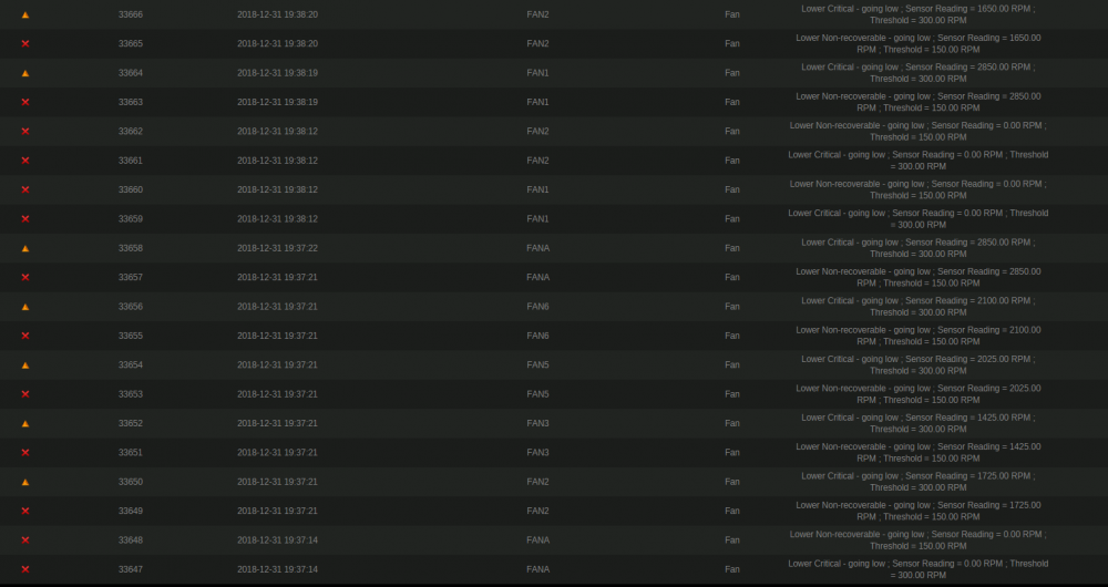

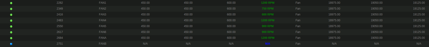

So after changing the lower 2 to 150 and 300 the fans still bounce from low to high but seem to stay high for a longer period of time (all of my temps are in the high 10's C and low 20's C).
These logs confuse me -- they say the sensor reading is 0RPM which trips the lower critical event and that makes sense to me. What doesn't make sense is when it says the sensor reading is in the 2 thousands RPM and the threshold is 150 or 300 RPM yet the event is firing off.
The higher warnings are likely after the fans speed up, the problem are the 0 rpm readings, i.e. if the fans are actually stopping, set the minimum fan speed on the plugin to an higher value.
It looks like that has done the trick. Although I had to lower my values to 0/150/300 from 150/300/600 which I believe is fine. The RPM is not as low as I'd like but it is a huge improvement from running at full speed.
