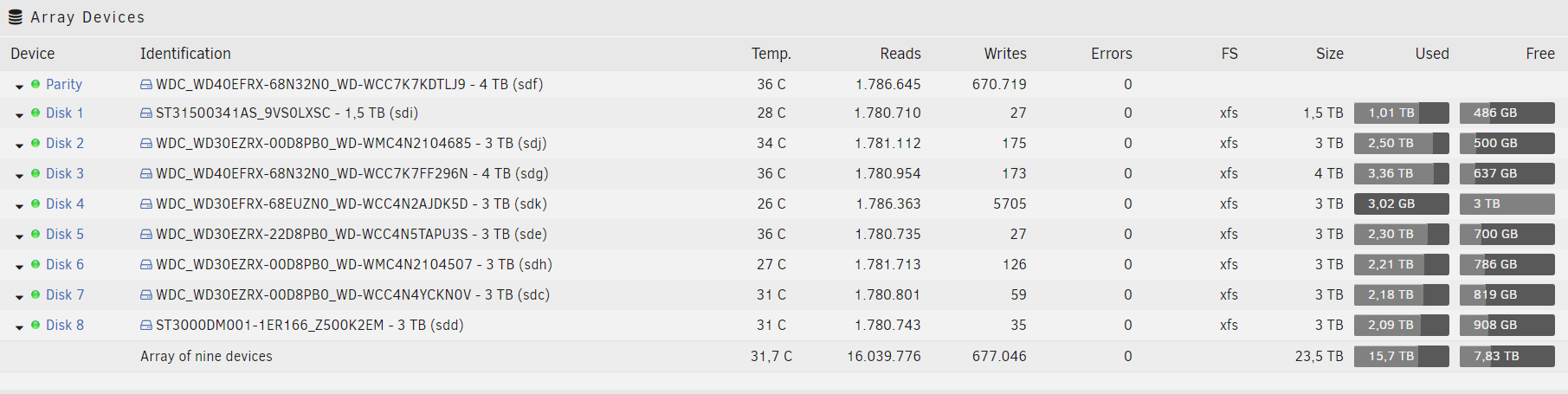

Post a screenshot of Main - Array Devices
And a new diagnostic
Disk 4 is the new HDD
Would it be possible to ensure my data is safe somehow, maybe after parity rebuild, then disconnect the parity disk (how?) and therefore use its connection for the replaced disk. Copy its data to another disk, disconnect it, reconnect the parity and rebuild.
Possible?
novanas2-diagnostics-20181231-1529.zip
So it looks like you must have told it to Format disk4, which would explain why it is empty instead of just unmountable. Not that it matters in this particular case since the rebuild was bad anyway, but for future reference, Format is never part of the rebuild process.
