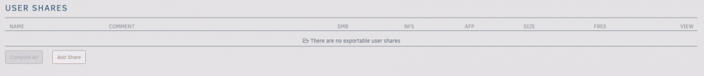

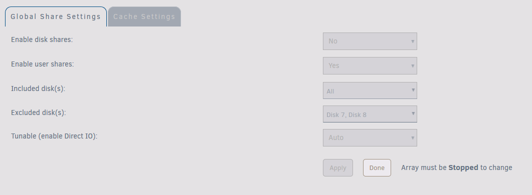

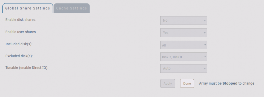

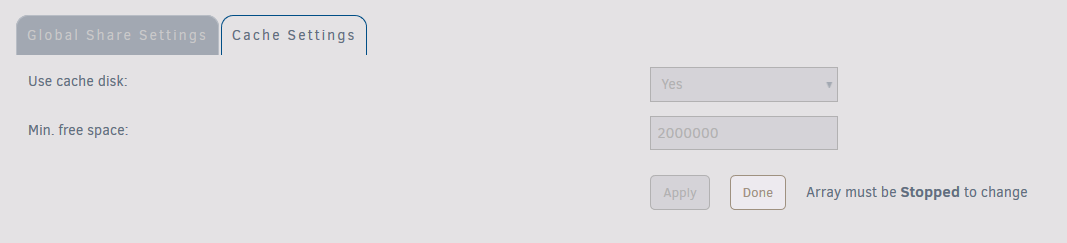

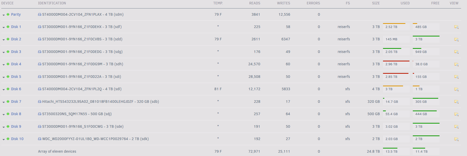

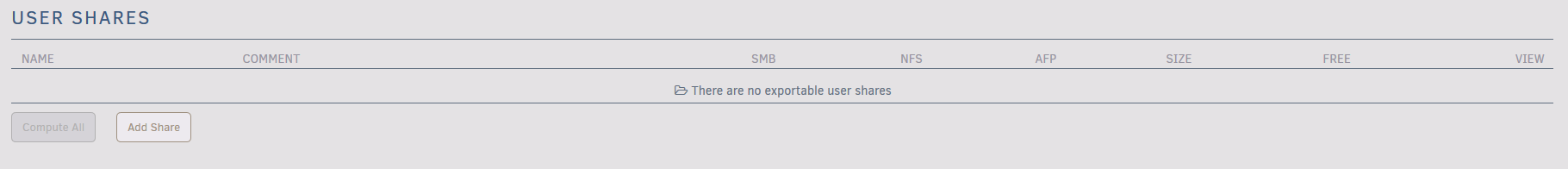

Just to make sure we are all trying to interpret the same information, let's get some screenshots:
  1. Main - Array Devices, click on the folder icon at the far right of Disk9, screenshot.
  2. Shares - User Shares, another screenshot.
  3. Settings - Global Share Settings, another screenshot.
Also post new Diagnostics.

Here you go!
