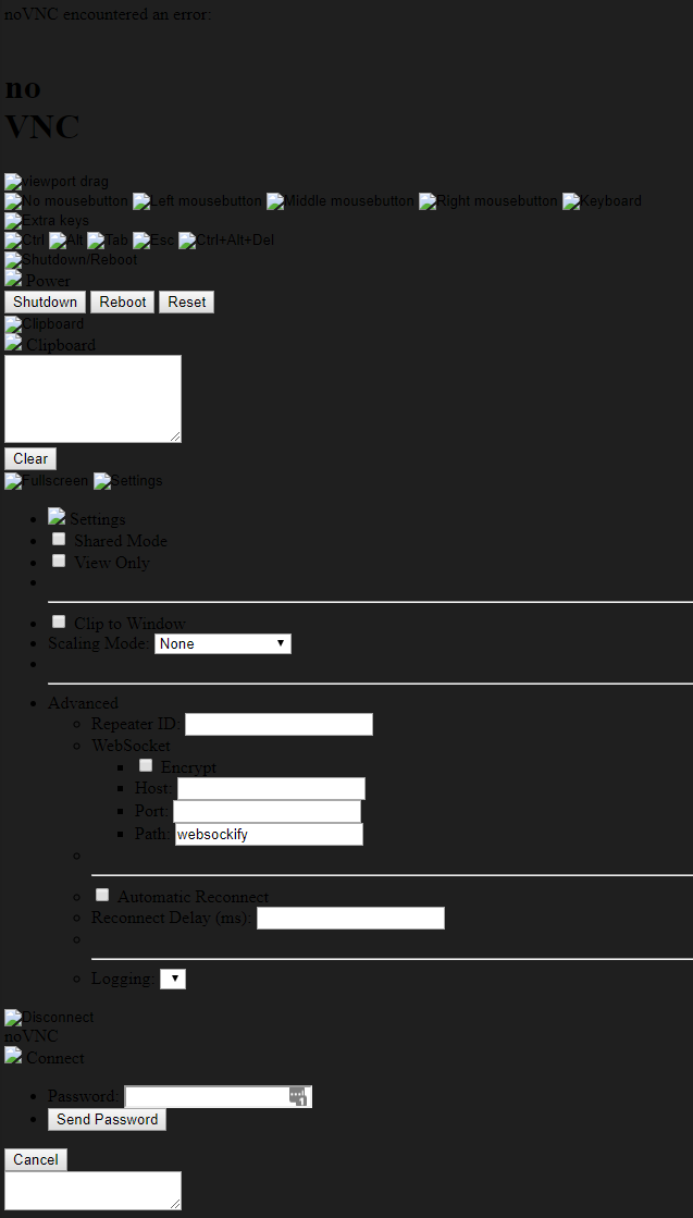

As usual for your containers, it all seems to be working swimmingly! I did want to ask though, if you had dabbled at all in adding the container to nginx and/or through organizr. I seem to be able to get to a noVNC error page once I get it added to the config files, but can't get it to the interface itself.
This is obviously stretching to the point of possible irrelevancy for this thread, but, wanted to ask, just in case!
Thanks!

with the result being that noVNC error page. It's definitely connecting to the docker image, just not connecting all the way through the noVNC portion, some nginx pass-through setting somethingorother I assume but don't pretend to understand, ha!

I got it working with letsencrypt with the following: (subdomain)
# make sure that your dns has a cname set for code-server
server {
    listen 443 ssl;
    listen [::]:443 ssl;
    server_name rider.*;
    include /config/nginx/ssl.conf;
    client_max_body_size 0;
    # enable for ldap auth, fill in ldap details in ldap.conf
    #include /config/nginx/ldap.conf;
location / {
        # enable the next two lines for http auth
        #auth_basic "Restricted";
        #auth_basic_user_file /config/nginx/.htpasswd;
        # enable the next two lines for ldap auth
        #auth_request /auth;
        #error_page 401 =200 /login;
        include /config/nginx/proxy.conf;
        resolver 127.0.0.11 valid=30s;
        set $upstream_rider binhex-rider;
        proxy_pass http://$upstream_rider:6080/vnc.html?resize=remote&autoconnect=1;
        proxy_set_header Upgrade $http_upgrade;
        proxy_set_header Connection upgrade;
set $upstream_rider binhex-rider;  =  binhex-rider is the name of the Docker cointainer
after that I had to delete cache and hard reload in Chrome and it worked.
Thanks binhex for this docker
