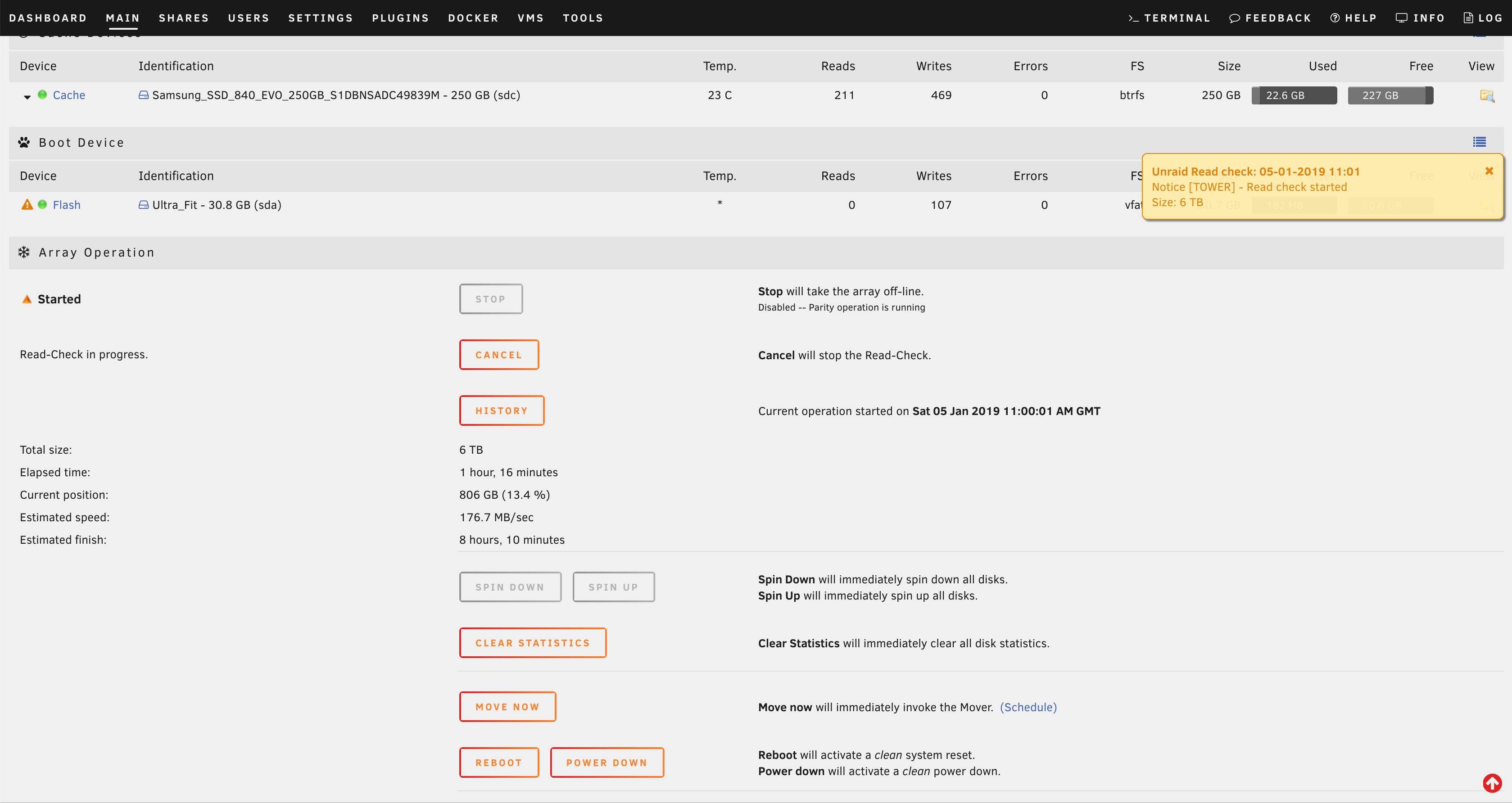

I'm not sure what it would do if you did parity check on a disabled parity disk. Did you check the box telling it to correct parity errors?
Post new diagnostics and a screenshot of Main - Array Operations just for my curiosity.
It says Read-Check in progress and no corrections so far in syslog. So I'm pretty sure it won't fix your "red cross".

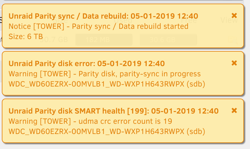

It's still warning me about the CRC errors, despite replacing the SATA cables:
If CRC errors continue to increase there's still a problem, try another SATA cable, then another SATA port and/or enclosure if you have one.
Click on the SMART warning indicator for that disk on the Dashboard and acknowledge it. 19 is the number of CRC errors in your original diagnostic so it doesn't look like they are increasing. After acknowledging that warning, it shouldn't give it again unless they increase.
