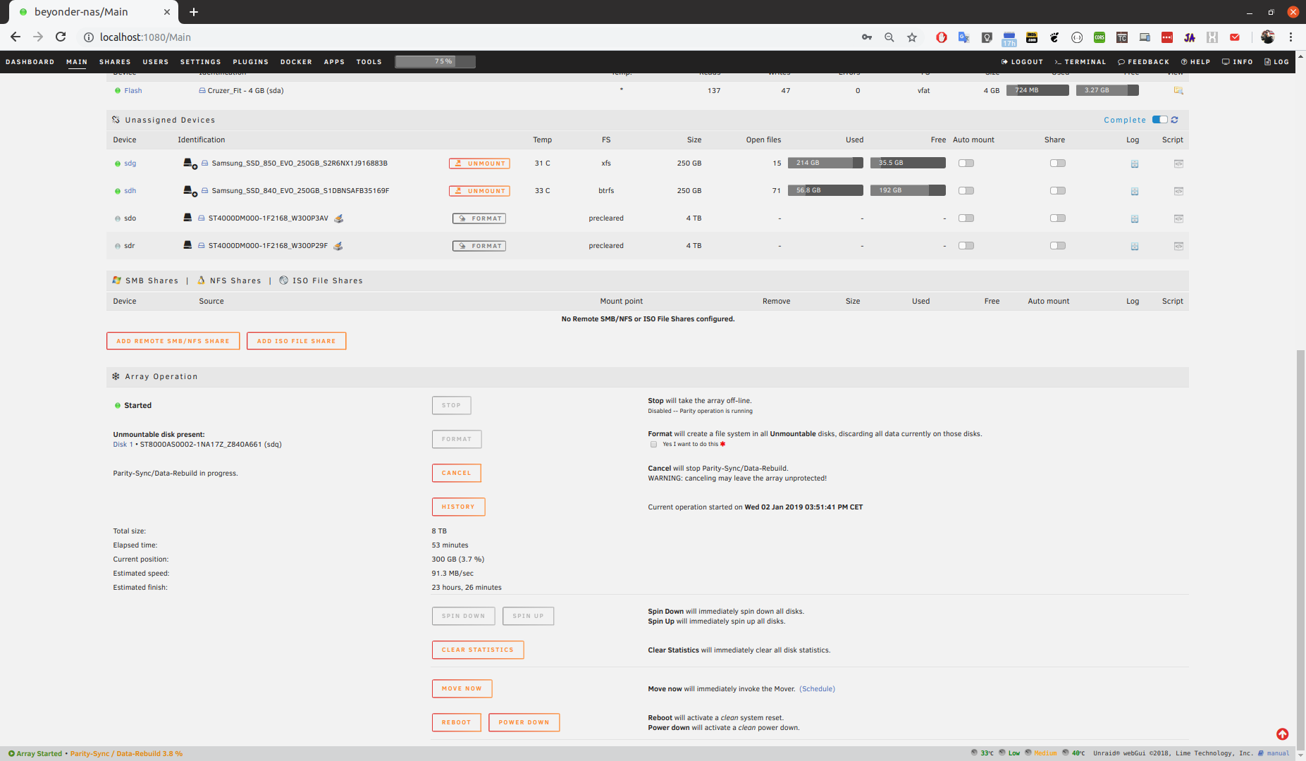

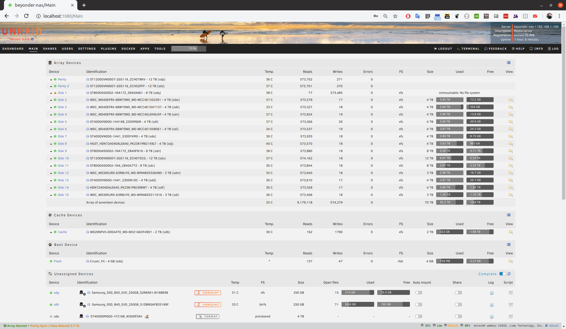

Post a screenshot of Main - Array Devices and another screenshot of Main - Array Operations.
Attached, Disk 1 is listed as "unmountable", and its also parity restoring it to I presume "unmountable".
Edited by spamalam
That makes more sense. It is emulated and it is rebuilding.
Here you can see there is a logical volume /dev/md1 (the broken one) and there is no disk1 folder in /mnt.
That seems normal. There is a device but it can't be mounted.
Just let the rebuild complete then deal with the filesystem repair afterwards.

The parity completed, the disk is 'green' but lists unmountable filesystem so I guess my parity thinks the corrupt version is correct.  When i clicked stop array I got this lovely kernel panic:

SSH has hung, but my GUI is still there but not fully rendering.
Okay, so that's bad!   Kernel panic obviously locked everything up, no ssh, running processes frozen in memory. I've issued an orderly shutdown via the remote management console, which has failed, and had to force a reset.
On restoring, I see dmesg/syslog is pretty clear of major events.  I had disabled any writes to the array (mover/parity/etc) whilst the parity check was running so in theory it should be 'fine', I also disabled auto starting the array.
So:
1. I have started the array in maintenance mode, disabling the parity check again.
2. I went to disk 1 and ran the xfs_repair -n , which yeilded the same thing I got in the first place.
