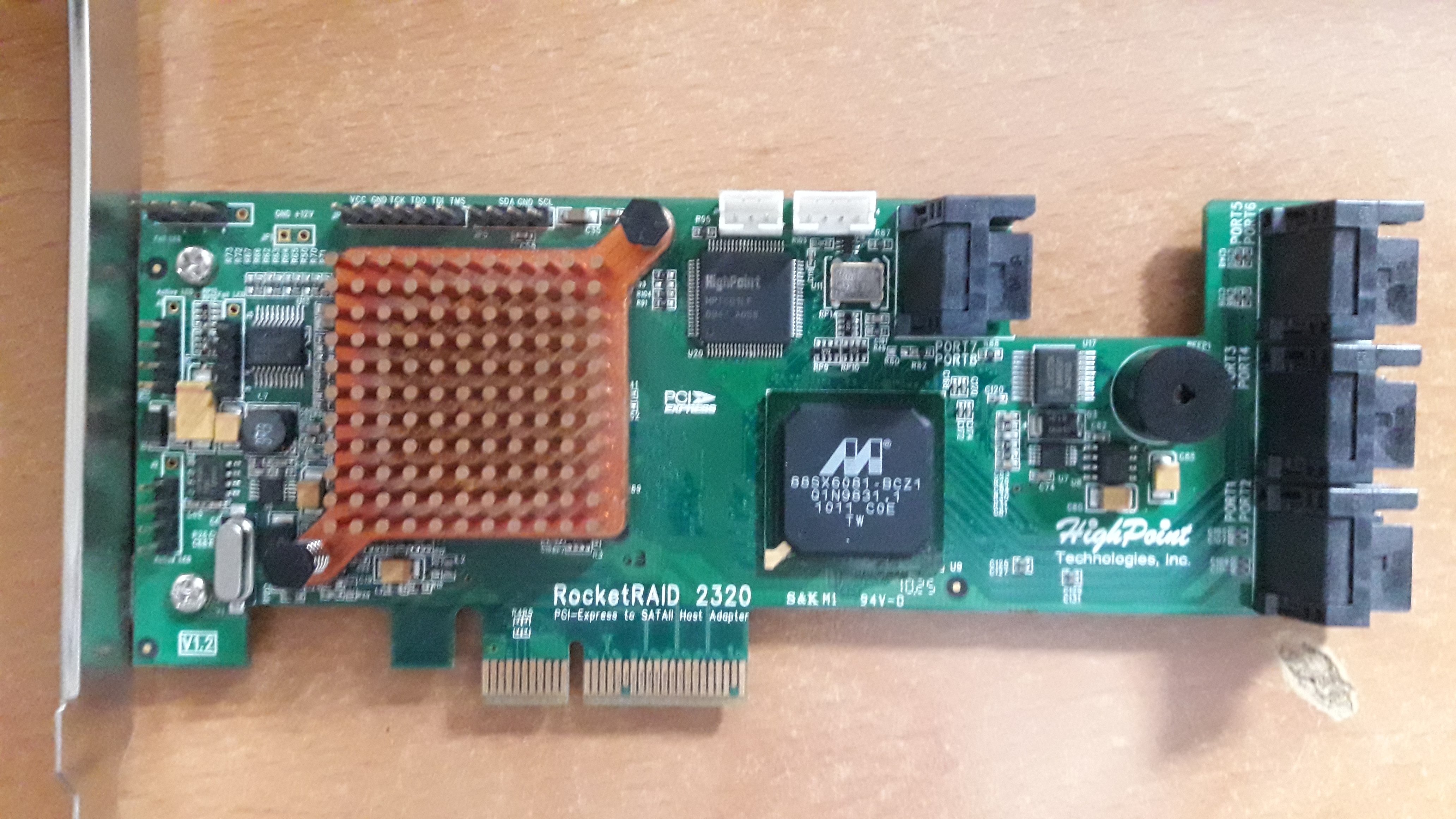

I had no clue Marvell controllers were not supported. Dame it. Time to save up for an 8 port LSI controller. So it has to be either HBA or flashed to HBA so unraid can read the drives correct. I mean i have an old High Point 8 port thats a Marvell controller so it won't work either correct.

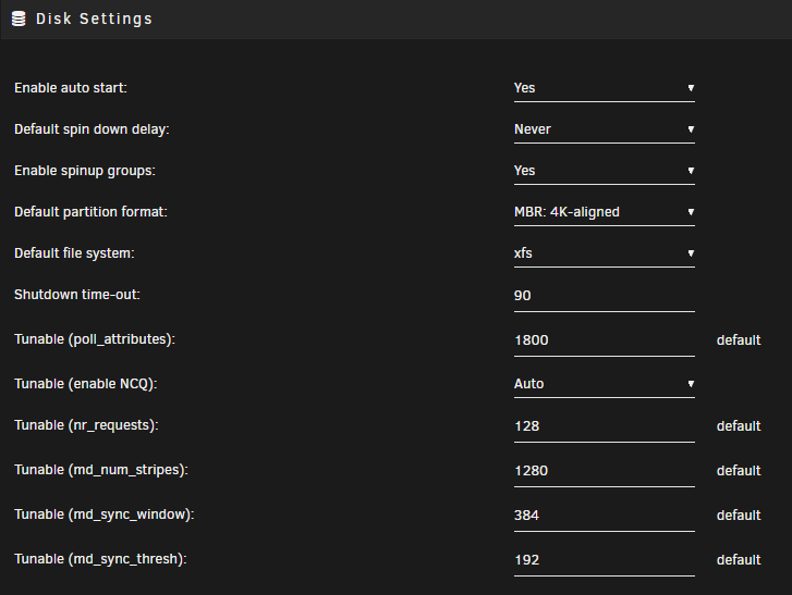

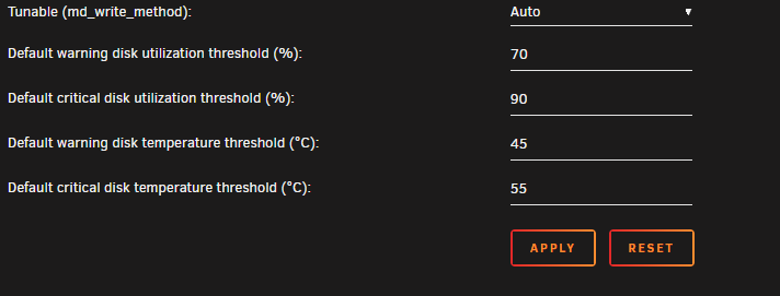

image.png.4531004d180d15e2fb18ce5a7c04db1f.pngimage.png.abe6e121eb790af205efc9823d783387.png
Those are my disk setting. You tell me if there any setting wrong that's minus for auto start Array is out of the box. Oh I don't spin the disks down either Plex has huge problems when the disks are spun down.
