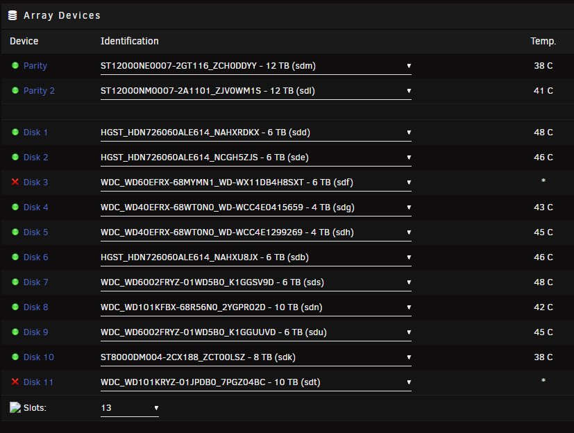

Diagnostics only show disk3 disabled. Post a screenshot of Main - Array Devices.
Diagnostics are in fact showing disk11 also disabled. But it isn't showing up in the SMART folder of diagnostics, so it must not be responding.
Check connections again. change cables, try another port, etc. If it isn't seen in the BIOS Unraid won't be able to see it either, so check there before continuing with boot.
Attached the SMART of disk 11, I rechecked connections, but it is unlikely to be cabling/connections as these disks are connected through separate cables.

Disk11
Phase 1 - find and verify superblock...
bad primary superblock - bad CRC in superblock !!!
attempting to find secondary superblock...
.found candidate secondary superblock...
verified secondary superblock...
writing modified primary superblock
        - block cache size set to 690760 entries
sb root inode value 18446744073709551615 (NULLFSINO) inconsistent with calculated value 96
resetting superblock root inode pointer to 96
sb realtime bitmap inode 18446744073709551615 (NULLFSINO) inconsistent with calculated value 97
resetting superblock realtime bitmap ino pointer to 97
sb realtime summary inode 18446744073709551615 (NULLFSINO) inconsistent with calculated value 98
resetting superblock realtime summary ino pointer to 98
Phase 2 - using internal log
        - zero log...
zero_log: head block 295183 tail block 295179
ERROR: The filesystem has valuable metadata changes in a log which needs to
be replayed.  Mount the filesystem to replay the log, and unmount it before
re-running xfs_repair.  If you are unable to mount the filesystem, then use
the -L option to destroy the log and attempt a repair.
Note that destroying the log may cause corruption -- please attempt a mount
of the filesystem before doing this.
