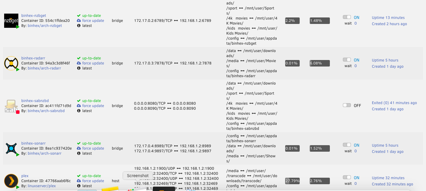

I need some help please. So over the past few weeks I upgraded to v6.6.6, learned and installed dockers, and upgraded my CPU, Mobo, and RAM to an i5-8400 to support hardware transcoding. I used to have everything running smoothly with unraid 5 on an AMD Athlon processor and Plex on a mac mini with no issues...
Dockers: sab, sonarr, radarr, nzbget
I would have stuttering and freezing on plex local direct streams even. Could not find the issue, thought it was a network switch, nope. Finally figured out that my CPU was being pegged at 100% pretty much on all 6 cores. I then pinned all the dockers (in the advanced docker menu) to 1 core, nope, still had the issue. Figured it was Sab, so I stoped Sab, learned how to use and configured nzbget. Got Nzbget going and NOPE same issue!  I even checked to pause downloads when unrarring, etc (which I didnt even have to do on an old AMD Athlon). But anyway, still having an issue.  It was freeze and buffer my plex sttreams (max of 2-3) and make it unwatchable.
I then narrowed it down to happening when the files are unpacking, however, I just had an issue where FIVE of the 6 cores were maxed out, and no unpacking was taking place! Can you guys PLEASE help me figure out what's going on, it's so frustrating and Plex is basically unusable since I upgraded from my 7+ years old AMD Athlon. I'm attaching screen shots here to show you guys. Screen shots were all pretty much around the moment this was happening. I did my best to capture. The last screen shot of system stats is from earlier in the day, not the exact time all the CPU cores were pinned. Screen shot 1 and 2 happened around the same time few seconds apart

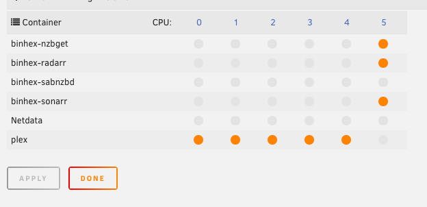

So all 6 cores were @ 100% with the apps pinned to a single core?
You should grab diagnostics when this is happening (sooner rather than later -> while its happening is ideal, but after 15 minutes it would probably be useless)
YES! All except Plex, Plex was 0, 1, 2, 3, 4
all others to core 5.
I selected that core in the docker menu after clicking on the advanced tab. Not sure if that's the right way to do it but seems about right

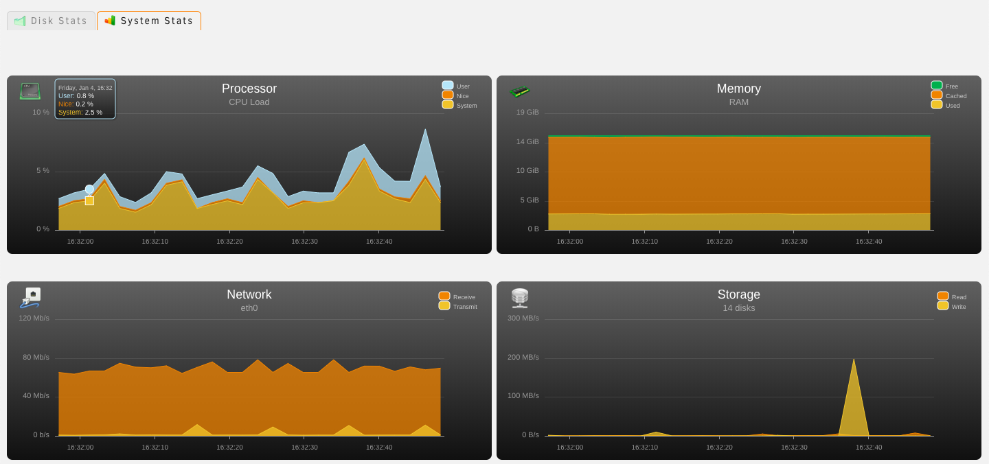

Got it, okay Im trying to figure out the issue grasping at straws I guess.  I posted a screenshot, the first one, that shows 5 cores at 100% and one at 50% :(
Screen shot was taken 31 minutes ago
Edited by maxse
Installing NetData and leaving it running in another tab would be great as you'd be able to see graphs (at least from the point you installed it)

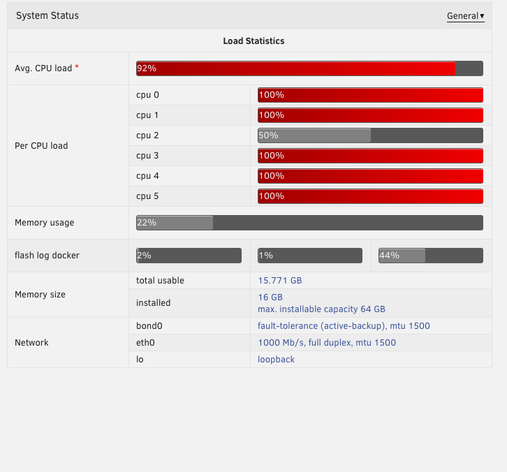

It's hard to catch that moment. Something is definitely wrong here though, right? I recently changed my downloads share for Cache-prefer to Cache only and some of the shares have a mark next to them showing that some files are unencrypted even though I have all of the drives encrypted. Not sure if this has something to do with this?
*EDIT* BOOM GOT IT. But THREE cores pinned. Everything set to use Core 5 with the exception of plex.
sabertooth-diagnostics-20190104-1813.zip
Edited by maxse
load average: 12.78, 8.63, 4.32  Cores: 6
NZBGet is doing something, and Plex is also doing its thing.  Right now, the processes are being starved for CPU (load avg of 12), and if you grabbed the diagnostics while watching the CPU utilization, it is consuming the bulk at the moment.
This isn't about the odd spike here and there.  You want to know whats going on when every core is hitting 100% and sits there.  At that point you want to grab diagnostics, or start scrolling through the various charts in NetData so you can easily see what's going on.

From your diags you are I/O bound not CPU bound.  Moving core assignments around will not remedy that.
top - 18:16:32 up 2 days, 18:02,  0 users,  load average: 12.78, 8.63, 4.32
%Cpu(s):  2.1 us,  5.3 sy,  0.0 ni, 28.7 id, 61.7 wa,  0.0 hi,  2.1 si,  0.0 st
At the time of your diagnostics you are 61.7% IO wait, 28.7% CPU idle.  The I/O wait is why your load is 12.78.  Everything that reads/writes from the disks will stall while it waits a turn in the I/O queue.
