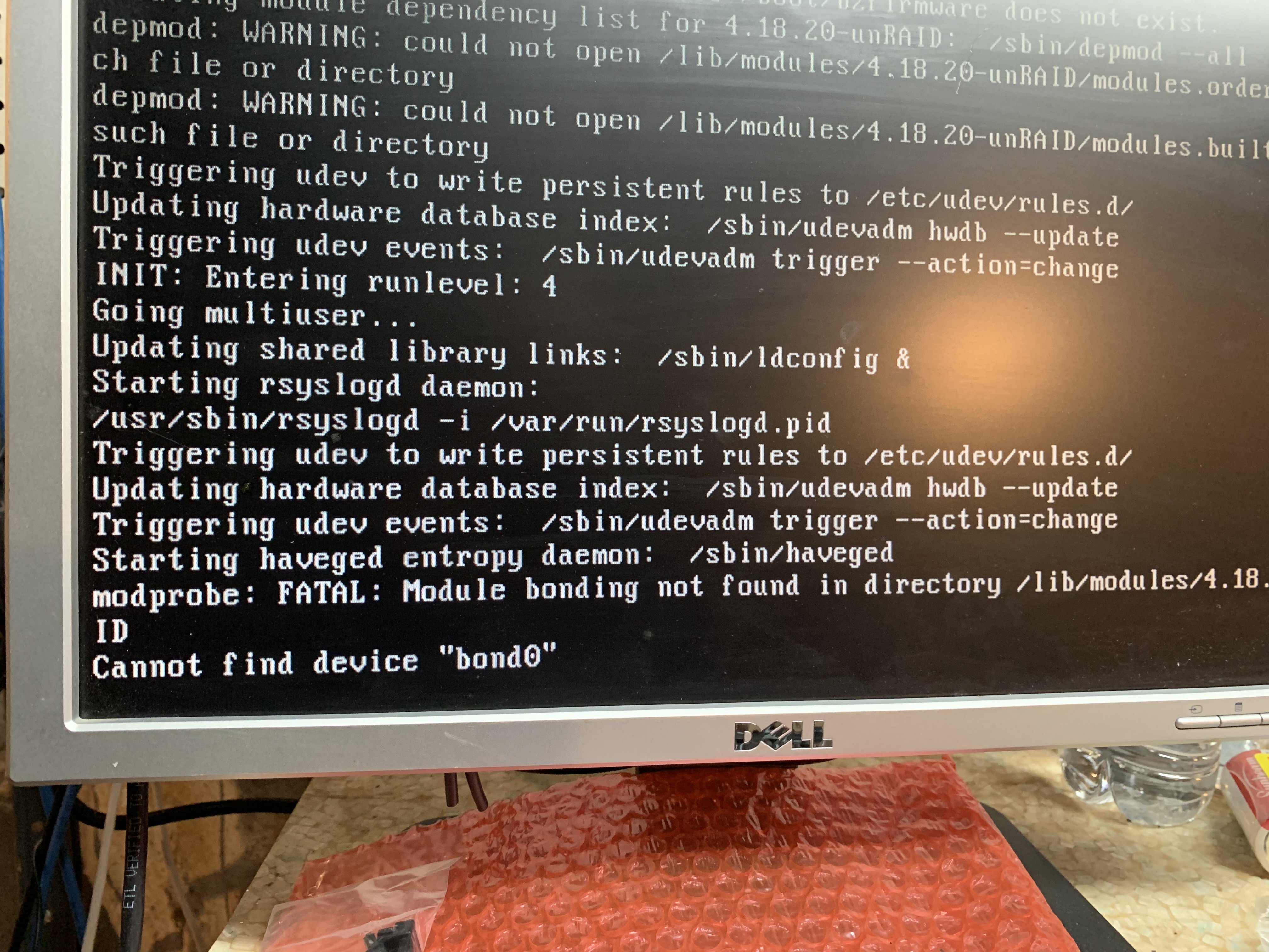

Replaced motherboard with same one and now unraid won’t give ip
Hey guys so everything was working just fine until motherboard died, I put exact same one and plugged it all back up and now I raid won’t give me an IP address. “Cannot find bond0” pretty sure it’s not supposed to say that.

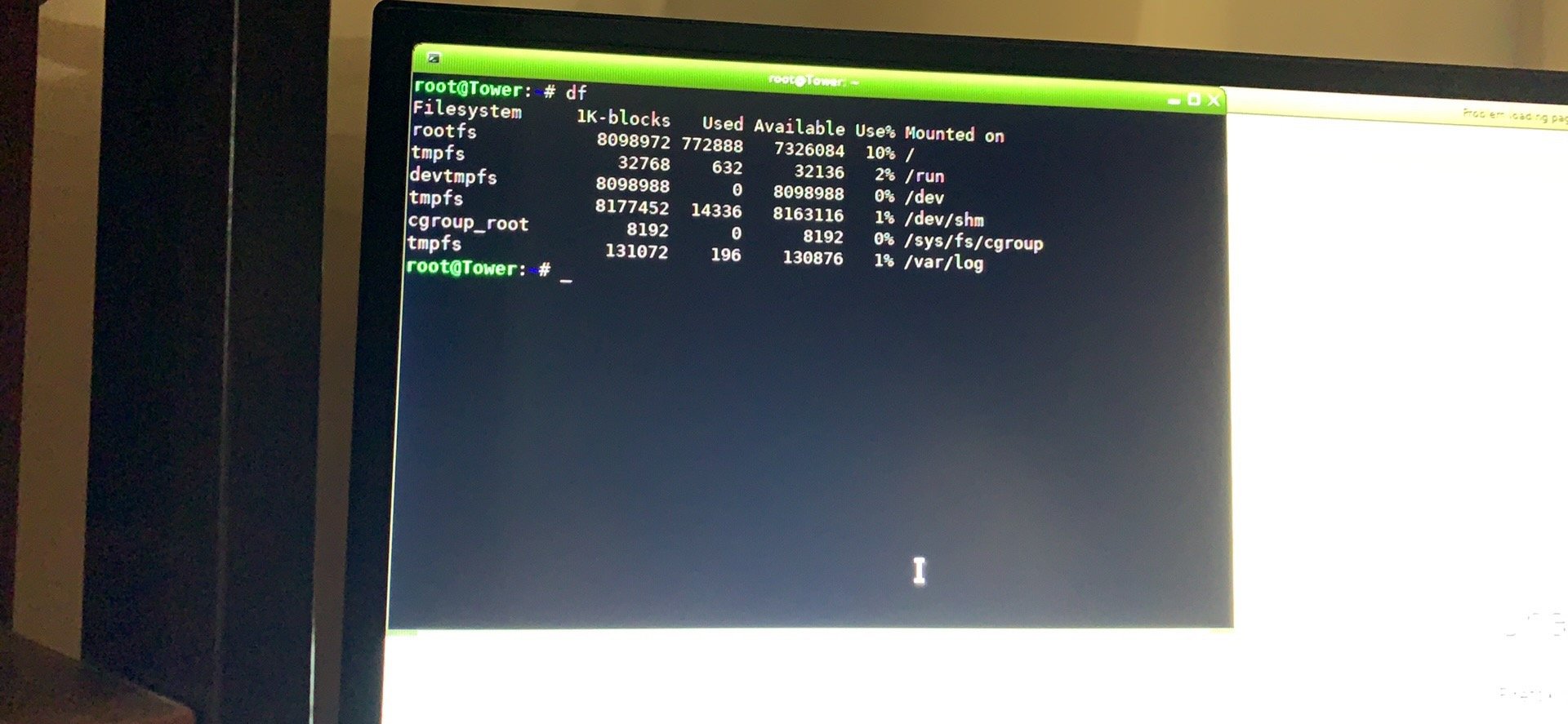

I think the usb stick isn’t being mounted properly. I don’t know what any of this means but here’s df from terminal
Make sure that your flash drive is plugged into a USB2 (black plastic insert) rather than a USB3 post (blue plastic insert).
Yea it is, there isn’t any usb 3 on this motherboard
Yes, the USB stick is not being mounted correctly.    If it was there would have been an entry for /boot.
it will be worth trying different USB ports in case the one you are using is mis-behaving in some way.     Alternatively it could be a problem with the flash drive.    It might be worth plugging it into a Windows system to check it is OK.
