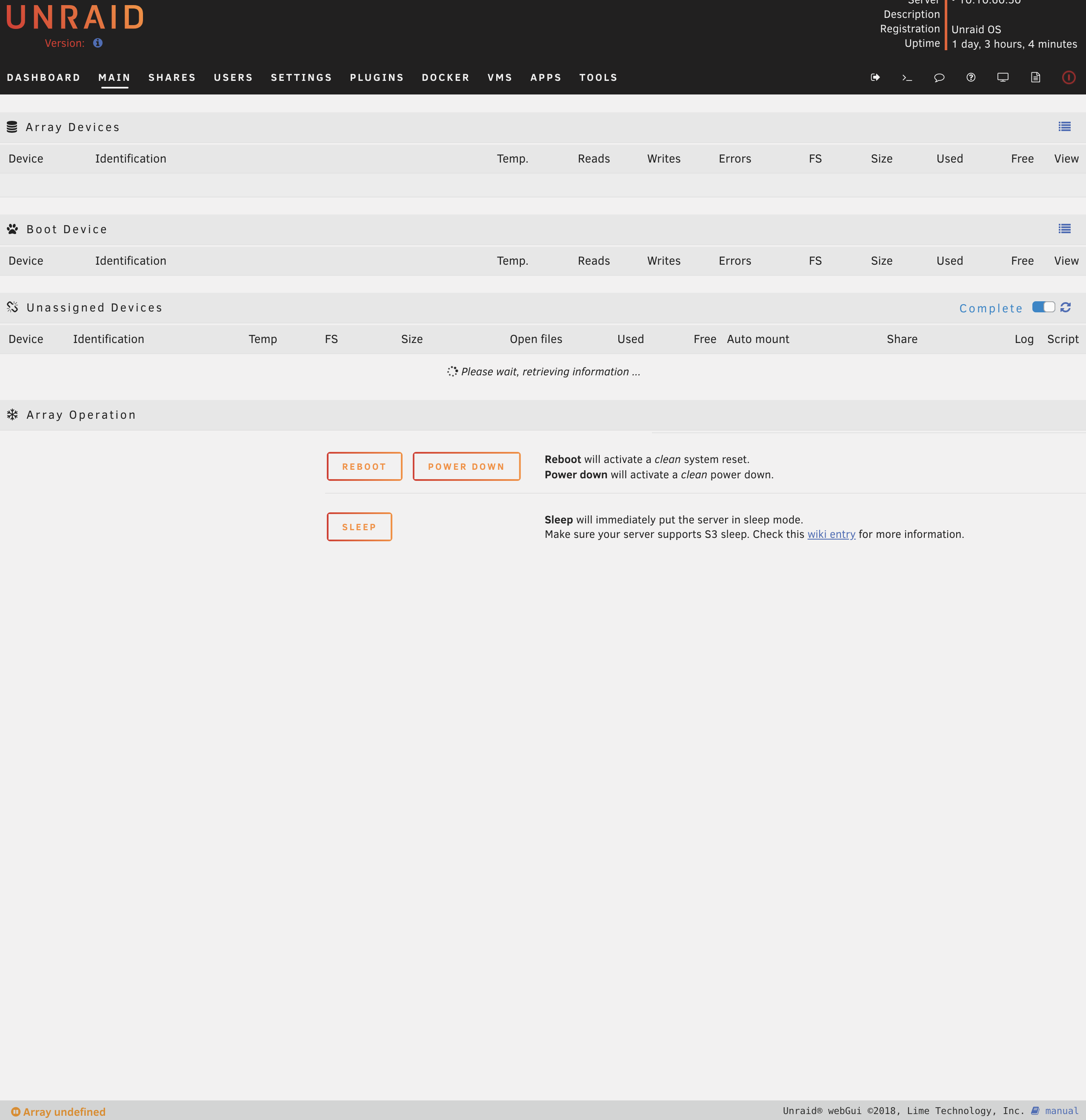

I upgraded to 6.6.6 and started having problems.  First, it did not come up on reboot.  So I dirty shut down and powered on.  It started rebuilding the array.  Then it froze.  I had to reboot, clean this time, and the name of my unraid box changed back to Tower.  Somehow I figured that out and logged in.  The array was fine.  Until today.  I get the following when looking at my main page.  What is going on?  I've had some issues where unraid failed in the past.  I replaced the USB stick, and it seemed to have fixed the problem.  I'd venture to guess that this couldn't be the case twice.  Also it's not the same as before.  It's starting fine and then doing this.  What can I do?
Mark
Probably your flash has disconnected. Try another USB port, preferably USB2
Right now it’s in a usb2 port. It happened in both a usb3 and usb2 port.  Could this be an issue with the motherboard? Or is it possible I have another lemon isb stick?
Go to Tools - Diagnostics and attach the complete diagnostics zip file to your next post.
