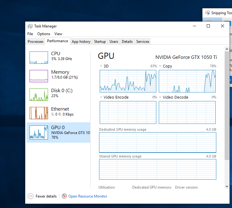

In Task Manager, System and Desktop Window Manager processes just smash the GPU at 100% for both 3D and Copy.
I hope we can figure out what the problem is, I would hate to have to build a second box for unraid and convert this one to bare metal :(

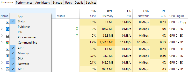

Do you know what process is causing the GPU load?  I ran a gtx 1050ti on my VM for quite a while before selling it when I parted out my gaming rig and replacing it with my 1080 and didn't have problems like that.  I had a 1030 for a while that did have issues with that just due to how weak of a card it was.  If you turn on the GPU and GPU Engine categories in your process list you should be able to see what's eating your GPU:

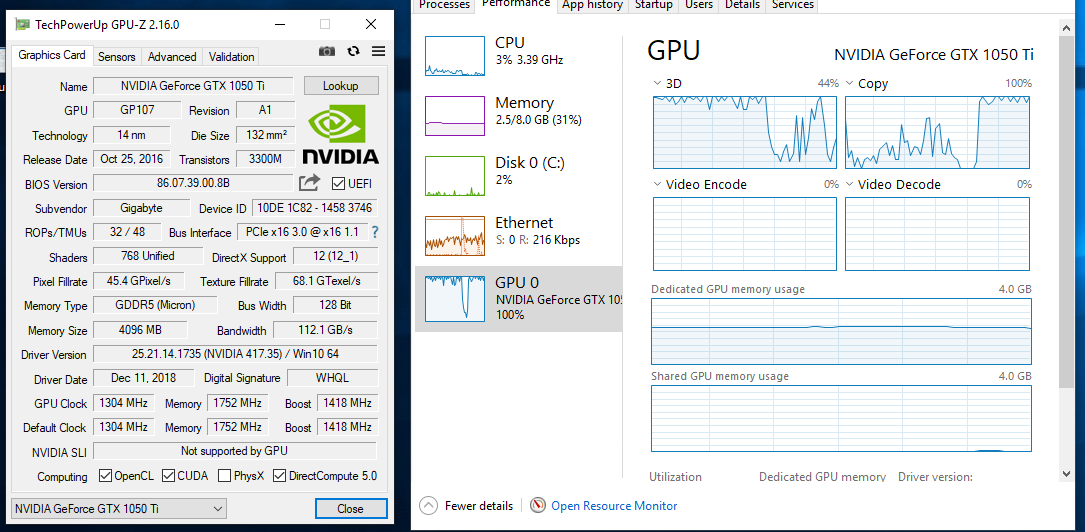

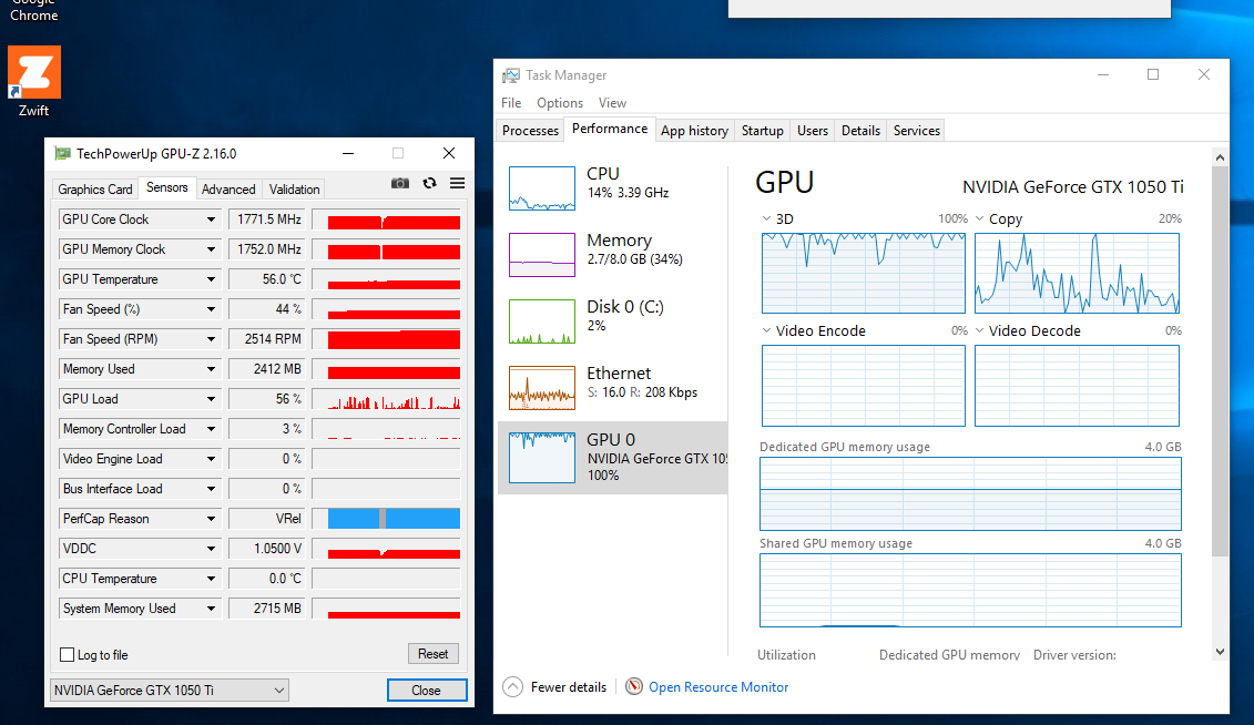

I really haven't seen much in the way of "Poor GPU Performance" in the time that I've been working with my Unraid VM.  The GPU tends to work if you get it passed through unless its overheating and throttling although your GPU-Z screen shows its running pretty normally.
