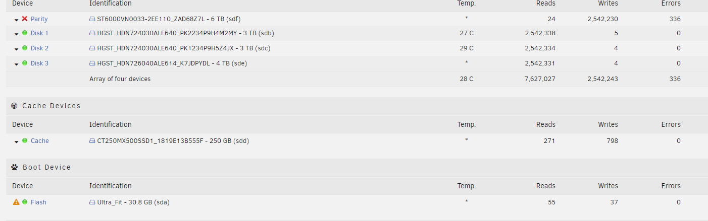

My parity now refuses to sync with one of my Hdds in particular. I have tried swapping sata cables and booting the server up without the drive which causes the issue but when i add it back in my parity hits the 25% mark and begins failing after about 300 errors found on this drive. What information can i provide that can help diagnose the issue.

You should never use the Marvell controller, the first 4 white SATA ports, they are a known problem on those boards and keep dropping disks, use any of the other 10 Intel ports and your troubles will be over.

Oh crap, thanks, I did not read that. I will switch them to the blue ports and post an update.

Not the using the Marvell controller, so resync should go fine now, though it hadn't started yet on the diags you posted.
Currently 3% further than any previous attempt. ~8 hours left
Alrighty, so that totally worked just fine. Thank you Johnnie.Black for the grate insight.
