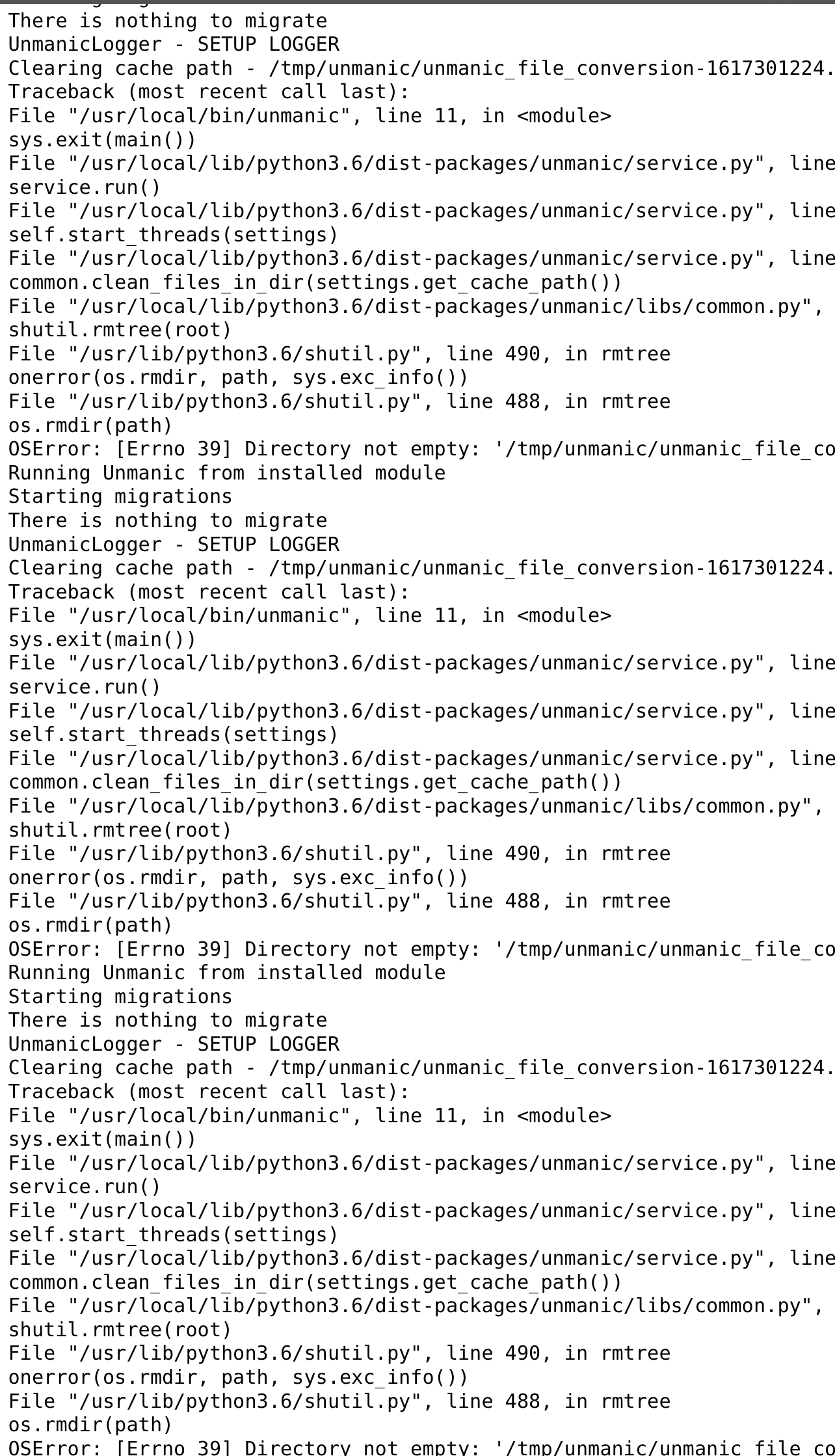

Many thanks Josh. I’ve managed to now install but still loosing access to the UI soon as it starts encoding.
log attached.
log attached.
This error is likely because of issues with the permissions of you cache directory. Can you make sure the cache path is `chmod -R a+rw ...`

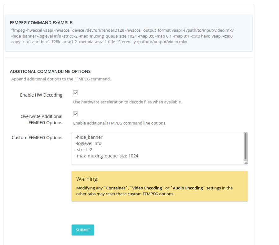

I don't know much about ffmepg commands.  By much, I mean nothing at all.  How do I increase -max_muxing_queue_size from whatever it's defaulted too in unmanic to something like 1024?  Every once in a while I have a few files that fail and everything I google says to increase the mux queue size to at least 1024.  I see the example for the ffmepg under the advance tab... but I don't want to change anything else in my settings (like output file location, etc...) I'm scared I'll mess something up.
This attached image show exactly what you want to do.
See how adding these have overwritten the additional options.
The "Custom FFMPEG Options" input does not overwrite all of the other Unmanic settings.
Appreciate it, sir.

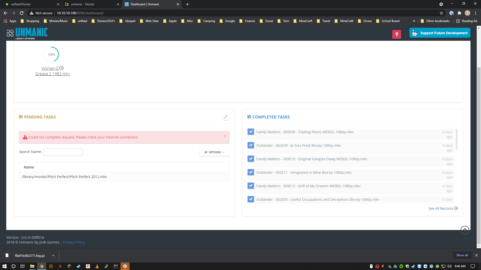

Tried running version 0.0.3+2bff016 this morning with Nvidia Driver v465.19.01 and v460.39. The first file it finds stops at about the mid-40% status and I get the following error in the screen shot and I lose the unManic GUI. The error says check internet connection but that's not the case..
f8a91e3b2271.log.gz
