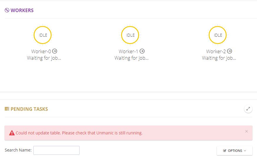

On 5/5/2021 at 1:26 AM, Sebastiaan99 said:
My Unmanic keeps crashing since the last time I boot my server, I tried to restart multiple times. Also reinstalled multiple times. But nothing work. It works after a reinstall until it get the first jobs. I attached my logs, I hope somebody can help me
Are you able to get the docker logs also? I had a quick look and it looks like Unmanic has encountered some exception that it could not handle. I'll take a closer look tonight since you sent me the DB also, I may be able to reproduce the issue...

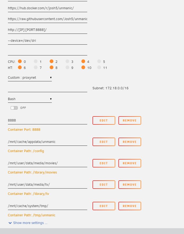

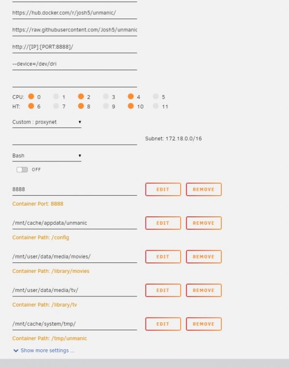

On 5/5/2021 at 2:08 AM, bclinton said:
Unmanic has ran great until the last few days. I keep getting can't reach page then it will pop up and load and then give me can't reach page again. I renamed the settings.json and the unmanic.db file and started back up with no change. Any suggestion of what I can try next? I am running Version - 0.0.4+d103d6c
Some additional info. I noticed that my space used in the container seems very high. My docker img file is set to 50gigs and the unmanic container seems to be hitting that mark. I have some very large mkv movies files pending to encode. Is that causing my issue? I have my tmp folder set to use another folder on the cache drive which is a 2TB ssd. In the docker screen I can see the space used go up to a point and then start over again. It repeats this so I assume it is hitting a space limit.
/config/mnt/cache/appdata/unmanic
/library/movies/mnt/user/data/media/movies/
/library/tv/mnt/user/data/media/tv/
/tmp/unmanic/mnt/cache/system/tmp/8.41%
40.51GiB / 46.93GiB        <-------------------- filling up my docker img allocated space? I have the mapping setup correctly but it doesnt look like unmanic used the space correctly for the tmp folder /tmp/unmanic------>/mnt/plex_data/tmp/
On a side note....I see folks saying the changed the build version of unmanic. Where do I do that at in unraid?
Could you please provide some screenshots of your setup? Specifically the docker template config and the settings in the Unmanic webui.
Thanks

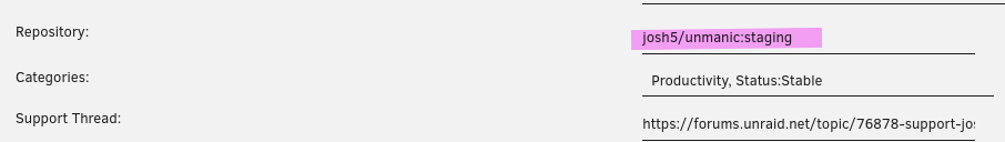

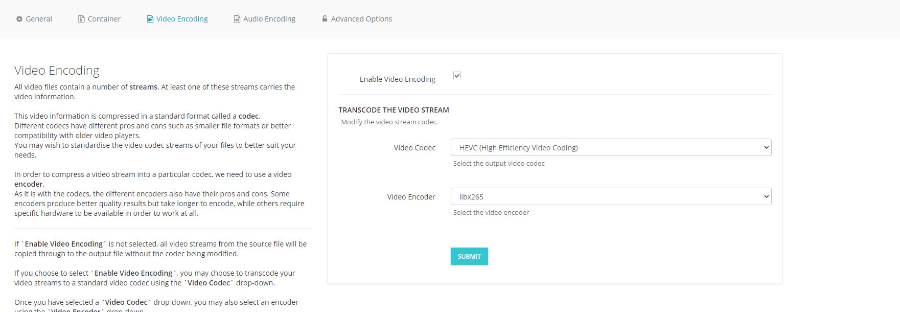

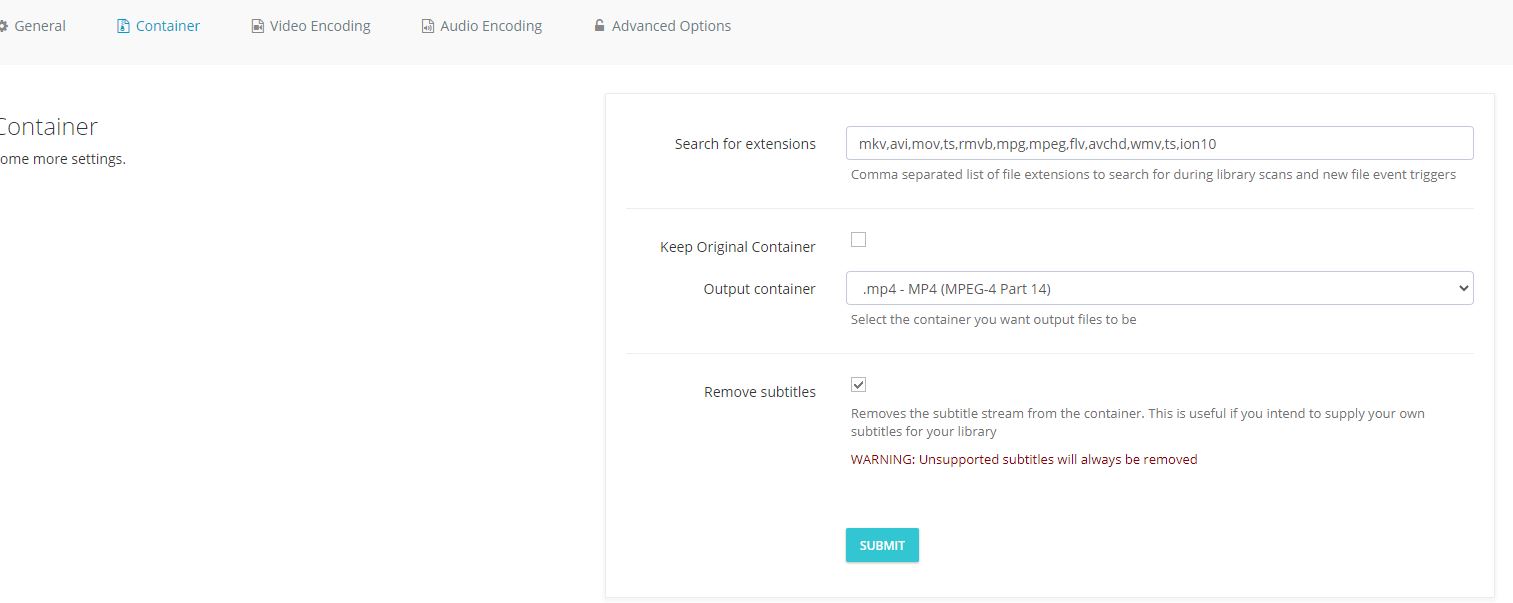

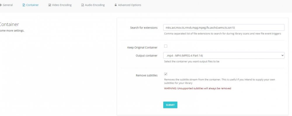

Here are my settings. I was unable to bring up the WEBUI but just changed to the staging branch and it comes up now. It started encoding a file and got to about 3-4% and gave the error (could not update table.... - shown below) I am thinking at this point I could try blowing away the container and starting over with the staging branch......what do you think? The only thing that changed from working great to having these issues was me adding about 25 videos to my movie share and some of them were quite large (25 gigs).
3.thumb.JPG.09dcd8f16b2bd5354f09b3b2b4d6a3bb.JPG2.thumb.JPG.a68d7bf0364cf4e810a7cd5ac16ee818.JPG1.thumb.JPG.94d12ccd2f6eab15a8d87d54aa306003.JPG4.thumb.JPG.3c0065f853e4437b20ee55a56a9f2de0.JPG3.thumb.JPG.09dcd8f16b2bd5354f09b3b2b4d6a3bb.JPG2.thumb.JPG.a68d7bf0364cf4e810a7cd5ac16ee818.JPG1.thumb.JPG.94d12ccd2f6eab15a8d87d54aa306003.JPGCapture.thumb.JPG.5432c0e9a16e0964ff433899b0d1f932.JPG3.thumb.JPG.09dcd8f16b2bd5354f09b3b2b4d6a3bb.JPG2.thumb.JPG.a68d7bf0364cf4e810a7cd5ac16ee818.JPG1.thumb.JPG.94d12ccd2f6eab15a8d87d54aa306003.JPG2.thumb.JPG.a68d7bf0364cf4e810a7cd5ac16ee818.JPG3.thumb.JPG.09dcd8f16b2bd5354f09b3b2b4d6a3bb.JPG4.thumb.JPG.3c0065f853e4437b20ee55a56a9f2de0.JPG6.JPG.f393fb8537af4814563d29197d0f1f1e.JPGCapture.thumb.JPG.5432c0e9a16e0964ff433899b0d1f932.JPG
Edited by bclinton

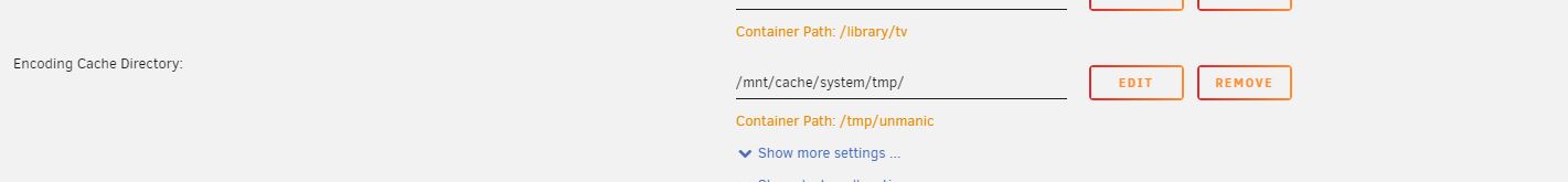

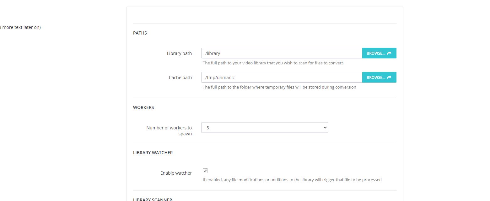

Could you please explain this part further?
Are you using a symlink to connect 2 "tmp" directories?
No, I have the unmanic tmp path pointing to a tmp folder in the system share. It did not look to me like unmanic was using the tmp folder that I assigned as it was queing up videos to transcode. It was filling up the 50 gig docker file instead of using the tmp folder that I assigned and once it hit that limit it froze and I was unable to open the Web UI.

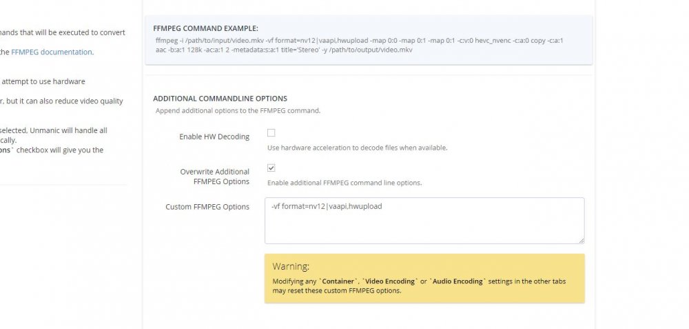

Hey, I know you mentioned before that this feature will be coming in a future update.  I'm in no way trying to rush you or pester you about... merely curious how far down it is on your priority list.
Feature:  Adjust the quality, bit depth, CRF, etc of the transcode.  Handbrake really gives me a lot of in depth options in regards to video transcode settings.
On that note, if I have HDR x264 10 bit movies... will unmanic leave it as HDR and 10 bit, but simply transcode it to my container (in this case it's mkv) and make it x265... leaving the rest as is... IE HDR x264 10 Bit mkv file turns into HDR x265 10 bit mkv file?  How does unmanic like Dolby Vision, HDR10, HDR10+ content?

Not trying to bug you to death but figured the updates might help.....I updates the docker container this morning (staging) and now am unable to get to the webui......looking at the container in unraid advanced mode it once again is filling up the docker img space and starting over - it does this over and over and in the meantime I am unable to load the webui......I assume it is queing up the videos it finds in the initial scan and that is causing the docker img file to max out (it is set to 50 gigs)
Can you try setting the docker config of the tmp/unmanic volume to another location on your array. Just so we can test if it does the same thing.
I configured it to the tmp path on a totally different nmve drive. Same results. I am going to attach a mp4 file to show what is happening. On a side note....if I am the only one that this is happening to I have no problem blowing away my config and starting fresh. The video was too large to upload.
Yea. I think it's worth making a backup of your Unmanic config folder and start fresh to see if that helps.
If you like, I can give you more help over a chat on Discord. We could probably solve the issue there in a short voice call.
