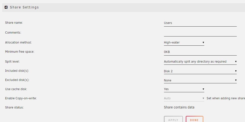

here is a screen shot of one of my shares
I really recommend you not name a User Share "Users". It is going to be a very good opportunity for typos as you continue to use and configure your server, since there are many places where the word "user" will appear in paths.
