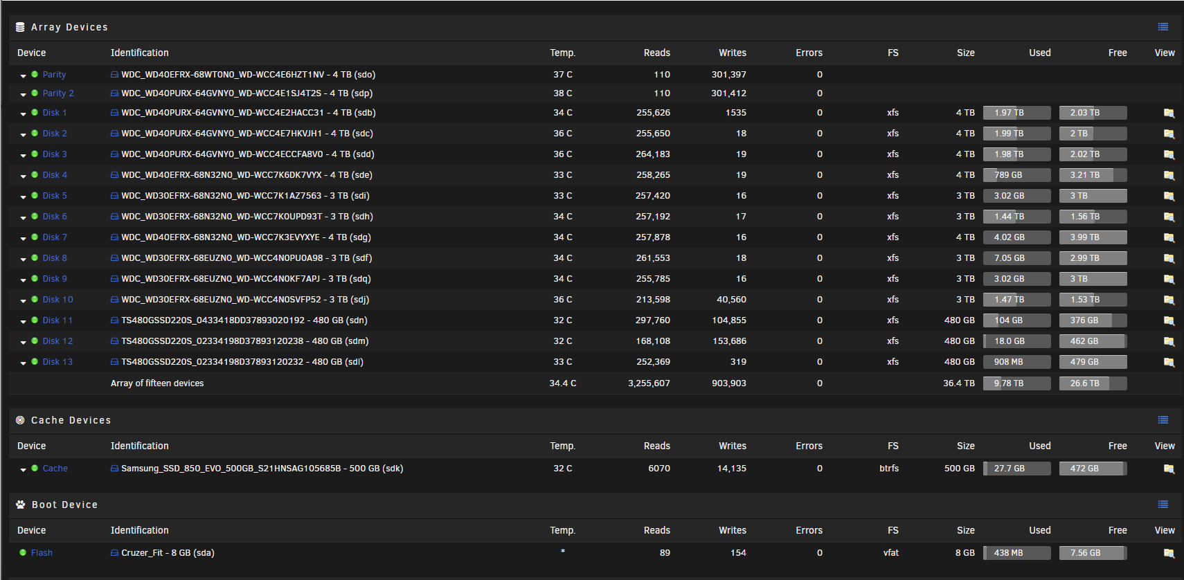

Maybe if you describe your array more fully we could make more useful suggestions.
Is this sufficient or do you need terminal output? I apologize but I am not very fluent in Linux so I would have to figure out the commands to show the array in terminal.
My VMs are on Disks 11 and 12.
