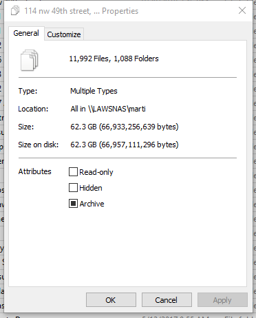

Now the problem I am running into is Windows 10 workstation is not showing the files and folder size correctly after they have copied.
Properties original location size and files.
Properties location on unRAID after robocopy from Windows 10 work station.

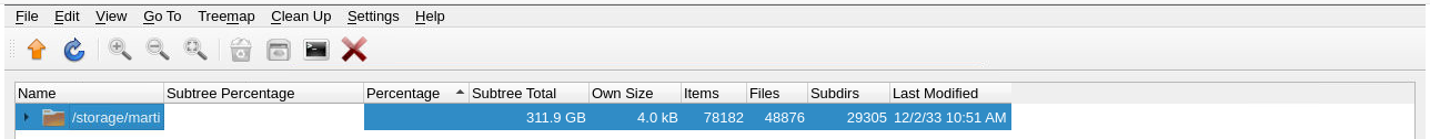

Checking QDirStat It shows all the files and folders are on unRAID.

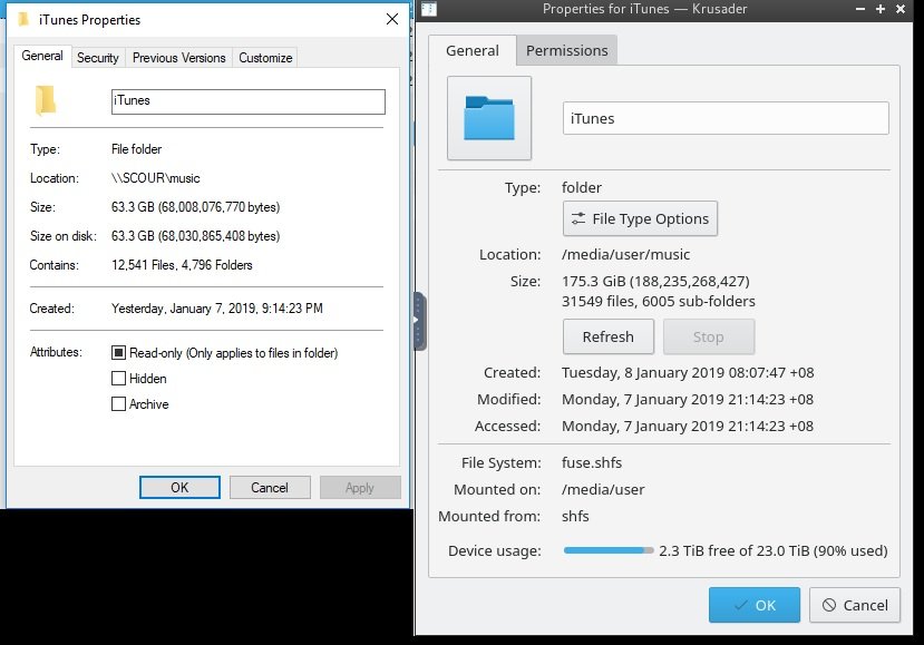

For a fresh copy of a directory, cache disabled for this share, the folder/file size is vastly different when reported by windows vs krusader docker.
Try running the new permissions tool on that specific share and check again. Until you are showing the same number of files comparing size is meaningless.

I think it's a Windows issue because Windows is reporting 2 different counts (network vs local).  The krusader and windows local count agree.  It's only the windows network count that differs.  Either way, I agree something is very strange.  Looking in the forums, it seems several people are having the same issue.

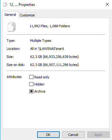

Please see attached 2 different computers same network share.
Windows 10 Workstation
Windows 2012 Server

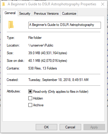

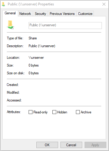

If I get Properties for one of my Unraid shares (sharename Public) on my Unraid server (servername unserver), I get this:
But when I get Properties for a subfolder in one of those shares I get this:
So, no information for the share itself, but correct information (verified with WizTree) for a subfolder.

Since the title of each window says "12, ... Properties", what you are doing is highlighting multiple folders and then getting the properties of those folders
I would surmise / guess that your view options are different between the 2 computers, and the same number of folders are not being selected (ie: Some are hidden / tagged as being a system folder, etc on one of the machines.)
Ensure the view options on both machines are identical
